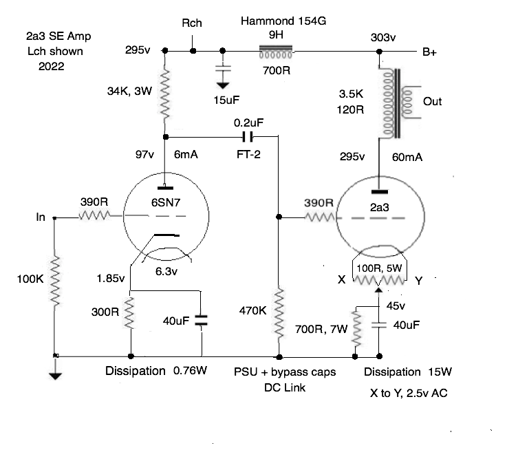

Are you saying you want to build a 2 stage amplifier, 6SN7 into 6V6 outputs? That's perfectly feasible. I just posted my circuit for 6SN7 into 2a3 in another thread and I've added it here. I can use 6SN7 or two single triodes like 6J5 variants. I used to like the 7193 but I'm getting better sound with the CV6 aka CV1135, VR-135. Also 2 top caps but beware - the grid and anode top caps are the other way round from the 7193. Using 2 octal sockets opens up some nice possibilities like 6P5G/GT plus there are some nice 6J5 versions like the round anodes. You might even want to use 56 or 76 if you see any, or even go with the loctals and use 7A4.
Are you using the 6V6 in triode or what? Are you considering any kind of feedback? As a fan of the 2a3 I'd suggest that as the output tube if that takes your fancy.
