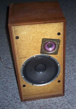

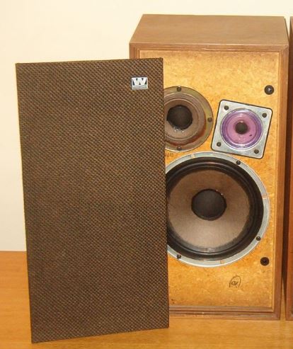

Here's a couple of variations on the Wharfedale Linton theme around the 1970's. That cone tweeter in a little plastic stuffed enclosure about the size of a coffee cup. Lowish second order 1.2kHz crossover on the two-way, IIRC. Simplistic stuff on the three-way too. But it worked.
Wharfedale were not the only game in town at this time. People liked Mordaunt Short Pageant and Carnival with 2nd/3rd order filters too. My own efforts are more on those lines these days. That's an Isophon KK10 mylar dome tweeter in the Pageant if my eyes don't deceive me. It was a popular candidate for modification by Chartwell speakers and had a nice sound. The Carnival looks a bit like that old Peerless cone tweeter, but it could be a SEAS.

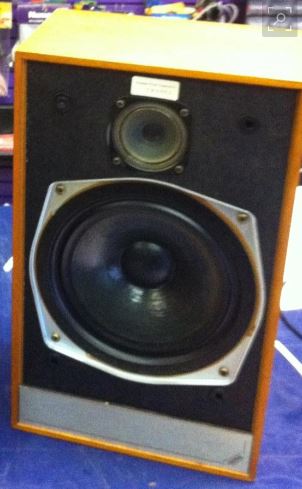

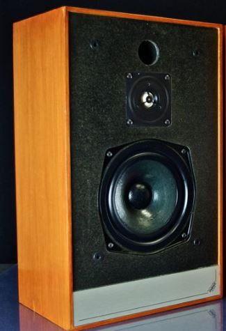

FWIW, my comment about the horizontal placement of the B139 ABR on the 104 is not intended for the ABR itself but for it defines the width of the front baffle and affects the B200 and T27.
As far as I know, a narrow front baffle is a good thing and if the ABR was rotated 90 degrees, a design like the Calinda and Carlton III would be reached.

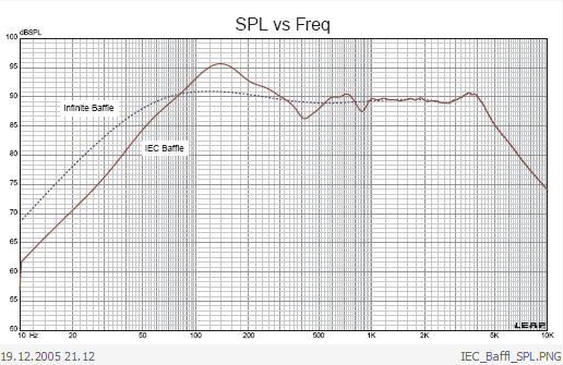

It's interesting to compare the SFB to your classic IEC measuring baffle. We all should, of course, understand room acoustics. The box and the room are interchangeable to a certain extent. What more is there to say? I'd rather talk about drivers.
