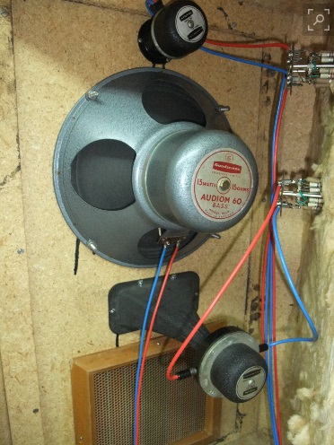

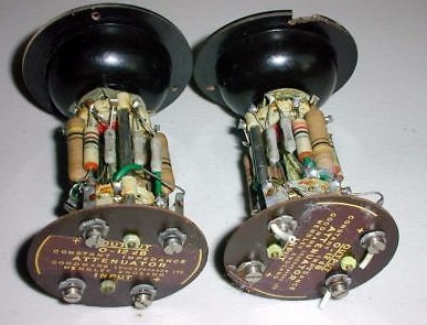

The two best selling popular brands in the post-war period were probably Wharfedale and Goodmans. Lot to like with both. I happened to grow up listening to Goodmans, illustrated below for people who don't know what they were like. But I bought Wharfedales. I think Briggs understood the wife approval factor, aka WAF. 😀
