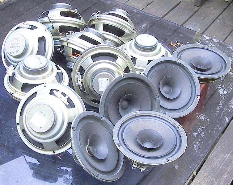

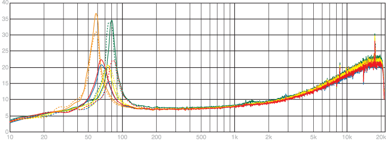

Did measures on the 1st 10 similar drivers out of the drawer.... tossing outliers the avaerage Fs = 74.3, Qt = 1.41 (using fresh FuzzMeasure beta so results have yet to be manually confirmed).
I'll get to the others so i can view the entire sample... then i need to figure out what the best pair is for the baffle size i have.
dave

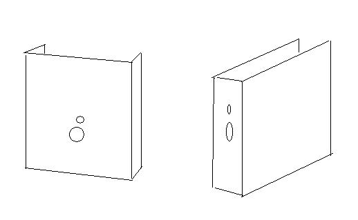

They will perform quite diffrently. The narrow one will have at least a couple pronounced resonances based on the length & width of the wings... it iwill also have a baffle step. The 2 qill have different radiation patterns. In a shoot-out i'd bet on the wide one.
