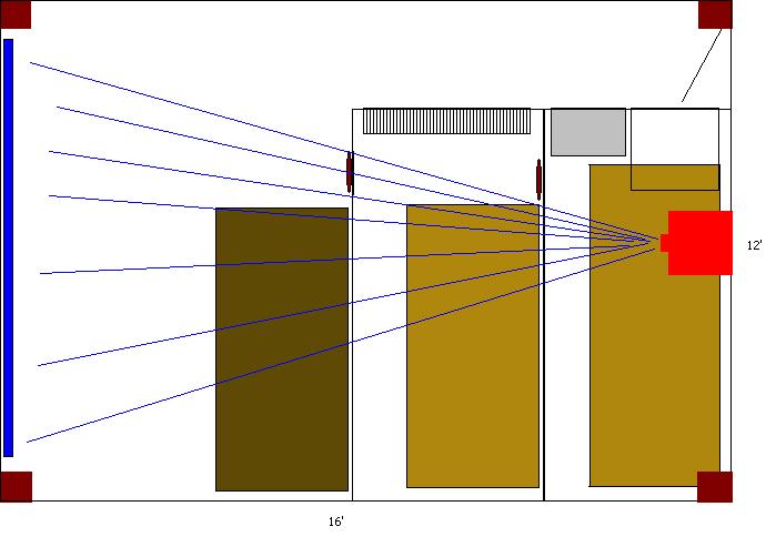

to give a good idea....heres the room (minus the projector parts)

is an 80" out of a 16' run? or is 80" as big as I'll get it without looking like crap from any distance?

not really 16 foot throw!
Unless you plan to make a hole through the wall to mount your projector in the room next door, you won't be getting a 16 foot throw distance. If you use a design where the light travels up through the LCD and then is folded by a front surface mirror before it hits the lens, then you could probably get around a 14 foot throw distance.
With a 14' throw, 7" LCD, and a 300 mm focal length lens, you would get a 92.6" diagonal image. Here are some other possibilities:
290 mm lens => 96" image
255 mm lens => 110" image
235 mm lens => 120" image
Personally, I would recommend the 300 mm fl lens, because this is the most common size for DIY projectors (a legacy from overhead projectors), and it is so easy to get matching fresnels.
Keep in mind that the screen brightness falls at the square of the diagonal size, so a 92.6" image is 68% brighter than a 120" image using the same projector. (Even with the 92.6" image, I would go for a 400 Watt lamp. 250 Watt lamps need a very dark room to look good at this size.)
As for the maximum size, I think the 7" Lilliput is 800 by 480 pixels? That is way more then standard TV, so any source with lower resolution than HDTV should look great. (If you can see the screendoor, then you are sitting way too close!)
BTW: Don't buy a bunch of parts before you do the math. You do need a field fresnel (the second one) that somewhat matches your projection lens. (A 330 mm fl is a perfect match for a 300 mm lens, 14' throw, in a split design.)
throw distance
Throw distance by itself, has almost no effect at all on the brightness! (Unless you and your buddies are all smoking cigars in your home theatre. 😀 )
But with a particular lens and LCD size, the throw distance determines the screen image size. THAT spreads all the available light over the image area, so THAT determines the brightness.
To make that a bit clearer: If you use a particular lens to give you a 100" diagonal image from 10 feet, and then use a different lens to give you a 100" diagonal image from 30 feet, both images would have the same brightness.
For image sizes from 17', you can just multiply those sizes I gave you by 17/14. So a 300 mm lens would give you a 112.4" image.
