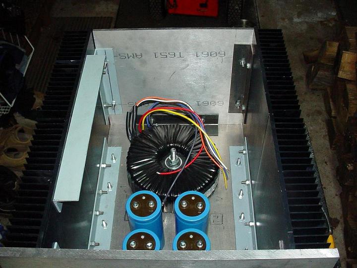

OK, watercooling is taking a back seat for now. I need a little help making sure my current sinks that I have are up to the task, and to make sure I have the correct data entered.
I have four of these per channel at a length of 12" my sink
Aleph setup:
+/-45V
12 fets
set at 4 amps
360W diss/ch
Each sink disspiates 90W with 3 fets. Based on the previous link, and my sink @ 12", we'll say each sink's °C/W is roughly 0.25. So with four sinks per, going back to William's Aleph Power sheet, do I enter 0.25/4 = 0.0625. Is this the Rthh-a (0.0625) of the amplifier as a whole, and is this the figure I enter into the sheet?
-john

John-
Are you saying you are going to use 48" of this sink per channel, dissapating 360 watts (8 amps total, 45 volts)? My totally unscientific guess is that this will be totally useless as a pizza warmer, but your FETS will last a long, long time.
JJ
okay, some of my estimate is based on experience, not totally unscientific.
JJ
I know they can safely dissipate lots of heat, close to 500watts. I'm trying to get a highly accurate read on them, to find max allowable dissipation while keeping junction temps happy. Safe is generally good, but its not necessarily fun.
One Channel:
4 sinks per (each @ 9.75"W x 2.28"H x 12"L)
4 amps bias per
One Channel:
4 amps bias per
- 7 amp aleph
