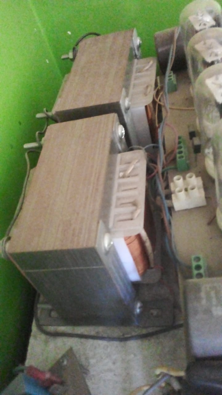

Those are some of my self designed chokes.

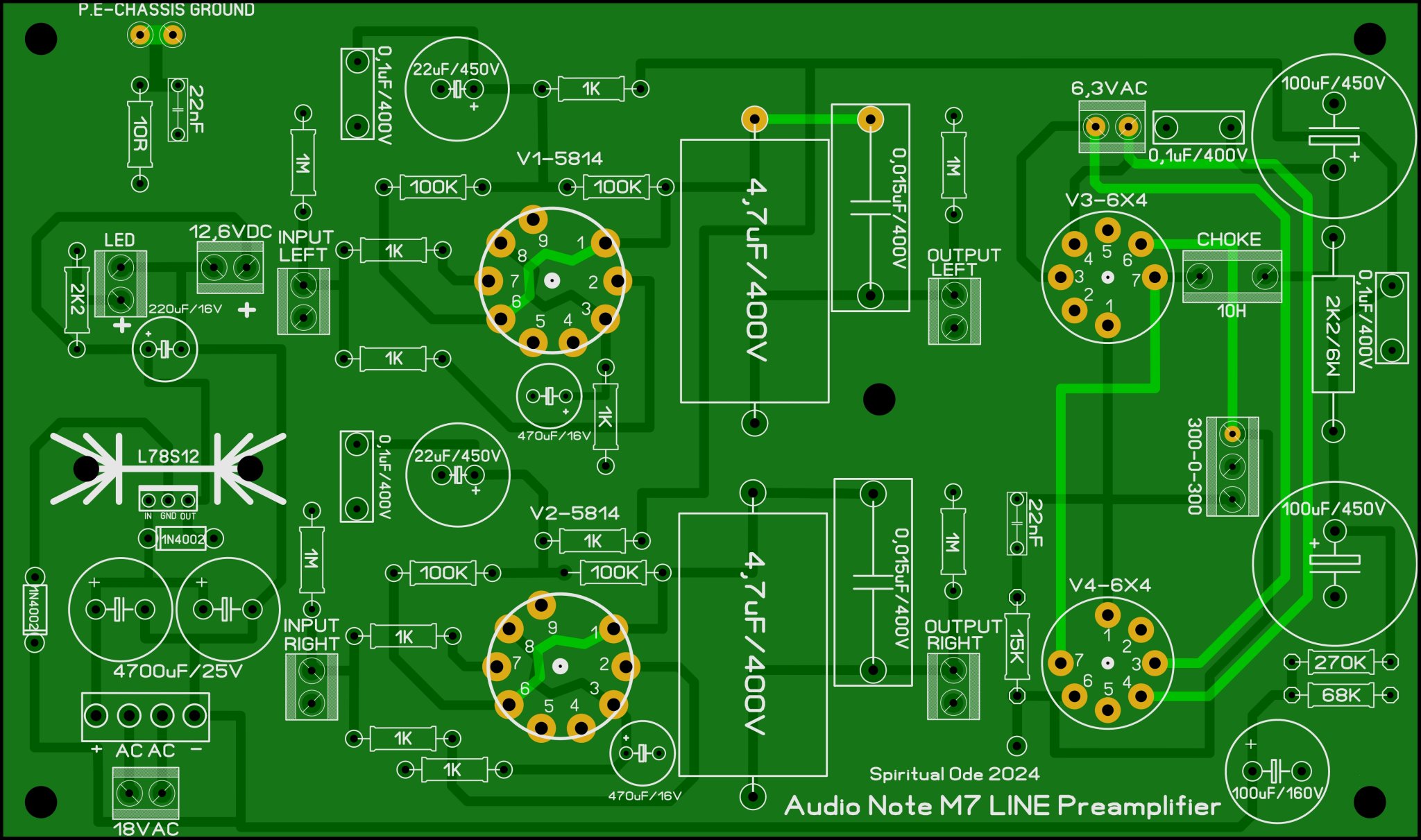

Imho, if you were to revisit your pcb then there may be benefit from including an RC snubber for each primary HT half-winding (as per quasimodo threads on this forum), and including a tuning RC across the choke to suppress mains 2nd harmonic ripple and lower the minimum choke inductance needed for regulation, and inserting an 1N4007 in series with each 6X4 anode to avoid future arcing, and include a 5x20 250Vac fuse in the CT link to avoid damage from faults, and making pcb trace connections to the lowest noise nodes such as direct to capacitor pads rather than along traces (especially to connect the 100uF elevation cap's pos terminal to the 12Vdc output terminal, rather than to the noisy end of that trace back at the bridge rectifier).

hello Tim,
At first, if you take a close look at the schematic of the preamp, you will see both 12,6 and 300vdc power supplies.
As you can see on the schematic, there is a 15K and a 22nF between the secondary (snubber).
My mistake with the previous preamps is the floating heater DC voltage.
I have built that preamp and tested it with a signal generator at 1Khz/2v sine wave and an oscilloscope.
Perfect shapes (triangle and square) and X-10 amplification using 2 JAN5814 tubes. When testing an amp I always trust my ears. If there is no noise or hum, it will be a good build. The only problem that may occur is the one that Osvaldo described previously ( The choke value).
I know that the schematic is not among the AN official kits but it doesn't matter at all whether it sounds good. Besides, the preamp schematic itself, it is a classic and simple preamp.
I don't want to use any semiconductor ( except the heater DC circuit) in my designs as I want a true tube preamp or amp.
Take a look at the complete preamp design.

Hi Spiros - yes I saw the single AC snubber in the AN schematic in post #1, which is why I suggested using the better arrangement of separate snubbers for each half-winding, although the benefit of such snubbers is very low level for valve rectified secondaries - it could be more influential for the 6V winding as that is ss diode rectified with a huge filter cap.
The point of linking to Mk7 details is that there may be more information on the choke than what is shown by the schematic in post #1.
Ears are often deceived, and I'd recommend using more than just a scope to assess preamp/power supply performance. The forums are littered with people who initially state a particular hum is at a certain frequency, only to latter measure it at a different frequency. Also, your speakers/amp and setup may not be the same as others, and their setup may allow noise and distortion and hum to be detectable, which is why there is a benefit to using measurement techniques that go beyond the limits of audibility, as a way of better appreciating if there are remnant concerns.

I design my pcbs and cabinets of my own, using aluminum and wood.
