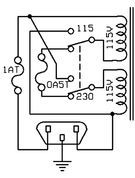

If you feel more safe with 230V then 250V, no problem.
To do the switch 115/230 the fuse must change too.
Can be done like this (two fuses in serie : weakest blow first).
Mona
Mona,
Thanks I have no issue with multiple fuses, I like the Idea of a fuse on the B+ as well I think I may end up playing with the amp in the future to maximize sound quality, My feer is damaging a high dollar part trying to make a minor change ect: extra protection for the transformer seams like a good idea as well.
Best Regards, David

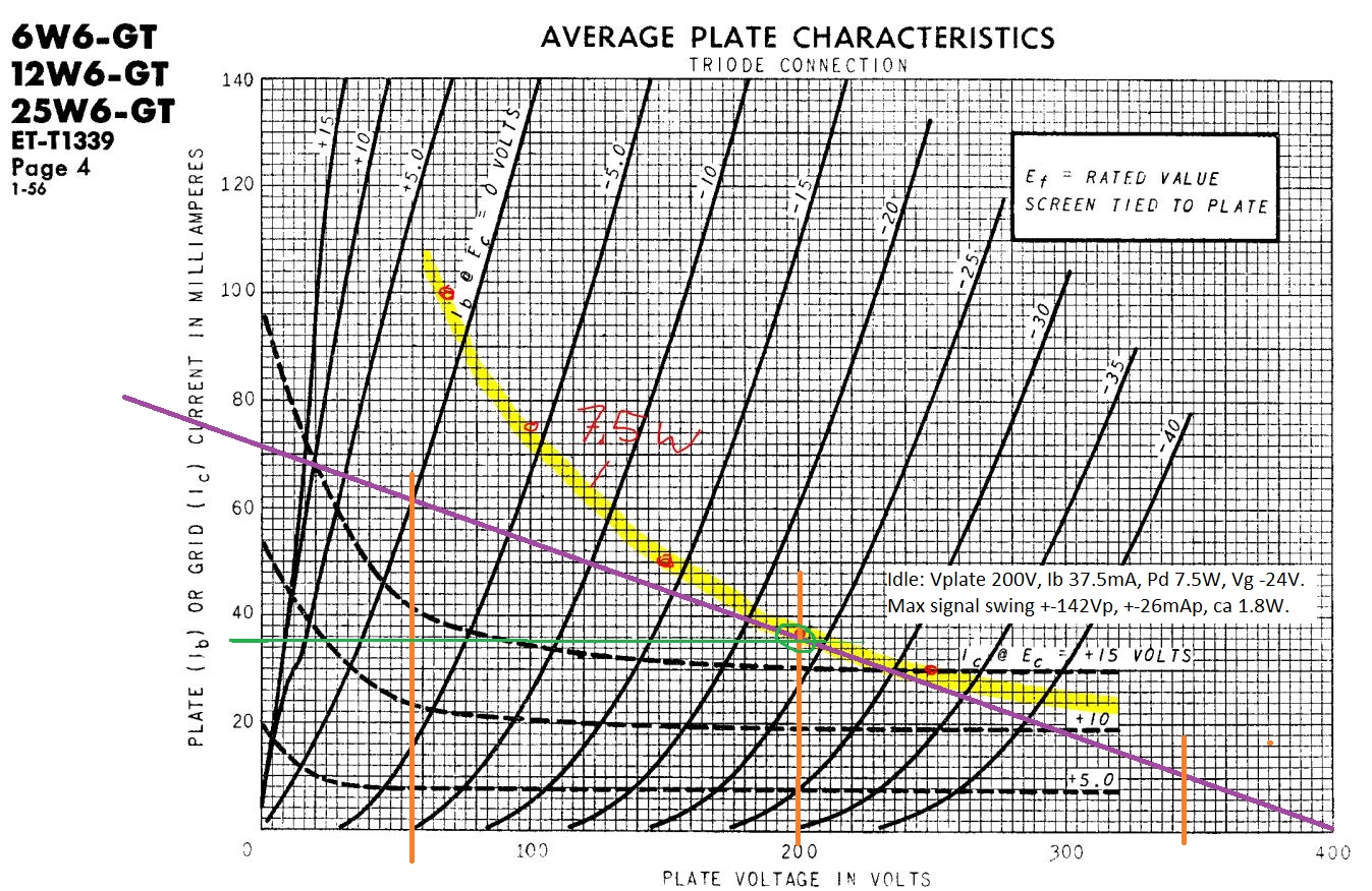

Triode 6W6 may be a poor man's 2A3, but since it's plate dissipation is half, the max output power is also half. Expect a little less than 2W before clipping. But believe it or not, 2W is amazing with the right tube. I know because that's what I've been living with the last year since I started 'upgrading' my behemoth 8W amp, and time just does not allow me to finish it...
But the 1.5W SE amp I am using, also for watching movies! is simply stunning, tho I admit it does compress slightly when pushed.
Are you using a 6W6 Triode SE? I don’t even know how to read the charts Yet..
David

Yes. But I have UL taps on the OPT so think I will include a switch so I can try triode, UL, and pentode. Triode gives just under 2W and in theory I can get about 4W in pentode.

Primary Mains impute 115V or 230V at 50Hz or 60Hz
Power 100VA
Secondary Outputs 4x
1st Secondary- 230V @ 0.22A
2nd Secondary - 230V @ 0.22A
3rd Secondary - 6.3V @ 3A
4th Secondary- 6.3V @ 3A

The 12L6/12SN7 mini singe ended circuit design used a Filter Choke (5 H / 150 mA Hammond 158Q) if I use the AnTek - AS-1T230 - 100VA 230V TRANSFORMER with 2X 6W6 & 1 X 6SN7 this will requiring 2 x Amps over the 12L6/12SN7 combination. Is the Filter Choke (5 H / 150 mA Hammond 158Q) adequate?
2nd Question-
Alllensoncanon recommended considering a more efficient CLC filtering in the power supply. I found on line a 6W6 circut using a CRC filtered solid state If I used either the CLC filtering or the CRC filtered would this make the Filter Choke not necessary?
- Tubes / Valves
- 6W6GT SE AMP 4-watt Plan first Amplifier build
