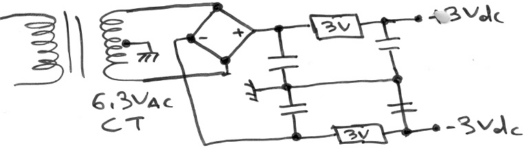

Second thought is to use a FWB and with two regulators have +/-3Vdc. And feed this to the filament. Sth like the attached schem.
Will these circuits work? And which is the best?

+/- supply is useless. Ground in the circuit is floating for one, putting the regulator grounds in series. Probably a good way to make smoke.

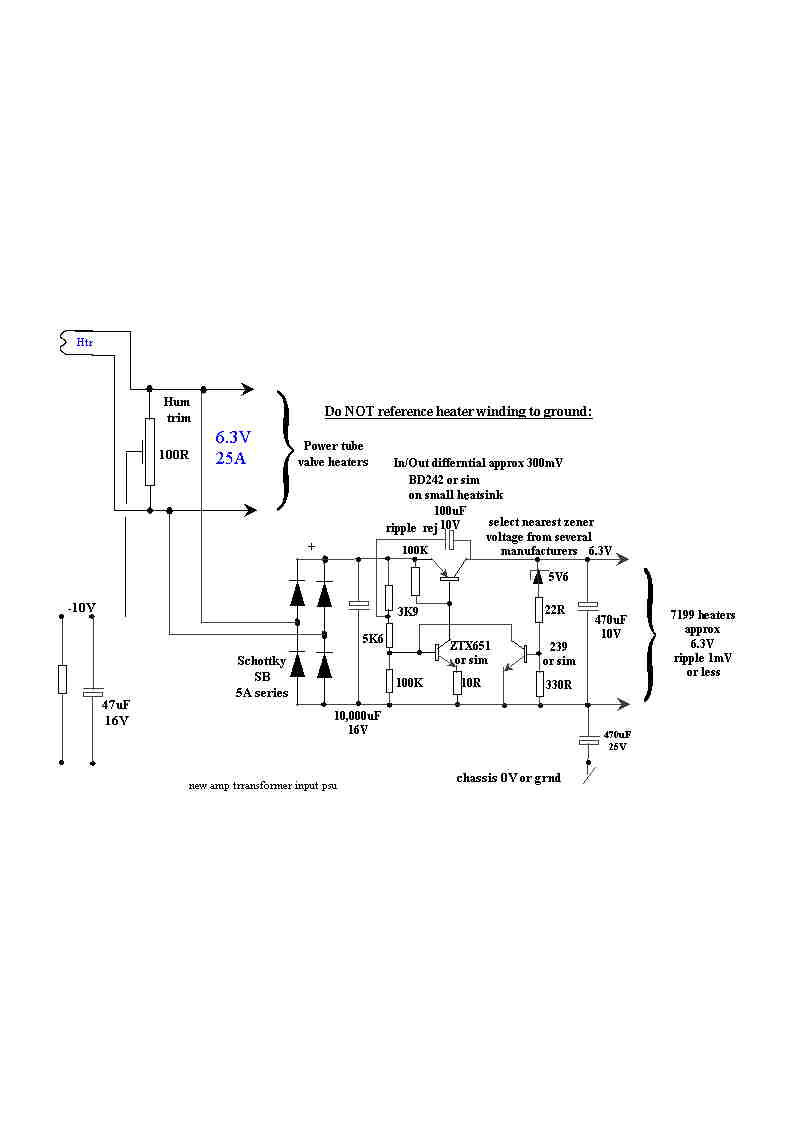

Hi there......the power tubes wouldn't know AC from DC....unless a real htr-cath short existed.
I regulary DC'er my front ends....to advantage. Circuit enclos....a scrounge low dissipation circuit using SB series schottky diodes and very low dropout (0.3V in/out diff) which has been around for eons. The 6.3V AC rects to around 8-9V which is more than enough.

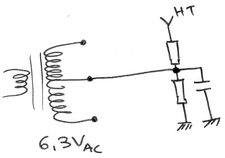

So there’s solution.I like very much Tim’s idea.
FWIW, before you try DC heaters, try grounding a resistor divider, or better still than grounding, elevate it a few volts above the highest cathode voltage (if possible).
As I know AC sounds better than DC!
As I understand, use a resistor divider from HT to ground and from the joint of the two resistors feed the heaters. About how many volts?
I will not ground the CT of the heaters winding,right? :hot:

Grounded means two things, AC or DC. Just remember that you want the center of the heaters grounded, if just AC-wise. So a bypass cap, say 10uF tacked on that voltage divider will do well. If you don't have a hum balance pot or CT on the winding, use two 100 ohm resistors to obtain a center tap.

I have attached a pic.Hope it's something like this.
But,how many volts must I apply to filaments?
Ht is around 250V.
Or if that 5VAC winding is going unused and is rated for the current, a FWB on that might work right off the bat, no resistor or regulator needed!
Tim,
Suppose R1 is the upper resistor and R2 the other (I'm reffering to the voltage divider in my pic).
How much must be the total resistance of the voltage divider? 🙁
R1+R2= ?
