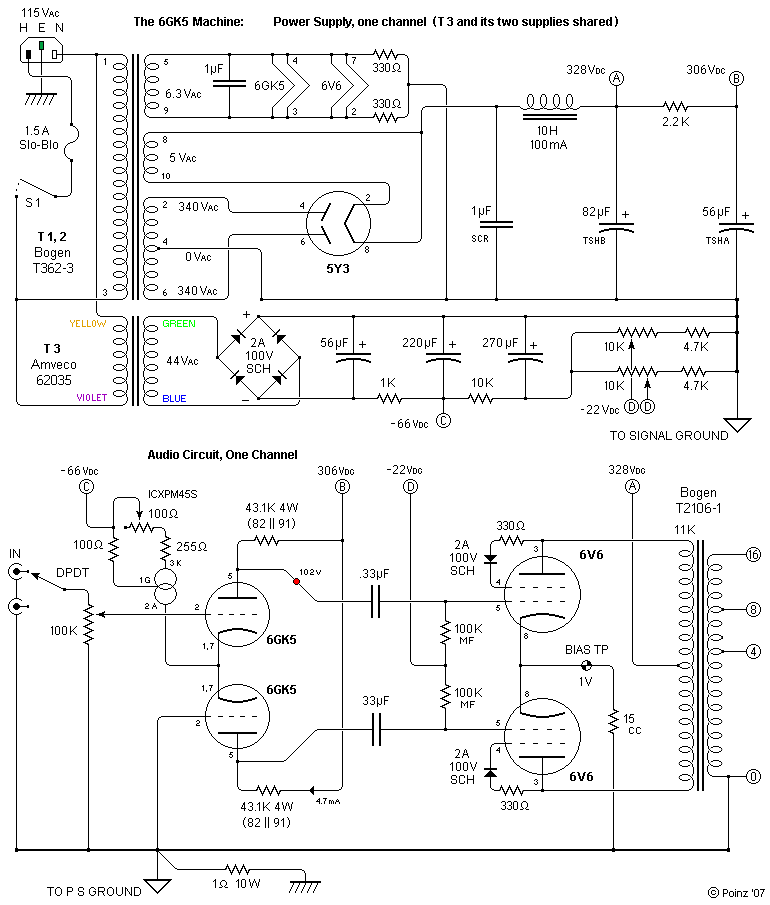

Hi, I'm new on this forum and new to building audio amps.
I have always loved rich warm open tube sound with it's roundness and effortless airy high frequency articulation but I've never owned one except a Citation II which I threw in the garbage
20 years ago because I was stupid.
So, I have a set of H/K A300 output transformers and 4 RCA 6V6GTA tubes NIB and want to make them into an amp.
What now?
I've read here and there about open ended, class A, class AB, triode, push-pull, etc., but I'm unknowledgeable in this field of expertise.
Should I turn and run, or buckle down and begin building?
The transformers are coming out of a semi-working A300 I own but I would rather build something different, better looking, & dedicated as an amp only, - perhaps even monobloks if I can locate another set of power and filament transformers, which I might be able to find at a local flea market.
The speakers I have I built using a set of EV-made 15" in large ported enclosures with efficient 6" EV VMR mids and a set of T-350 tweeters, so power requirement is minimal, and ~5-15wpc would be fine.

How sensitive are your speakers?
How comfortable are you working around high voltages?
I would consider Poindexter's 6GK5/6V6 music machine. About 6 watts triode. Well documented, modern implementation with fixed bias, a CCS and SS rectification.
His site is here: AudioTropic Projects; The DIY Pages.
The site still shows the older (5965) version of the MM; do a search here for the 6GK5 version.

RennoVattio,

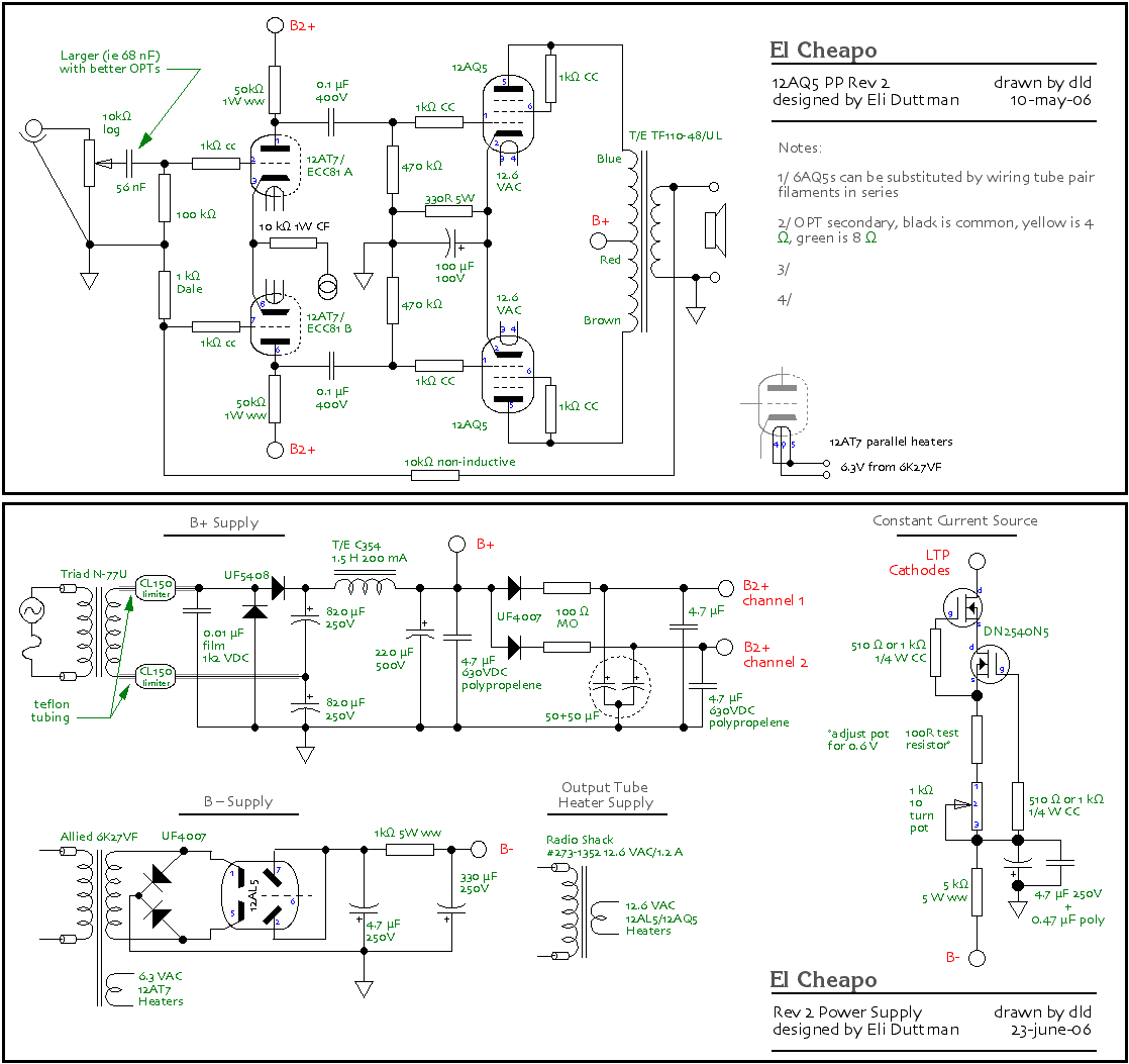

Poindexter's design eschews NFB and that requires very high quality O/P trafos. I strongly suspect that the H/K O/P trafos will work best inside a GNFB loop. So, I will immodestly suggest you build an "El Cheapo" variant. Yes, Poinz's design and mine are "kissing cousins". His effort is an attack on SOTA. My effort is low budget, but highly competent.
Triode wired "finals" yield 6 WPC, which you say is enough. I need to get the A300 schematic to see what the power trafo can do.

RennoVattio,
I've got the schematic. Thanks for the link.
Except for the B- supply, the H/K power trafo is near perfect. H/K used a Greinacher ("full wave") voltage doubler B+ supply. So did I. 😀 A 355 V. B+ rail is "ideal".
You have the makings of a very nice stereoblock "El Cheapo". A Triad C-24X filter choke and a AnTek AN-0130 toroid will complete the power "iron" set.
