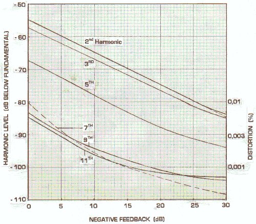

The 'multiplication' of harmonic distortion as discussed in the learned posts above is valid, but the practical implication is also a factor of the initial magnitudes of the components. Much of the NFB controversy arises while only taking a qualitative view. It is informative to look at practical figures to avoid a misconception.
If the circuit is 'clean' enough to begin with, harmonic regeneration does not become a concern until quite a degree of NFB is applied. The attached graphs are typical of the behaviour of what will happen to a kosher circuit as the amount of NFB is increased. It will be clear that in this instance that harmonic products starts 'coming back' only after exceeding 25 dB of NFB. (The graphs are for a transistor amplifier but the same principle applies to any amplifier. I also apologise for presenting a hand pasted-up version which I have on the pc.)
Interesting graph. Where did it come from?
I have in fact seen similar graphs elsewhere - always for solid state amps, never for tube amps.

I contemplated this for a while (it is now deep into the night over here so I hope my mind is not affected!). What you say is true, though again I would like to put figures to the case, not just qualitative terms - still. But, when I measure an amplifier and plot distortion products starting from zero nfb, I would expect to notice the effect of those 'generated-by-nfb' harmonics in the measurements. I agree that an analyses of an output signal at any one feedback factor do not necessarily represent the amplifier's performance without such feedback, simply by multiplying figures with the nfb factor. I think though that when graphs show a more or less linear decrease in distortion products with applied nfb, I do not have to worry about how they were achieved. What will be audible or at least present in the output with any nfb factor is what the measurements show for that factor.
The graphs were measured for a design of my own, with assistance from Spice at low levels, where measurements became vague (I cannot afford the most expensive spectrum analysers!).

Again interesting and true! But I do not dispute Peter Baxandall's findings (if that is the article you are referring to). As an illustration it was useful, but as illustrations go it was 'formulated' to clearly show the intended results. It was not typical, in the process showing something else in that when initial distortion is severe enough, sure enough matters get out of hand at an early stage.
That is why I placed a caveat: One must start with a 'clean' amplifier! I believe that my example shows that in such a case enough nfb can be added (again, in the right way) before the resultant artifacts will be serious enough to bother. That is also why I keep urging for figures rather than just referring to 'things that weren't there before' - in what quantities? Again: The subject is audio, involving the limitations of hearing, in this case frequency- and amplitude-wise.
You could have commented that contrary to the impression given previously, my graphs do indeed indicate some 'regeneration' of harmonics of higher order. Should that have been absent, the slopes for all graphs would have been constant. Yet the 7th, 9th and 11th start increasing from as little as 10 - 13 dB of nfb.
