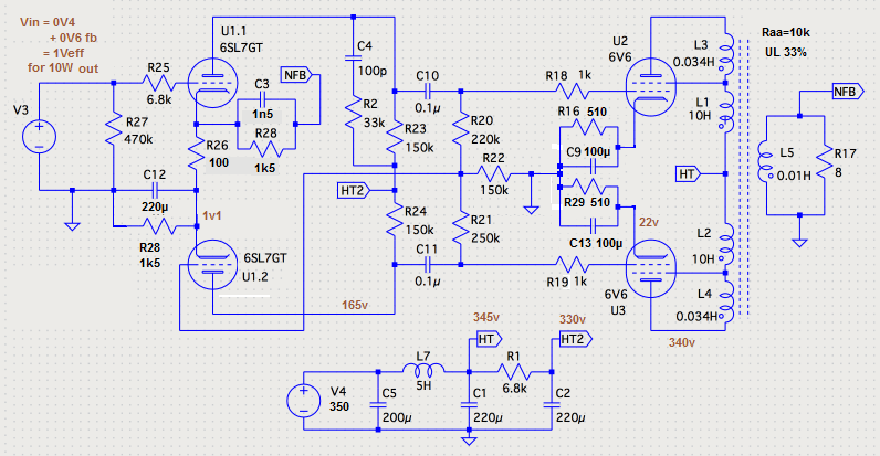

Hello,
I want to build my own amplifier, but for now I'm studying theory and buying parts.
The transformer I bought has a primary resistance of 8k, taps UL 33%, with an output of 6 and 8 ohms.
From the various articles I've read, I understand that 33% or 43% taps don't matter for the circuits, but I didn't get the info on the transformer resistance.
Please answer a few of my questions, maybe they will be a little silly.
Do I need to adjust the B+ and cathode resistor for 8k trafo or can I stay within the schematic in post #23 by Mona with a 10k winding?
Also, if I'm going to go with el84 instead of 6v6, I need to change the cathode resistors from 510 ohm to 240 ohm, is that correct?
NFB - can I start with the value of the resistor and capacitor shown in the schematic?. Once completed, I'll try to get someone with a measurement outfit.
Thanks for answers,
Boba.
schematic from post #23
