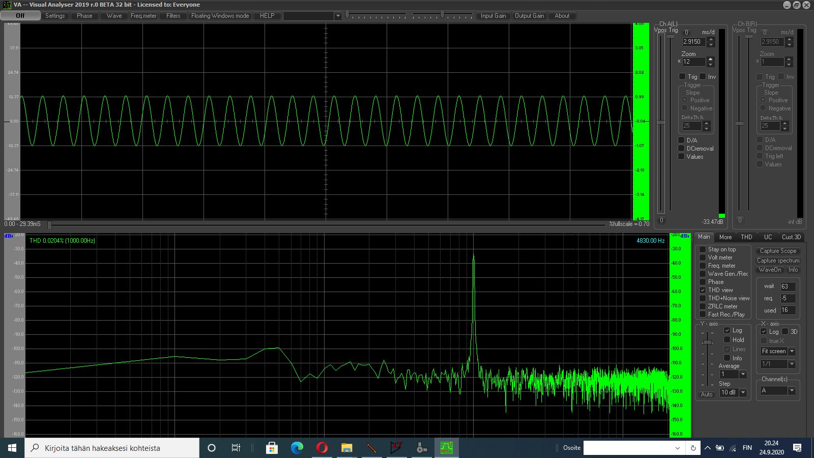

@Artosalo: nice definition, but unfortunately I have no means to measure thd.

Some amplifiers are accused of not sounding good because of a simple problem . . .
The DC current in the output transformer primary halves are un-balanced.
