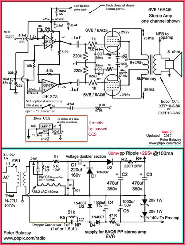

Yes, a dropper capacitor and a filament string do not care which end is at hot, and which end is at neutral as far as voltage drop and current are concerned.
However, if the tubes can not take 120V x 1.414 = 170V peak from filament to cathode, then it does matter which way the dropper and filaments are wired. So, the filaments need to be at or near the neutral end (or more accurately at the ground end, where the cathodes are).
And, since the amp chassis ground is at neutral, that is another problem.

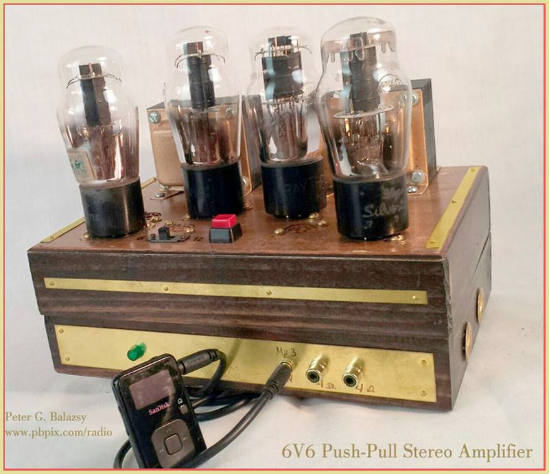

Yeah let's please stop beating the PSU dead horse... thanks. lolAs the OP apparently has corrected his PSU issue, I think it is time to return to a discussion on his amplifier itself:
You don't really want to use RCA jacks as loudspeaker terminals, do you?
Best regards!
Why not use RCA jacks for the speakers?
I have been for years with nothing adverse.... can't even image why not.
... so why do you ask that??

I'm not sure I follow the 120v rms or 170v peak potential thing... and how it relates to the cathode potential.Yes, a dropper capacitor and a filament string do not care which end is at hot, and which end is at neutral as far as voltage drop and current are concerned.
The series filament string terminates at signal-grnd/neutral.
The cathodes are sitting at approx +20vDC w/respect to signal ground.
The four 6.3v filaments are in series on AC, and the RMS voltage (via the dropper cap) at one end of the string is 25.2vAC away from the far end of the string and it reverses each AC cycle.
(The dropper cap is NON-polarized and it can only work on AC so it does NOT ever matter if it is reversed or not)
So where does the 120v rms or 170v peak enter the realm ...esp as it relates to the cathodes which are at +20vDC?
First reason is to avoid confusion between input and output, ot input and output cables, second is the rather tiny contact aerea, especially for the hot pin. RCA jacks just aren't dedicated to carry significant current.

Thanks. Good suggestions.Be sure to connect your non-insulated amp only to non-gronded sources then. The GFI will protect you (if correctly installed), but I've seen blown USB DAC and PC audio cards due to fault current flowing between the amp ground and the PC ground. The tube amp will not even notice it: in a similar situation, I once saw a small spark inside the preamp tube as soon as I plugged the RCA cable in the input terminal. The tube was totally fine and undamaged, the PC sound card destroyed. A very small current is enough to damage semiconductors on the source. I would use a insulation transformer just to avoid potential damages. The cost of a 200-300VA toroid transformer is low, and you may even wrap a few extra turns of magnet wire around it to get an improvised filament winding.
I designed this amp primarily as an Mp3 fed power amp. So my Mp3 device is battery powered.
The GFI would shut off power to the amp if any of the neutral-connected surfaces were to contact earth ground. So I think I'm ok as far as that goes.

If you look at the front panel you'll notice that the input jack (Mp3) is a completely different type of jack from the two RCA speaker output jacks.
I don't know what the RCA jack current rating is but we're only dealing with the 6V6 PP speaker audio signal here.
How much current do you suppose that might be?

So with 8 watts we're not talking about more than an amp or so... right?
I tried to find the exact current-carrying specs for RCA jacks and all I found out there so far, was the general consensus from lots of folks, that RCA jacks can carry quite a bit. At least 3-5 amps to maybe two or more times that because there's such a large metal contact surface area for both contacts (pin & sleeve).
Ref:
What dangers are there putting power through RCA connectors? - Electrical Engineering Stack Exchange -----------------------------------
"I've often used them at about 5A. They get a bit warm towards the higher end but I haven't had one melt (so far). I standardised on using red ones for 5V and yellow for 12V, same as ATX wiring."
"The RCA connector can handle 48v and 3amp. I have this arrangement on a electric bike battery charging circuit. What is important is that the cables used can also handle that current without getting hot enough to melt the insulation. Voltage rating below 48v not a problem "
(I'd really rather see a manufacturer's written specification to be certain.)
But .. so far at least, it confirms for me that using the RCA jack, as I am, for speaker-output signals is sound. ( no pun intended)
If you happen to find an actual manufacturer spec please pass along the link.
