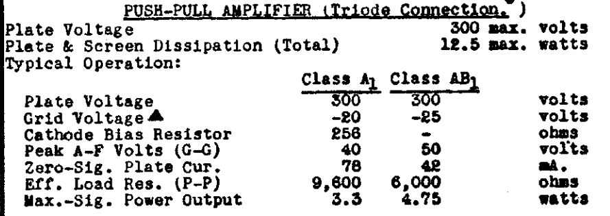

6v6 Musical Machine - Clipping & power expectations
The ins and outs of paralleling tubes was the cover article of the last issue of "Glass Audio".
"Paralleling Tubes Effects", Glass Audio, Volume 12, Number 5 2000.
The article included measurements, Listening sessions, design considerations, etc.
This should make you feel better about the power output you are seeing 😀. With your small transformer actual power will be less.
I would say it appears that the amp is working as designed.
But I think one of your issues is that you were expecting (wanting) more power from those 6V6 tubes.
Did I understand you correctly?
Have fun listening to what you have.
Then decide if you want to keep the amp the same, or re-design it.
Then build another completely different amplifier as your next project.
Thanks, I'm pleased it's doing what it was designed to do - that was my main concern! I'm happy listening to it as it is, though haven't tried it on the main system in a bigger room. A modified version for a new project sounds like a good plan.
I'm not seeking more power out of this musical machine design, just wanted to be sure that the clipping behaviour I was seeing, and power levels, were what it was supposed to be doing! 🙂 Thanks for your help with it - I know a lot more now about how these things function than I did!

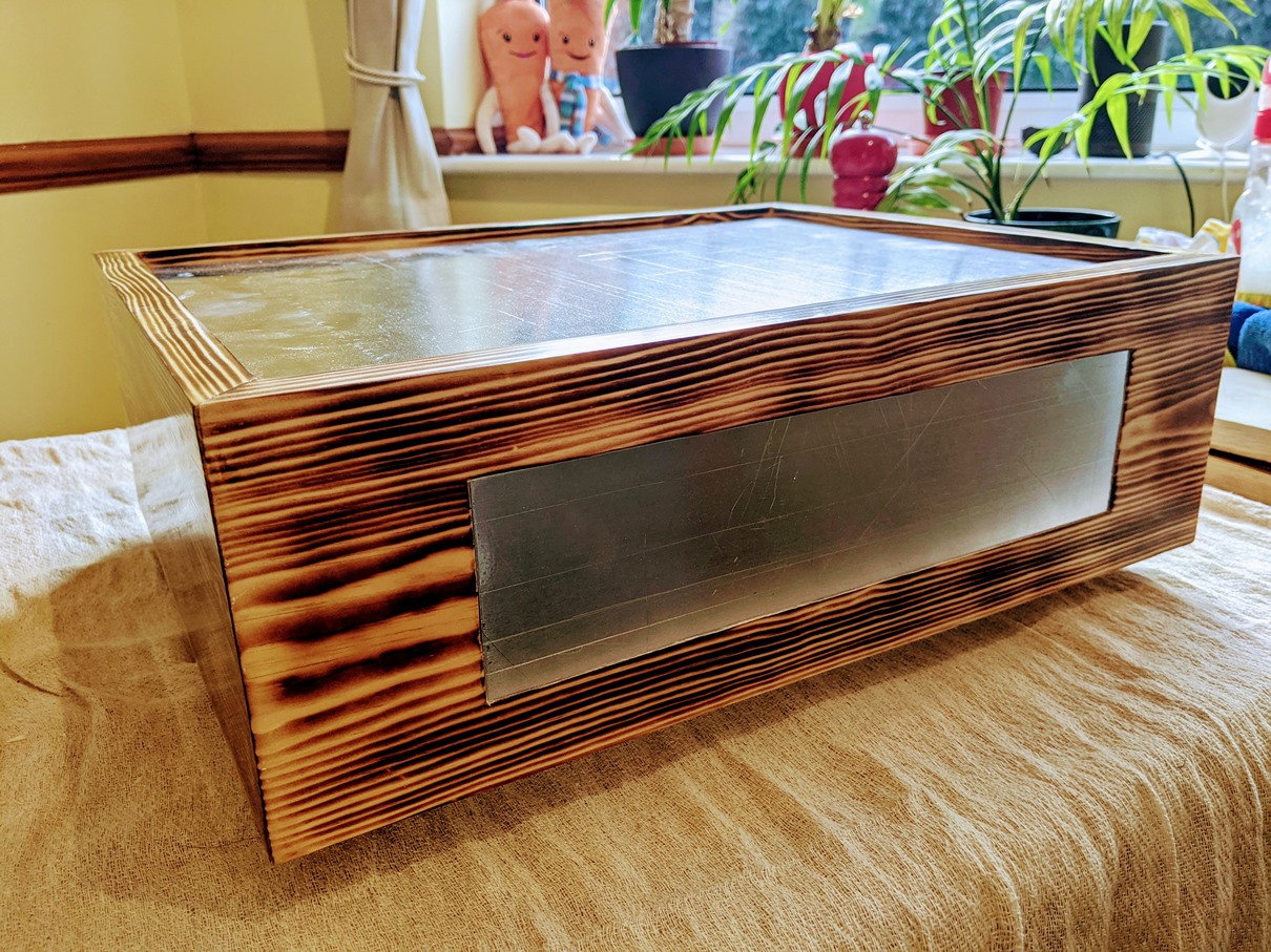

Thanks! Really appreciate that, nice when DIY efforts work out. 🙂 Been building a wood/alu enclosure for it over the Christmas break, and I'm far more inept with wood than I am with electronics. 😱

Hehe, fantastic - which datasheet is that from? 🙂

Attached a couple of box pics... 🙂
Continuing the, erm, cost-effective theme of this project, it's just a mitred cheap-pine box. I attacked it with the blowtorch for a shou-sugi-ban effect. Kept me quiet over Christmas. :deerman:

AWV Radiotron, there are only 2 datasheets that show triode push pull data, that one and Brimar:
Cheers, I've looked at a few but not spotted those with the additional info.
