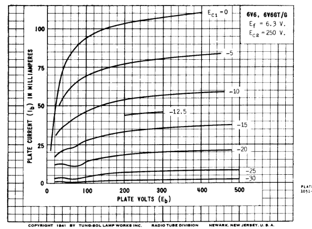

The datasheet curves (attached) are for 285V on the screen grid (G2). With this voltage on G2, notice that anode current never really rises above 110 mA, even with 400 volts on the anode (and zero grid bias, zero volts on the control grid, G1.) Operated within factory specs, with control grid never going positive, you cannot squeeze more than 110 mA out of a 6V6.
We found out in the earlier calculations that you need something like 270 volt peak voltage across each half of the Deluxe OT primary to deliver 22 W to the speaker.
Ohm's law tells us that if we apply 270 volts to 1650 ohms (anode to centre-tap primary impedance), 163.6 mA of current must flow.
And we just found out that according to the manufacturer's datasheet, a 6V6 cannot deliver 163.6 mA, even with 400 volts on the anode, and zero volts on the control grid!
So now we have another connundrum: operated within factory specs, with control grid never going positive, you cannot get a 6V6 to drop 270 volts across a 1650 ohm load. So a pair cannot deliver 22 W into a 6600 ohm OT primary.
So how did Leo manage it? He didn't put 285 volts on the screen grid, he put something closer to 400 volts on them. Increasing G2 voltage has the effect of lifting all the anode current curves higher.
Without measuring one with a curve-tracer, I can't say exactly how much higher the 6V6 curves go with 400 volts on G2. But we must assume that the former 110 mA curve has risen to something well over 163.6 mA. Otherwise, there is no way to get that required 270 V peak voltage, and no way to drive 22 W into the speaker.
So now we know the factory datasheet curves are worthless in Leo's world, a world in which you penny-pinch the cheapest output valve you can find till the anode glows dull red, rather than do the right thing and buy the next size bigger valves.
In Leo's penny-pinching world, the 6V6 curves have all moved far from where the factory told you to expect to find them.
With all the curves moved, the factory load-line doesn't apply, either. With all the curves moving higher (more current at the same anode voltage), you will now need a lower-resistance load.
How much lower? Again, we can't tell without actually measuring 6V6 curves with 400V on G2. But apparently, Leo found that OT's with a 6600 ohm primary did the trick.
Whether Leo did careful testing to find the optimum, or simply bought the cheapest OT he could find that was "a bit less than 8000 ohms", we can only guess. My bet is that it was the latter.
So the short answer to your question is: if you operate the valves far, far, far from factory specs, then the proper load impedance will also be far from the factory specs.

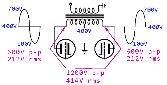

If anybody is still unclear how we have >1000V p-p with only 400V supply....
Draw it out with 1-thumb numbers so the arithmetic is clear.
We have 400V. The tube will pull-down imperfectly, say to 100V. A 300V down-swing. It will also kick-up the same amount, to 700V. So 600V p-p on one side. On the other side it swings up to 700V and down to 100V. Totals as shown.
Note the factor of 8 in the denominator: this comes from the conversion of peak-to-peak voltage to RMS voltage [divide by 2 times the square root of (2)], and then squaring that to get RMS voltage squared. Squaring [2 x root(2)] gives you exactly 8.
So much for my envelope...😛 I used peak voltage instead of RMS voltage for the calculation, some one should check the checker! 🙂 Thanks for your patience and taking the time to explain everything.

Are there any 6V6 datasheets that shows plate curves at various different G2 voltages? That might let us extrapolate roughly where the 400V G2 lines fall, at least the G1=0 line.
I forgot something when I said earlier that the line would have to move up to at least ~164 mA. There should be something like 20 mA quiescent current on top of that, so the line really needs to move somewhere above 185 mA at a minimum.
Tubelab George's approach of driving G1 into positive grid voltage territory - but with only 250V on G2 - makes more sense to me than Leo's sky-high voltage on everything.
The key point is that the transformer operates on current. That's what makes the magnetic fields that do all the work.
So we can start at the load and the wattage to calculate a current flow. Then we can calculate the current flowing in the primary (assuming no losses). Now we can figure out the voltages necessary on the primary, realizing that the tube is very much a valve allowing current to flow.
Ergo, the voltage on the primary is a byproduct not a cause. Vpp therefore is not some kind of limitation to primary voltage.
...transformer operates on current.....
All power systems operate on both voltage and current, sure.
An ideal transformer, no load, draws no current.
Mid-band, a $50 transformer draws very-little current above load current. (Yes, the bass sucks current.)
Assuming the 6V6es swing voltages leads to the only possible answers. I'm not sure your "operates on current" insight adds anything.
It is however perhaps important to use a large enough "envelope" to sketch the WHOLE circuit and annotate all numbers as peak or peak-peak, etc. There's too many loose ends to keep all straight in the head or on a matchbook.
The reason for my comment, hopefully to add insight to the person asking the question, is that people tend to look at the power supply voltage as defining the limits of what will be found within the circuit. Modern semiconductor circuits would normally stay within those voltage boundaries.
Ponder the Triode curves. You know the plate current is hardly affected by plate current. The rise of total current is due to higher voltage on G2.
You can also ponder 7027 sheets, some of which show Vg1 curves for several Vg2 values.
