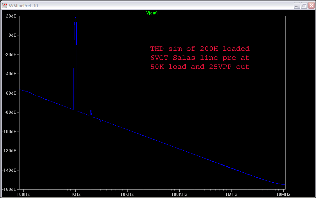

I have a bunch of old Hinchley chokes, weigh just over the kilo and measuring 115 H and around 950 ohms. I have no data except that but I think they would be up to the task of inductively loading 6V6 in this config very well, even with more current.

I'm very intertested as I have a pair of Iso-Tango anode choke (TC-60-35W) 60H/35mA unused in my drawer that should fill the bill. With a Rdc of 730 ohms what I have to do to try them is to lower the supply voltage to 245-250 to get the same 230-235 V on anode as per the lastest sch.

Just hold the same bias point, i.e. circa 235V on the plate and 15V on the cathode. The more the inductance the less the THD at more the swing, goes without saying.

It takes >=50K amp to do this FFT. The resistive one holds spec (worse) down to 20K, and the buffer down to 5K. Good luck when making it.
Salas, Could you explain further? Are you saying that this is sim'd performance of this amp with choke and resistor is better or worse. Have considered getting some chokes just to try. Just got new power transformer so will be rebulding it all.
Choke is better and it needs lighter amp load to maintain all the goodness in this instance. Not that it is a complete slouch at 20K output load, but see the difference to 50K that I had posted before in #1348.
