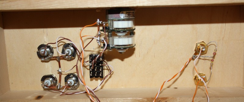

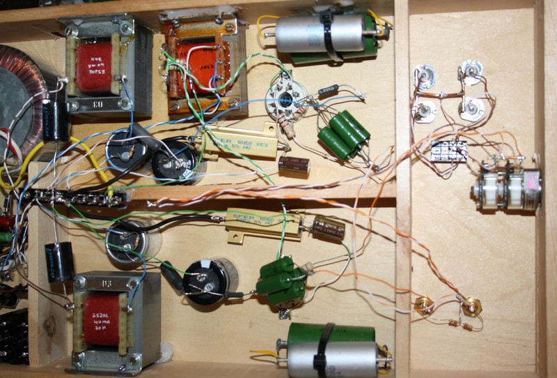

WRT the noise you're experiencing... could it be your smallish choke is hitting saturation? Cuz your first cap is only 2uF (from memory) the PS behaves like a choke-in filter. Loading thoose 150uF pulls lots of current...
Perhaps you can experiment with a resistor of equal resistance in parallel with the choke to see what happen at half the power? Or replace it altogether 😉
Discoman,
The choke is per channel. So about half of it's current is drawn. Should be ok?
Btw the noise is actually not so bad. It sounds like white noise. Soft white noise...Not audible from my listening spot. Still. Not something I expected.
Currents can be examined in PSUD, of cause. I'd suspect those mini chokes for the reason I gave. 40mA is for AC and DC current simultaniously -and besides, they suck. 😉

Choke in general? Or the ones I have?they suck
I'll try Salas's suggestion first. Replace grid stopper carbon film with metal film.
OK, but grid stoppers should ideally be neither magnetic nor reactive.
Chokes are all right if used within current range. I suspect that's going wrong here.
... first cap is only 2uF (from memory) .......
ehh, with that small smoothing cap, are you not feeding your choke with ac ripple 😕
I'll try without 😉OK, but grid stoppers should ideally be neither magnetic nor reactive.
Maybe it's not the linestage at all. Since I can't hear the noise with headphones or on my computer room system.
I've been used to playing directly from my DAC to power amp. (Volume control digitally via my Squeezebox Touch)
Perhaps the gain of the preamp is now making the DAC (6N6P output stage) white noise audible?
An estimate:
without the 2uF:
Very likely. Not getting it on headphones is a strong hint it may be a push to source hiss. If you can FFT the chain rings you would see exactly. Are the big system's speakers highish sensitivity or horn even? Multiways with dedicated HF units?
