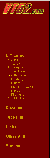

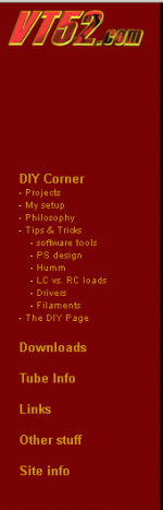

go here : http://vt52.com/
look in diy corner for software tools

go here : VT52.com
Sorry, did not see any software tools. What am I looking for?

Oh, you didn't have to make that so difficult...
http://vt52.com/diy/tips/platechoke.xls
It was in Tips & Tricks section.
