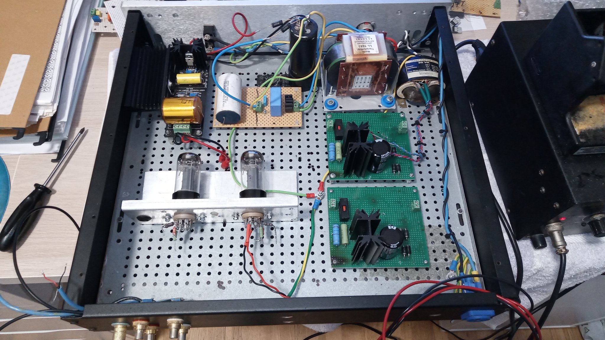

6V is surely enough. Stays between +/-5%. Some say don't go to the edge of spec like 5.7V which is -10% because cathode poisoning may happen. And don't go 6.9V which is +10% for life shortening may happen. Others say the getter material is going to expire before the filament anyway. But nobody ever said 6V-6.6V is bad.
Tomorrow I will adjust the other current regulator and left as is. Not sure if tomorrow finally can listen the 6V6 because at the afternoon plays R. Madrid vs F. C. Barcelona the Supercopa final.
Football time to relax. Those tubes you got show very good Vh consistency on same current anyway.
Has the right gain for your application on the other hand. No excess gain means less non necessary noise so there's an upside also.
