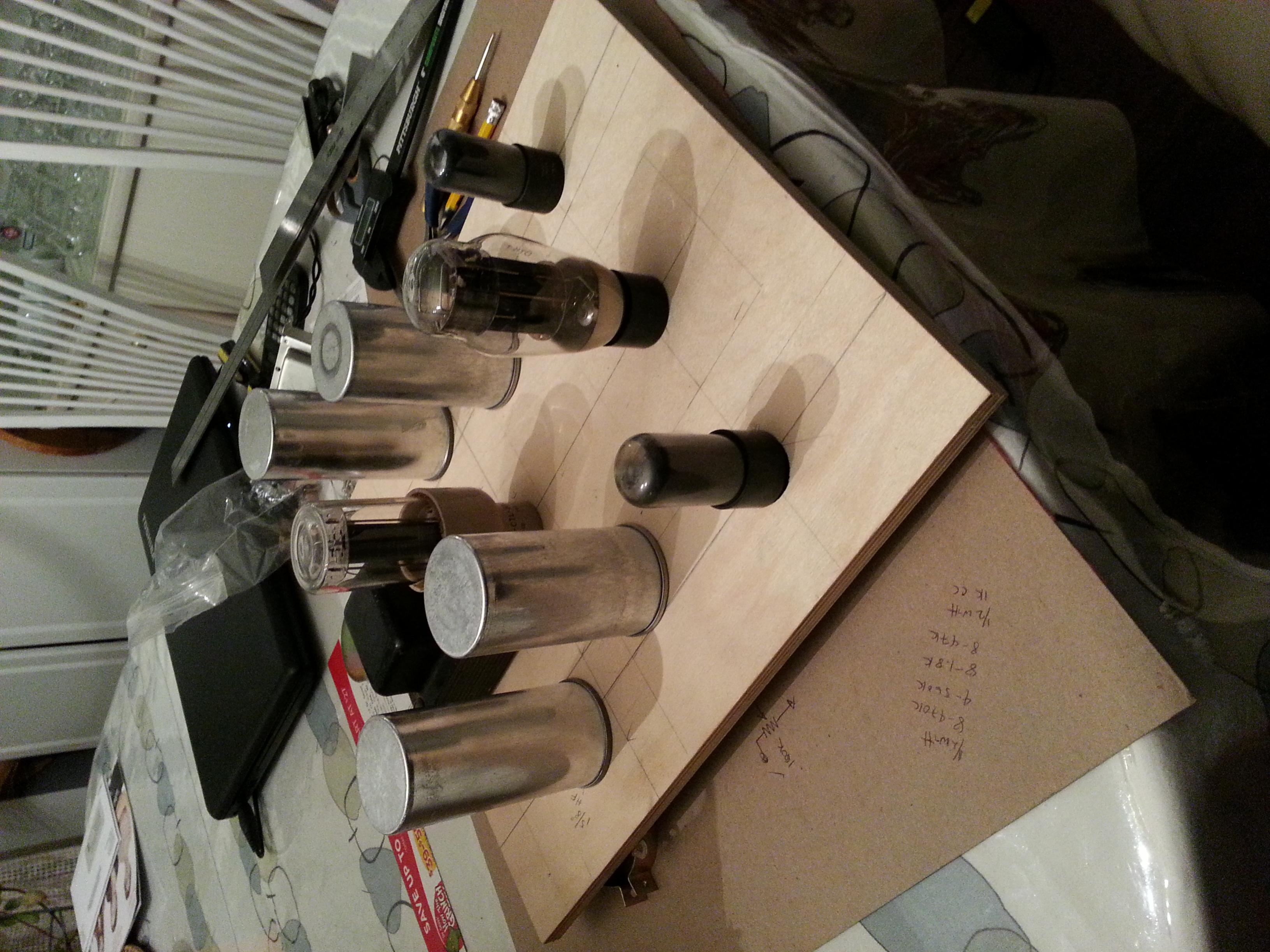

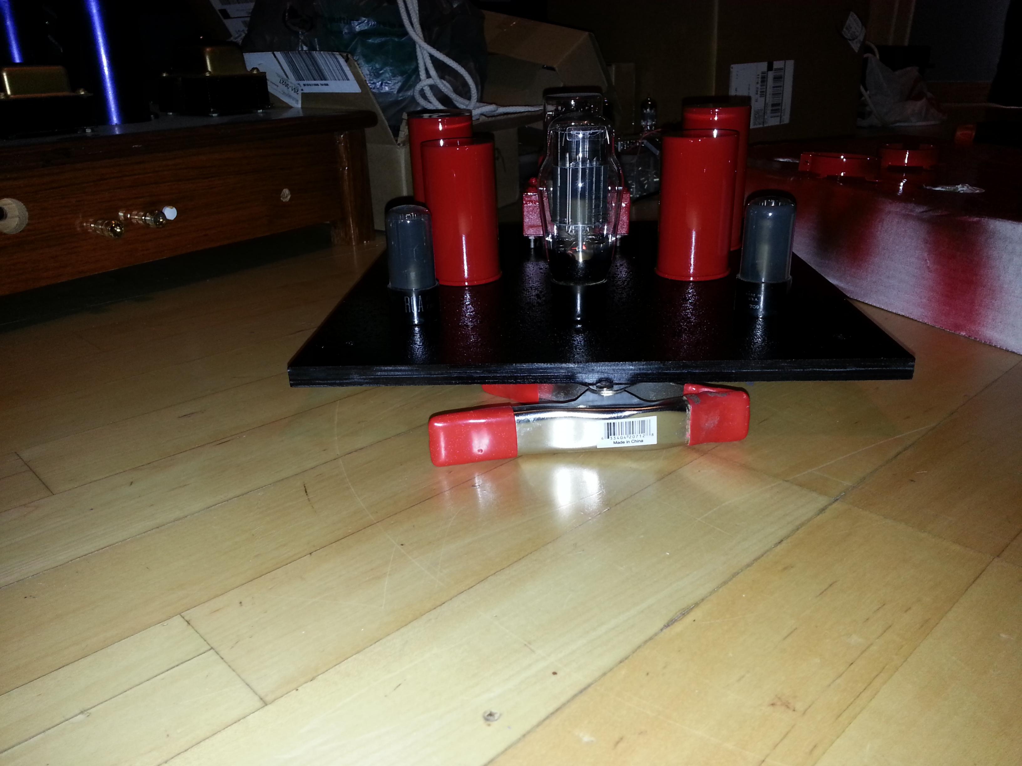

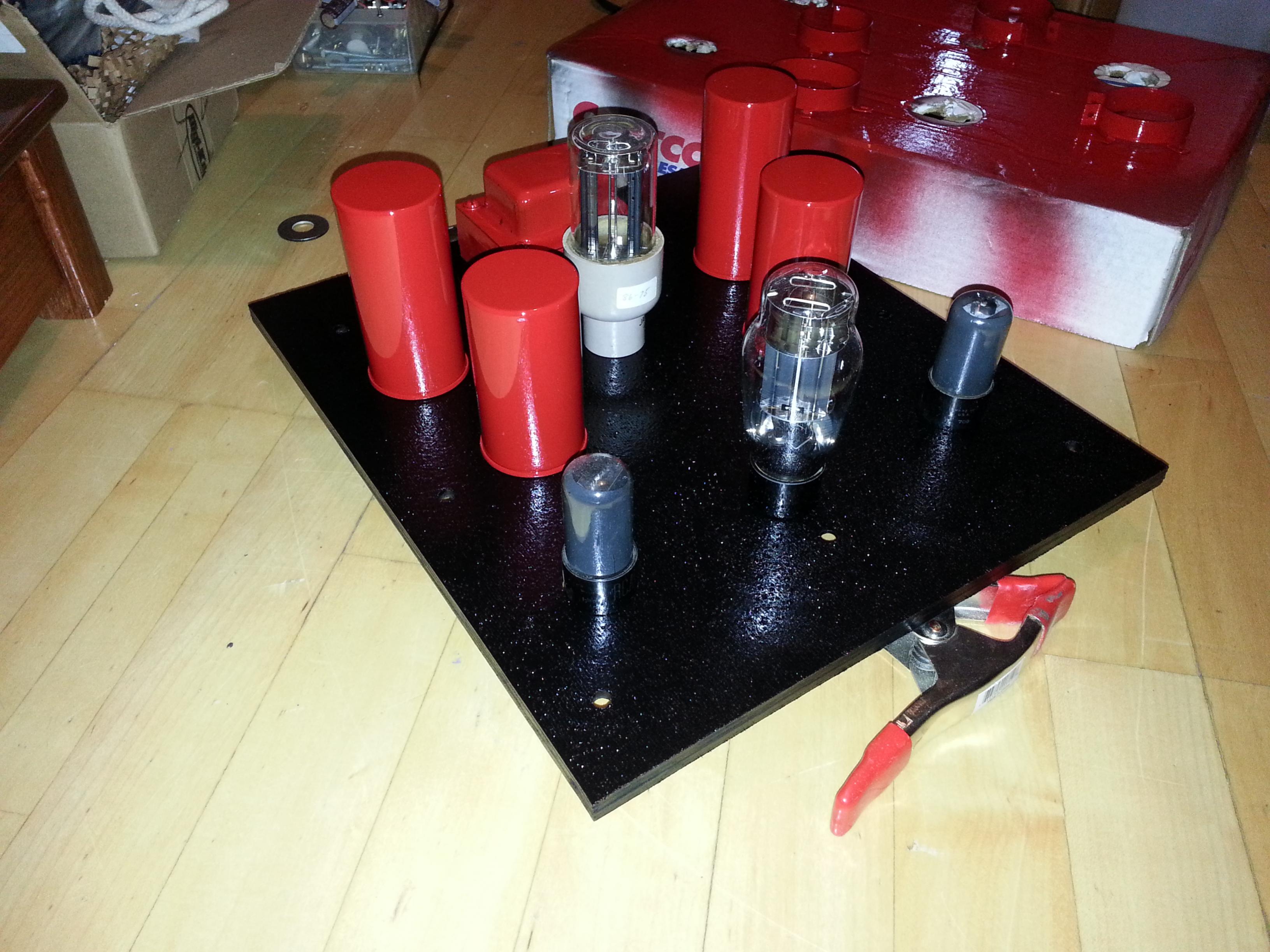

Hey fellas,
Just an update on my build... top plate chassis is almost done... the middle tube between the 2 6v6 is just for probs as underneath it will be an ldr volume control...
Do I need to.elevate the heaters? My b+ estimate is 330v to 340v? How do I calculate the.voltage divider to getthe right.voltage? I.aapologize for.all.the.questions...

diyAudio Chief Moderator
Joined 2002
Maybe, depends on the wiring and what comes in from source. If you will hear no whistling its probably not excited by inductance yet. If you got a smaller value than 1K in hand use it. Solder it directly on the grid's socket pin with a short trimmed lead.

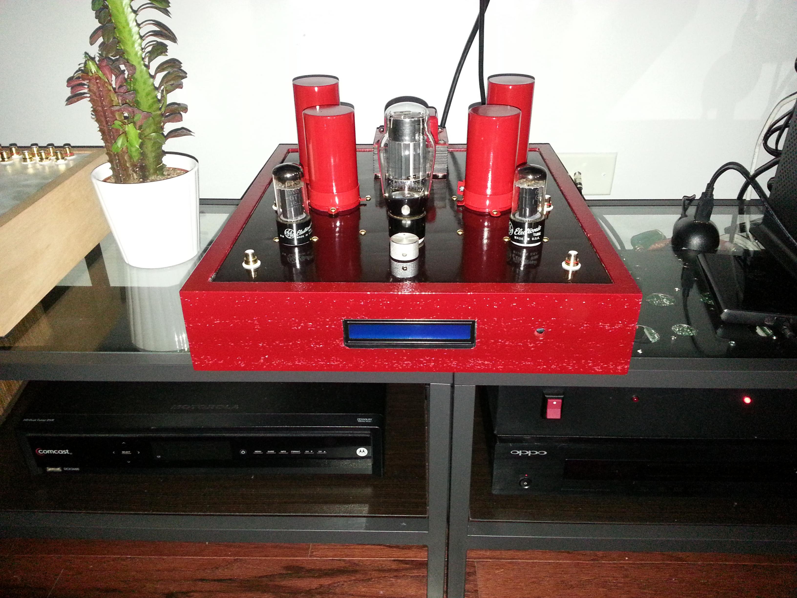

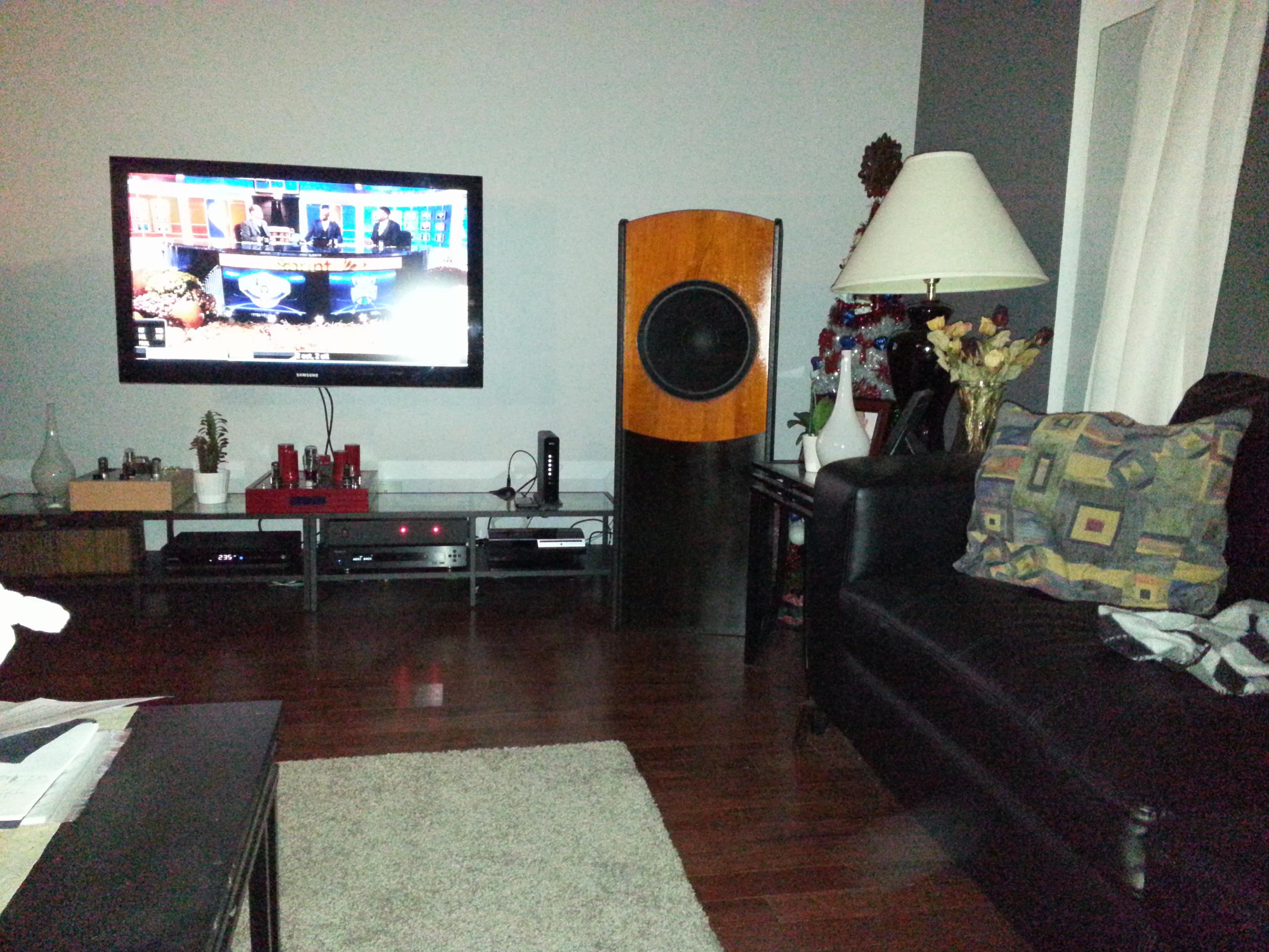

Hello guys,
Salas, thank you... and thank.you all for the guidance and help... I finished the preamp and it sounds amazing.. wow... it is very natural and dynamic... I have a lil hum and hiss but very much tolerable... im using ac heaters and elevated it to 33vdc... also my power suppl is clc.... 0.22uf to 20h to 1000uf to15h to 470uf....
The sound is phenomenal.... made my.class d icepower amps come.alive...very rich tones, right timbre, and soinds big and effortless....
Thank.you.guys again...
