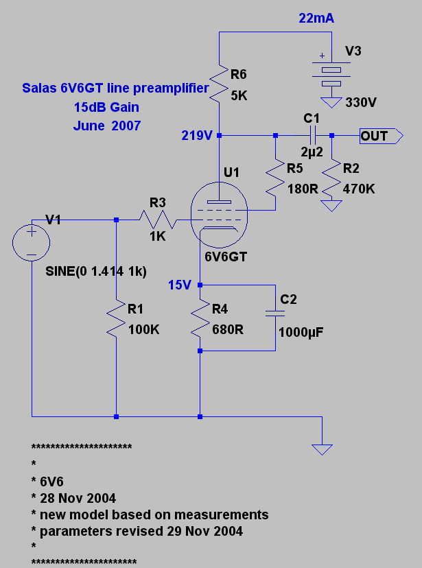

Such anecdotal info comes from using 6V6s in power amplifiers. In our case you would need the quieter ones. This is weird what we do here, using a power tube for a line preamp, changes things. The Tungsol 6V6GT (Russian made reissue) proved both good for vibrations and sonics IMO. Suspend or soft rubber decouple the tubes on a small sub chassis, it pays off. If you have enough gain for your amp in the chain, utilize the bootstrapped cathode follower, much less susceptible to vibrations or for heaters & anodes heating up noises.
P.S. Here are some check points for you as for DC bias. Having measured it with enough 6V6GT I can say that the LT Spice model kindly provided by Robert McLean absolutely complies for bias and gain. Most tubes measure ''well near there'', some are spot on. R1 is substituted by the volume pot in the real preamp of course.

Yes, I´ll test the CF first., which BTW I´m not very fond of those with my short experience with other tubes. Have you tested output impedance for this configuration? Or have an estimate?
~200 Ohm. Teflon 0.1uF/200V input capacitor is highly recommended. Even 0.022uF will work due to the extra high input impedance of the bootstrap (post#144).

True for the cap foils are ''biased''. Still the Teflon was superior for clarity in this one after I tested some caps. Don't imagine anything extravagant money wise. CCCP NOS FT-1/2/3 are perfectly adequate.
Don't be sure before you test. The rough guideline would be they bias at 22-25mA in these circuits here with ~200V developed across them, that you will see 0.0xxx THD for 2.82V PP out, and microphonics will be tolerable in line pre duty.
