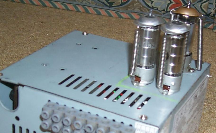

PSU
Thanks, the old PC PSU made quite a good valve PSU case all in all.

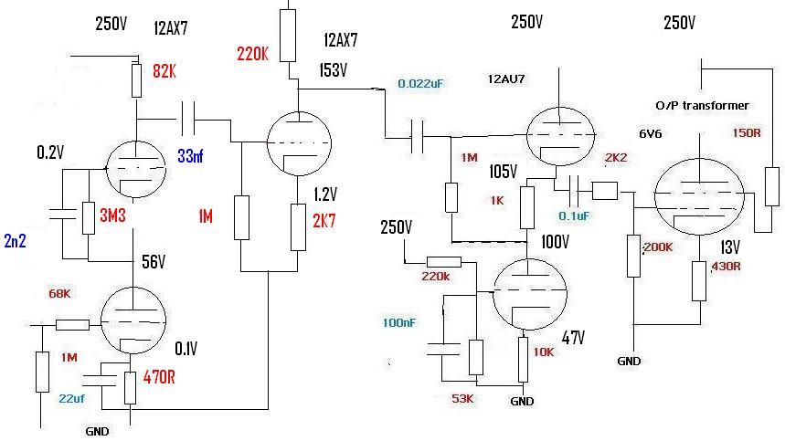

I have finished the amp today (ive been slow, ironing out noise issues etc).
It has a gain of about 385 and works fine with a signal generator driving it.
Although when i connect my guitar to it i cant hear a thing, i put a distortion pedal in between at max volume and i do get sound but its not very loud.
I think the input cascode is improperly biased, the cathode voltage of the first tube looks far too low?
I dont really know how to start calculating values for this stage :xeye:
The rest seems alright to me, 5mA in the tube buffer stage.. is this enough to get the most out of my 6V6?
Craig

Craig405 said:
Any ideas guys?
Do you think the cascode needs biasing better, if so how do i go about doing it. Do i use only 1/3HT voltage on the plate of the lower tube to get current and bias? how do i get the anode load resistor value?
Craig

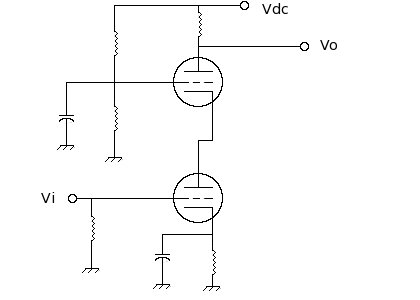

If the circuit diagram in the other post is accurate, it's no wonder you don't hear anything. With 0.2Vdc on the grid, and 56Vdc on the cathode, the upper half of your "cascode" is way into cutoff. Also, I wouldn't use a 12AX7A as a cascode anyway, as this type has a very low g(m).
The cascode requires a voltage divider to set the voltage at the grid of the upper triode, which, in turn, sets the voltage at the bottom triode, less the required bias voltage, of course. The control grid of the upper triode also needs a good bypass to AC ground since this is a grounded grid configuration and will oscillate nastily if there is too much impedance between the grid and AC ground.
I, personally, wouldn't build a cascode from a 12AX7A. I'd use something like a 6BQ7 which was designed for this very purpose. It has a much higher g(m) that doesn't collapse so quickly with reduced plate current. Although it does like a rather higher than normal Vpk for good linearity.
I have a "white paper" on designing these on my HD that I could e-mail you (can't find a link -- maybe it doesn't exist anymore?)
