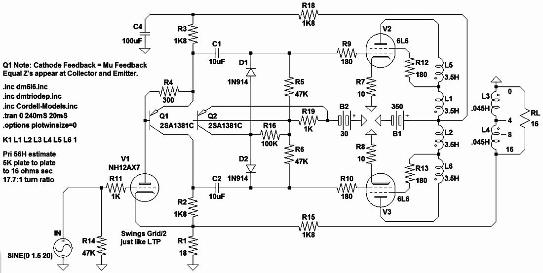

Mosfets aren't the only way to drive AB2 without blocking.
PNP splitter is another interesting story. But this deblocker
averages the bias, compares it to a reference (BE voltage).
If average bias is found to be too low, it pulls up only the
grid of the tube presently in cutoff.
Never built it, so take with a grain of salt.

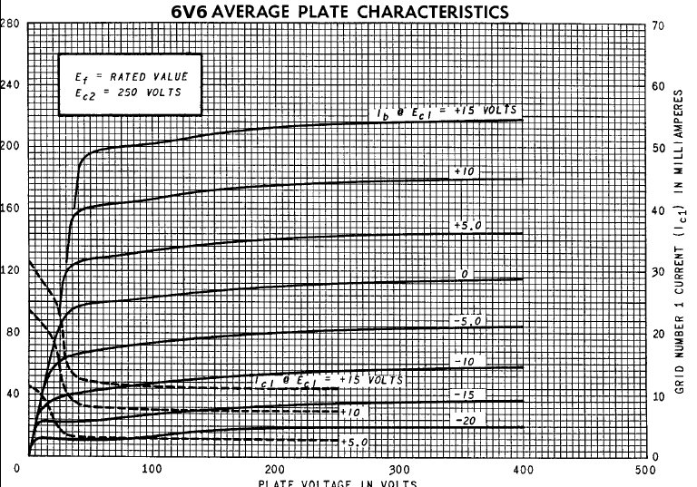

Can the 6V6 be operated in either A2 or AB2 without any issues? The reason I ask is because I have plenty of 6V6GT and 6L6GB bottles but I only have the iron for 6V6. I have a 330-0-330 power transformer w/ 5V and 6.3V taps and push pull output transformers 8k/8ohm.
Of course it can. The spec sheet has a plate characteristic that goes +15V above the VGK= 0 curve (attached). 6V6-oids have also frequently been used as Class C power amps, either as drivers or frequency multipliers.
You'll need a Class AB2 loadline, as the RCA manual doesn't provide any examples of this.
Back in "the day" Class *2 wasn't favoured for audio amplification since they didn't have MOSFETs for grid drivers. Also, you can get as much, and more, audio power from different types that can stay in Class A or AB1, so I don't suppose they considered it important. Unlike the 6L6, there is no "RF" 6V6-oids comparable to the 807.
Draw up a loadline and go for it. These days, grid drivers aren't a problem.
Yes, it was not a choice back in the days because of plenty of "easy" alternative solutions for that sort of power output. A 6V6 will draw a lot more grid current than, say, a 45 when driven positive. However the voltage swing is a lot less than a 45 and so even a carefully designed CF can be good enough.
