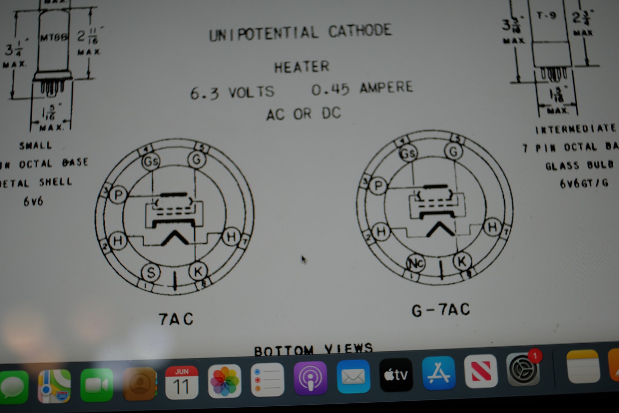

The 6V6 is a Beam Power Tube.
Some data sheets have the correct diagram, some do not.
There is no Suppressor Grid (no 3rd grid).
Instead, we have Beam Formers.
There are too many different names that are used for a single device type, it confuses the issue.

Beam Power Tube:
Filament and Cathode
Control Grid, g1
Screen Grid, g2
Beam Formers
Plate
1,2,3,4,5
The beam formers only allow electrons from the cathode to flow to the plate in designed/prescribed shaped "Beams".
On some Beam Power tubes, g1 and g2 have exactly the same number of grid turns and grid wire spacing, this also creates "Sheets" of electrons.

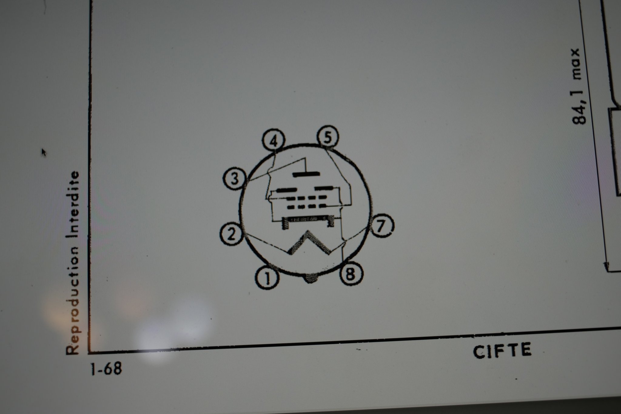

The original 6V6 was a Metal tube, and Pin # 1 connected to the Metal. The metal acted as a shield around all the elements of the tube.
The glass versions did not connect anything to Pin #1 (no shield)
All 6V6, metal and glass, connect the beam formers Internally to the cathode.
Manufacturers got lazy, and used a Pentode connection drawing instead of a Beam Power drawing.
I am attaching 2 photos of Correct Beam Power tube drawings for all to see.
