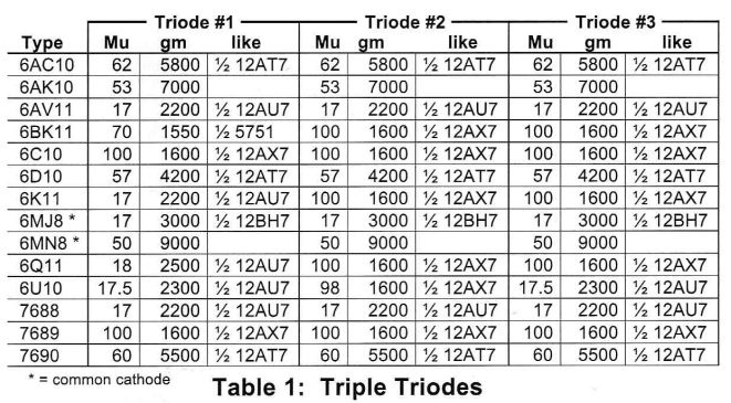

Greetings,, Are the above titled tubes, & others like them, interchangeable in the precise sense the 12**7's are swappable with a resulting change in gain? Or is there too much 'other' stuff going on in those compactrons? In particular, My Ampeg
AC-12 calls for a 6U10, as do many, many Ampegs, and I wanted to know if the other Compactrons mentioned are drop in substitutes that may offer different, or more, amounts of gain?

There is no 'other' stuff going on in those compactrons.
6U10 equivalent to 2x 1/2 of 12AU7 + 1x 1/2 of 12AX7​
6AC10 and 6D10 both equivalent to 3x 1/2 of 12AT7​
6AV11 equivalent to 3x 12AU7​
Except for heater voltage which is 6.3V only in these compactrons.
However 8AC10 and 12AC10 etc etc etc also exist.
