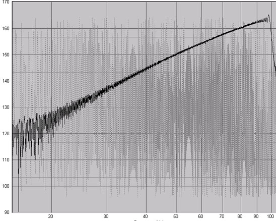

that thing i stated above, i tried it today with 3 different apps,
winisd pro
winisd
and jbl speakershop
they all give me some strange results..
winisd pro tells me that a bandpass setup would suck compared to vented box..
winisd shows that a bandpass system would be a better size/performace ratio than vented
and jbl shows some very strange stuff....
any ideas wich one should i trust?

Basically, I wouldn't trust any of them, because of the wierdness of your parameters.
I tried modeling this woofer back in the first thread you started. I used Bullock and White's freeware DOSBOX which, while a DOS program, still accurately computed such things as SPL from the parameters. DOSBOX came up with an SPL, all right, but had to change your Mms parameter to do it.
Then, of course, we tried using the parameters to calculate SPL ourselves. The woofer, by the manufacturer's own stated parameters, is .24% efficient instead of the manufacturer's stated .4% efficiency.
On the same chart where the manfacturer tells us the woofer is .4% efficient, the manufacturer lists other parameters that gurantee the speaker CANNOT be .4% efficient.
Apparently, a woofer with this particular combination of parameters cannot exist in the real world, and that is what is driving these programs nuts.

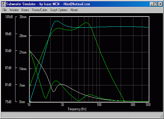

Here is the model using Subwoofer Simulator. This is running at 50 watts. I had to make a BL product rating, (unstated in the chart), to make this a smooth curve.
Okay, here is the vented system of 6.5 cu ft and the bandpass system of 3.7 cu ft compared in Subwoofer Simulator, a great freeware program by our own member F4ier.

The shape looks a little different, but if you check the markings, you see the variation is not any greater than the other programs'.
I included cone excursion for the two systems. Both for frequency response and cone excursion, vented is in white, bandpass is in yellow.
This system is run at 30 watts.
A few observations. First, it is quite useless to build any system that goes down to 20 Hz with this system when your cone excursion is only 4 mm. As you see here, the cone excursion required even at 30 watts is twice your stated cone excursion. And 102 dB is not really hearable at 20 or 25 Hz-you want more than that to be worth your while. Now you know why Shivas and other fine subs have linear excursions over 12 mm.
Does your various programs have a place to fill in the Bl product? The Bl product is unlisted in the chart-but if you put it in, (assuming your program lets you do that) at a value of 13 Tm, I'll bet you will see a curve that is reasonably smotth. The smaller the Tm, the more irregular the response.
Your simulation shows something remarkable that I will explain later. Meanwhile, try inputting that 13 TM value in your various programs and see what happens.
The program where the enclosure worked well probably input a value of 13 Tm automatically, since it is not a spec Max speakers gives us.
