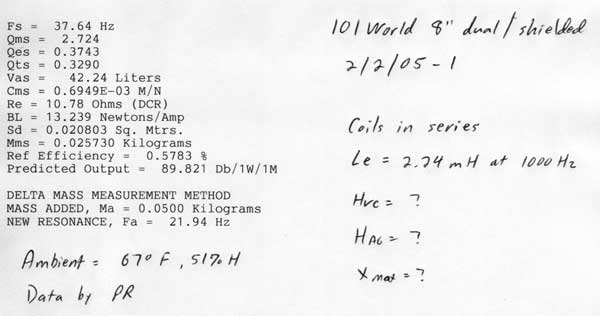

I have all information of this little subwoofer but I just don't understand why the REAR and FRONT chamber have not the same volume in 6th Order Bandpass ?
One chamber in 6th order box acts just like a classic BR box, so it needs to be BIG for your sub to play low, while the other chamber acts as a lowpass filter and doesn't need to be big because it is tuned fairly high in frequency (as high as you want your sub to play).
You can make the second chamber as big as the first, but there is no purpose doing that because it won't bring you better or deeper bass, you'll just have bigger box and ridiculously short port on that chamber.

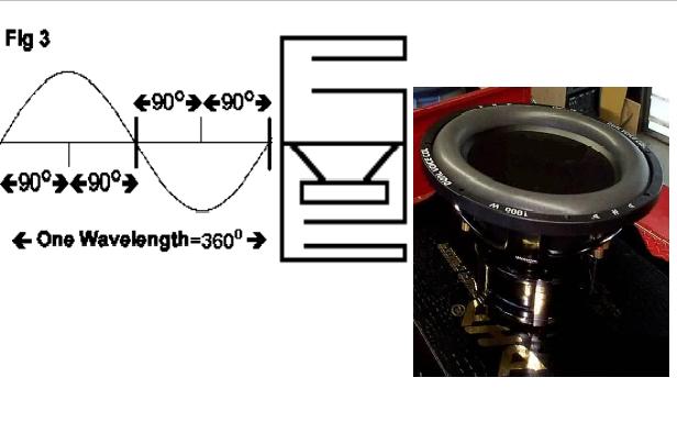

For my 360 degree history, it's difficult to explain so here's a picture of my brain
For me the BEST AUDIO reproduction is :
* Class-A amplifier to reproduce all the 360 degree of wave.
* Flat cone speaker to reproduce almost the same 2 phase of 180 degree to create best 360 degree (I say almost because the driver don't have 1 motor by side) I understand me I'M NOT CRAZY :smash:
* For this reason I don't undertand why the 6th order bandpass doesn't have the same box in her 2 chamber
:angel: Thanks !!!:angel:
nicK 🙂
With a sixth-order bandpass you have one 2nd order bandpass (i.e. tuned box) in front of your woofer and one on the back.
The woofer outputs the same signal on its front and on its back. If these are summed as is then you will have no sound - they will simply cancel out. The same happens if you use any form of waveguides or resonators or whatever in front and on the back of the driver. If these are equal then the output is again nulled out due to the fact that you feed both of these contraptions with the same signal but 180 degrees out of phase.
It is getting interesting as soon as those resonators are tuned differently. Not only do you load the driver over a large bandwitdh (whatever large means) - the difference of the inherent natural phase-shift of these resonators adds another 180 degrees, helping to add the SPLs of the front and back efficiently.
