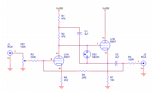

Taking the excess gain (along with extra distortion) and then throwing it away might be the least attractive option. You could reduce B+ and reduce the anode load resistor instead, but you don't want reduced B+ for the cathode follower. I would split the anode load and bootstrap it from the CF, and then add series input and feedback resistors to set the desired gain. Make an augmented anode follower, in other words.

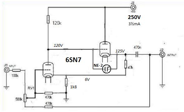

Try simulate this.Gain between 9x to less then 1x 🙂All great advice!

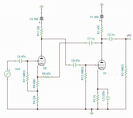

It has positive feedback to get the open loop gain up.And the negative feedback set the gain.

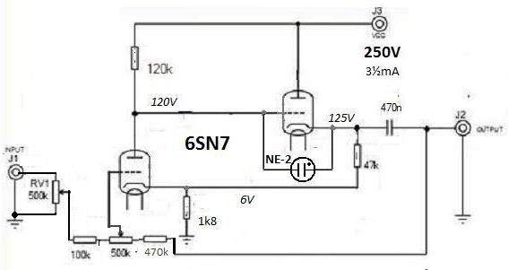

Where would you put the volume control?

Didn't now he need one 😕Where would you put the volume control?
But if you insist 🙂

Here's the augmented anode follower (shunt feedback) concept I was blathering about earlier, fleshed out for gain of roughly 6 and including the neon safety device. R6 may need a little adjustment to achieve something near 150V at U1A anode. Performance might improve slightly if R6 is bypassed, but bootstrapping will make that a small effect if it exists at all. Output impedance should be well under 600R.
