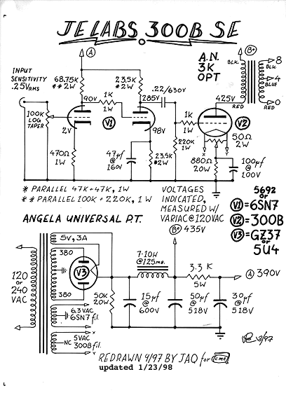

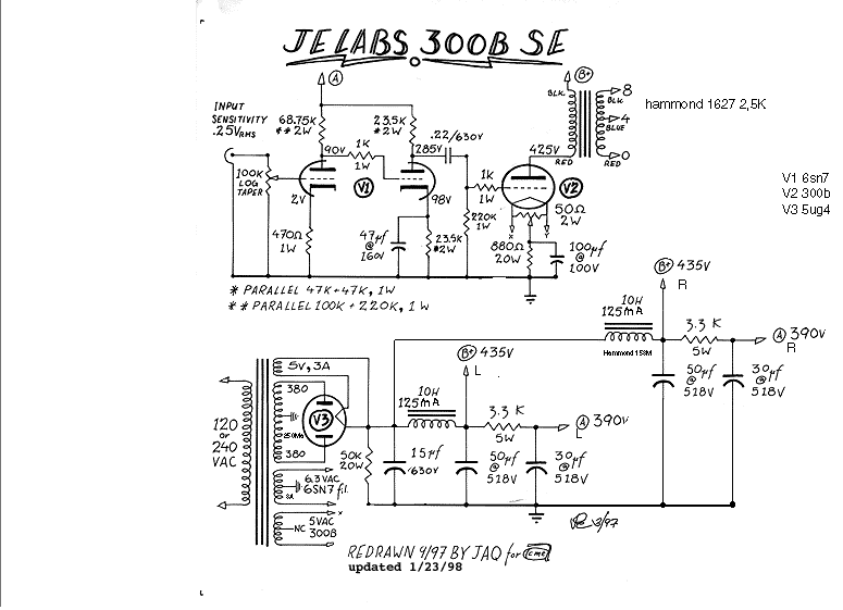

6SN7 pin 4 signal input
The selection of triode #1 vs triode #2 is purely a function of physical circuit layout. This is true for almost all twin triodes. The 6DJ8 is one of the rare exceptions, because its two sections have different heater/cathode insulation ratings.
Can you post the schematic? You can use either section if the plate, grid, and cathode
of the chosen section are all properly connected (and the filament also).
This is the circuit by JE Labs.
