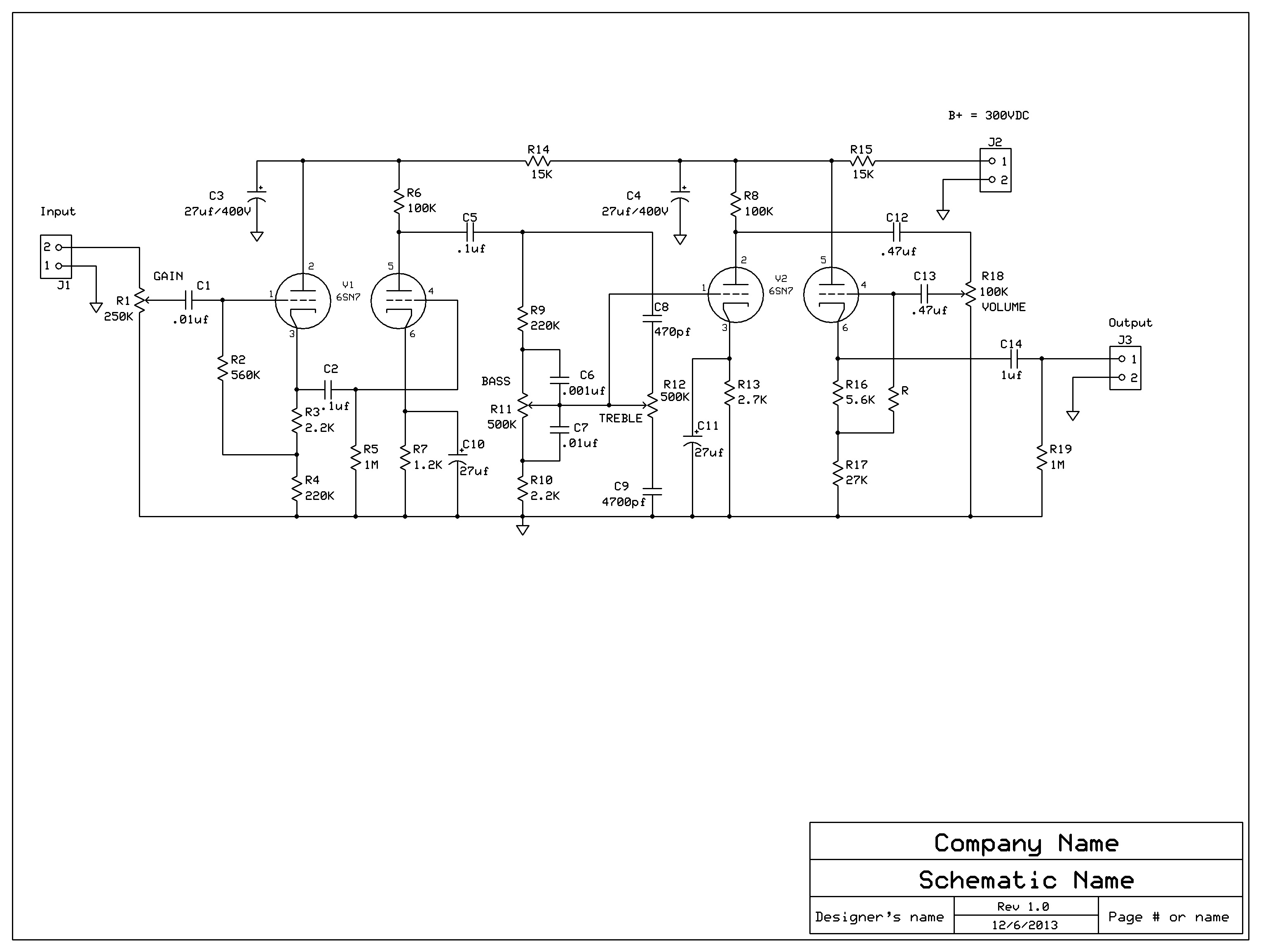

No problem at all. It was recommended that I should use R24: I felt it was needless and far too low, but I followed their advice and didn't act to delete it. In practice I wouldn't bother with a resistor there. The relatively large capacitors C11, C12, and C13 were calculated and modeled to reduce the phase shift as much as practical, not for bass extension. R20 and R21 form a potential divider, and this could be substituted for a fixed value to set the gain for a solid state amplifier and it should be padded. R22 is just used to keep the output referenced to ground, and R23 represents the final load. What you pointed out about the grid and a 220k resistor- thank you, it slipped by me when I made that first diagram. I changed the schematic since then and I likely hadn't noticed this older one contained that omission. Most of the updates are obvious values for a more linear phase, and some improved B+ filtering.A few comments on that schematic posted by Kouiky (no criticism intended, perhaps just an erroneous sketch).
Firstly I would leave out R24. It will influence the rotational 'law' of the tone pots, loading them too much. You have a d.c. grid path to common via R8-R11-R12. If you feel better with a grid return resistor, increase R24 to at least 2,2meg.
Then I am missing a grid resistor with U4; G1 is shorted directly to the output. There needs to be a resistor from G1 to the junction of R18-R19, not a short. Say a value of 220K.
Then what is it with the overly large values of C11-C12-C13? Better bass? Someone put those values (4,7µF) in without calculating. If you use the suggested 220K resistor from G1 to the junction of R18-R19, C11 = only 10nF will bring the -3 dB point to below 10Hz.
Similarly with C12, C13. C12 = 1 µF will bring the -3 dB point below 7 Hz when feeding the output into only 22K. Any lower next stage input impedance will begin to compromise the cathode follower output at any rate. Similarly C13 = 330nF will also bring the -3dB point there to <5 Hz.
Finally I cannot see the necessity of both R22 and R23 (in parallel). You may leave R22 (1 meg.ohm if I read corectly) out.
Sorry for appearing to nit-pick, but this is how I see a practical design, with some saving in components/cost.

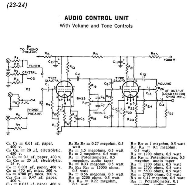

Marantz 7 line stage with tone controls
Here's Marantz 7's way of doing tone controls with simplified schematic with output gain control bypassed. One channel shown.
Johan Potgieter, in your opinion, how would you go about reducing the high frequency phase back near 0 degrees? Right now it is about -12 degrees with tone set flat.
SORRY!
For some reason (not after-Christmas effect) I have missed this request. I am also at present unable to open the last diagram you have posted. Further, you appear to have solved the problem to your satisfaction.
If still of any relevance: I strongly suspect that the -12° phase shift you got had to do with potentiometer inaccuracy. Dual log pots are notorious firstly for poor tracking, often differing by a quite audible degree somewhere at the middle setting. Secondly, they often do not have an exact logarithmic 'division' when in mid-position. (Meaning that for a 470K pot one will have exactly 47K to one side and 423K to the other.) There are also capacitor tolerances. My apparently flippant advice would be: set the pots until you do get near 0° phase shift! That would in fact simply mean that at such a setting you are closer to the mathematically correct ratio than at mid travel of the spindle.
This might be partly bourne out by the improvement experienced with the Marantz circuit. Those taps are exact to the degree of capacitor/resistor tolerance, probably a whole lot better than with a pot setting. Also (might be old hat) usually one finds better tracking/accuracy with linear law pots than with log. In that sense the Baxandall type circuit is more satisfactory.
