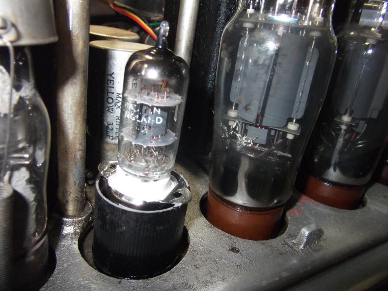

I tried it with an ECC33.
I just made an adapter and tried it in a single triode phase splitter and voltage amplifier.
It made no difference to the sound or evenness of clipping when driven over full power.
Being over the other side of the ocean the trial tube was a 6/30L2 however an ECC83 could be tried.
The vintage amplifier can be restored to original in seconds with an adapter.

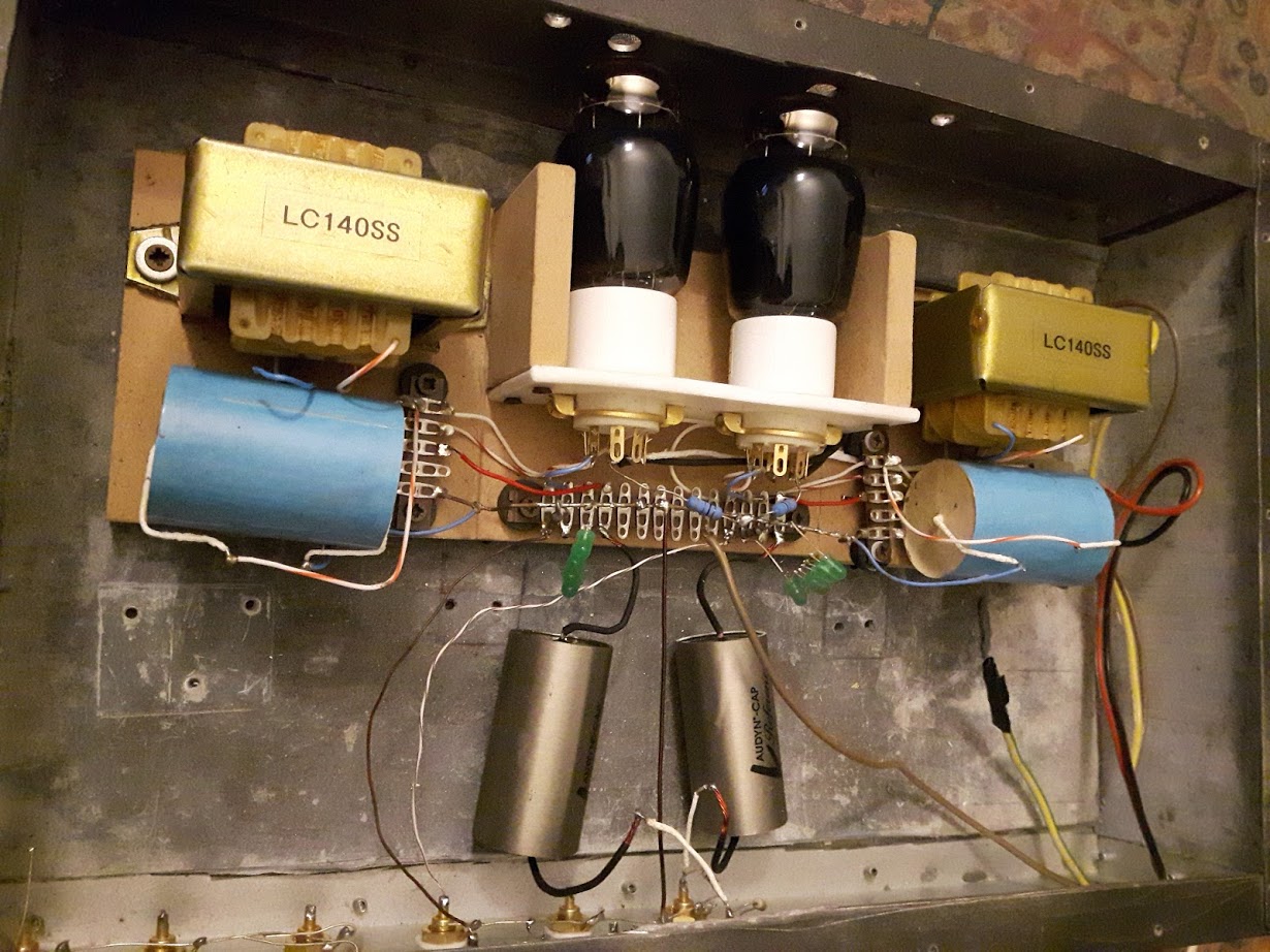

Ok guys thanks for the replies, I am using a quad of 6J5GT's now with an adapter in place of the 6SN7 tubes, this is in Rogue Magnum 99 pre amp. A friend told me look into the 9 pin miniature tubes as a replacement.
