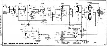

The RC values in the OP's circuit (has it mysteriously changed?) look about right to me.

what values in the circuit?
some of them are just placeholders.
Coupling caps + grid leak resistors. Time constants look fine by DTNW criteria.

The part values are not accurate at all and just tossed them in as place holders. The circuit is not mine by any stretch, but a mashup of a couple of amps I liked.
Power supply will likely get a revamp as well, again, all of this was just a very first pass to get a schematic into the system. I have not worked on it for months, but once I wrap up an the almost finished EZ10 project I'll be jumping back on it.

what benefit will you get from setting up that 6sn7 driving the k88s like that.
why use 3 6sn7's? is it necessary?
Rubin -
My understanding is the Cathode Follower is useful for driving low impedance loads, my guess is that driving paralled output tubes this is a good thing. (Others feel free to chime in with pro/cons of CF in the driver).

Ah, a Williamson. That certainly is a time-tested classic.
I've always wondered if it would be an improvement to replace the V2 6SN7 with something like a 5687 or a 6N6P, with a much lower rp (for lower output impedance).

pretty much a simplified version of the GEC PPP 400watter.
doesn't the last valves filament need to be raised to cathode levels?
another thing, this circuit whould run the same regardless if there are 2 pairs on the output, or 4 pairs. just with reduced output power, (if transformers are adjusted) Kt88 tubes ofcourse.

No, they can handle a certain amount of voltage between cathode and heater. Look in the datasheet. On the other hand, it is a good idea to raise all the valve heaters to somewhere between 1/4 and 1/3 of the supply voltage (plenty of references around).
In my opinion, this circuit can drive more than one pair of KT88, due to the low rP of the 6SN7.

oh silly me forgot to swap out the transistors for a triode pic.
the program im using doesn't have tubes, so why not just use the transistor symbol instead 😀
circuit lab is nice for being browser based with online save and PNG convertion.
i am thinking 2 pairs, (4 valves) might add more but might be risky since im going to swap between triode and UL mode.

The GEC PPP 400 watter looks to be a Williamson with cathode followers after the push-pull driver.
it pretty much is, so low distortion is expected.
i highly doubt that the cathode follower makes adds any distortion since
you are basically taking an ultra low distortion tube and throwing an huge amount of negative feedback at it.
The cathode followers would be to drive the additional Miller capacitance and strays from paralleled pairs of big KT88s and the additional stray capacitances from the extra wiring.
The problem wouldn't be distortion, it would be stability (possible oscillations or ringing). Power supply would need to be carefully checked. Care would need to be taken in implementation of the feedback loop.

From reading Morgan Jones' breakdown of the Williamson in "Valve Amplifiers," and from the original Williamson articles, I gather that having so many RC-coupling and OPT time constants inside the feedback loop can cause high frequency instability. The lower the quality of the OPT, the more likely instability becomes.
At the same time, the low frequency time constants of the RC-couplings and OPT can wind up 180 degrees out of phase with the time constants of the power supply decoupling, which can cause subsonic oscillations ("motorboating").
So you have to be careful of all of those things when designing a Williamson circuit. I figure the addition of yet another stage (the cathode followers after the LTP) only increases the chances of these oscillations occurring.
