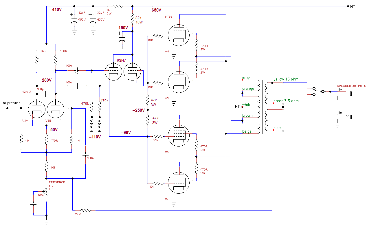

6sn7 driver question
Seems doable.Supply a bit high for UL and drive voltage from the 12AX7 is barely enough, so the hole thing is on (over) the edge 😱.
You need a neg supply 250V 6mA .And a pos 150V evt obtainable from the +B with a single resistor, sum of the anode currents is constant.

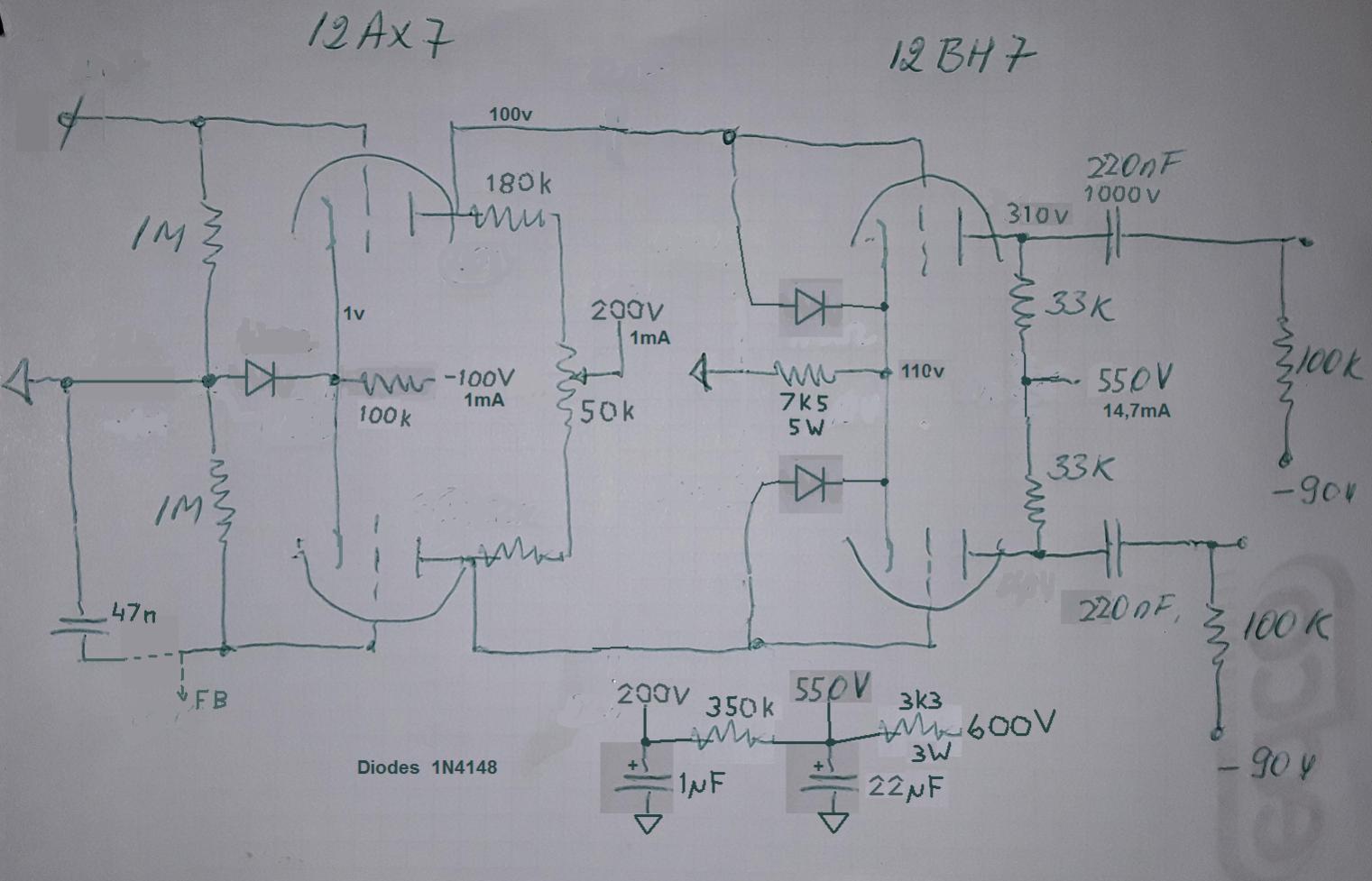

Wow! Thanks Ketje.
So, You suggest a buffer than a voltage amplifier instead.
My mind was to use some more like 12bh7 (it seems have little better excursion), for instance in common cathode mode , with a 33k on the plates as voltage amplifier. But what do I know...? I.m not able to design a working functional circuit. Thanks
Think something more like this:
It will work, please ?
Probably yes, you coupling caps are a bit small, would double them.
Here an other way.
For the 1mA first stage 100k with -100V, just an example.If you have -150V use 150k.
The diodes are only for protection at start-up.After that they are blocked as if they aren't there.

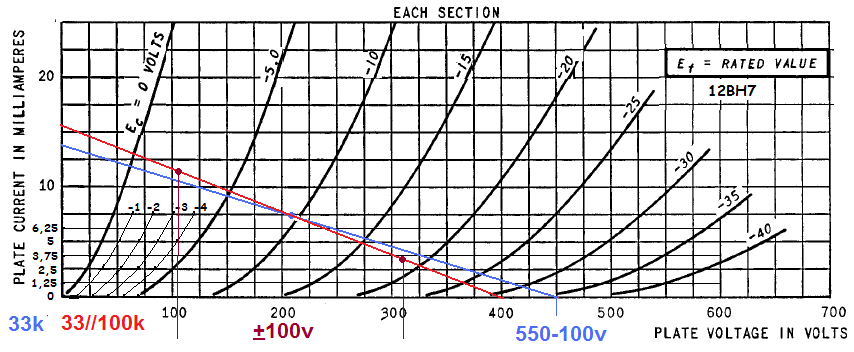

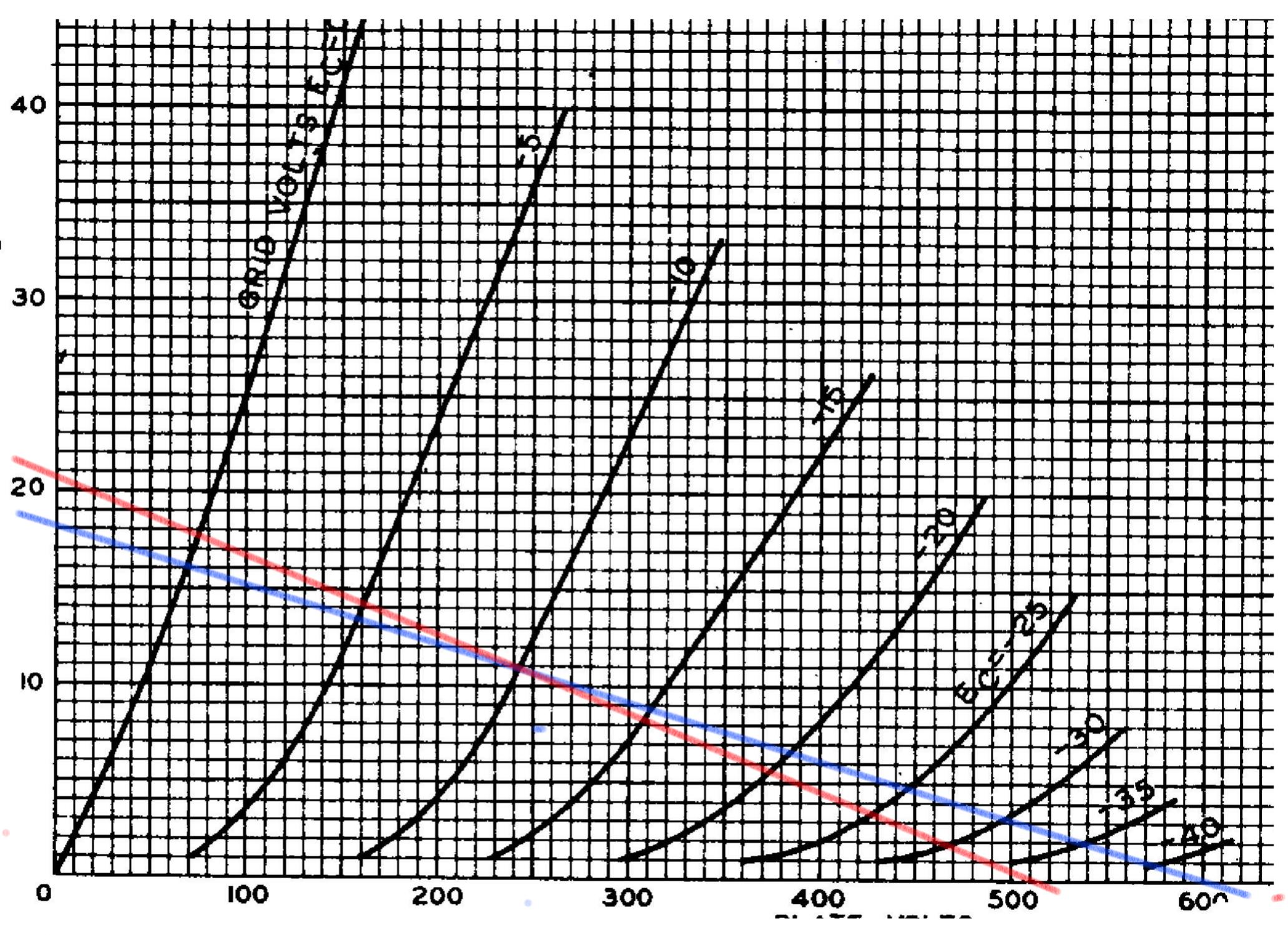

From GE 12BH7 A I noticed from characteristic and typical operations in respect with class A amplifier each section : plate voltage 250V , grid voltage : -10.5V, plate current : 11.5 mA.
Don't think is possible to track a line through that point with a decent load for a supply voltage less than 500V

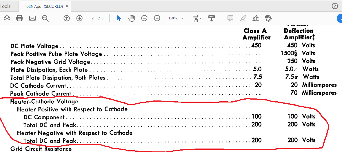

Glancing at the schematic on the previous page I would direct couple the input and driver stages, replace the 490R "tail" on the driver LTP with a far stiffer cascode MOSFET CCS and replace the driver stage plate resistors with a CT plate choke. The choke can swing higher than the B+ and doesn't dissipate voltage like a resistor.
GE data gives 1500Vpeak as the absolute maximum.

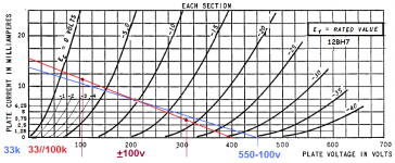

So will not be any problem to supply at 600v resistor loaded as time the dc plate voltage will be fixed within 300v dc ? Am I wrong please ? The operation point will be fixed at 250v around and it will swing positive till 400v dc + ac. Supplied at 600v will give the possibility to get 100v rms output which is fine.What is wrong with that I try to understand, please?Thanks
According to GE the tube is ment to be used in an vertical deflection output stage.There you get signals like this
attachment.php
So, for your application i see no problem.

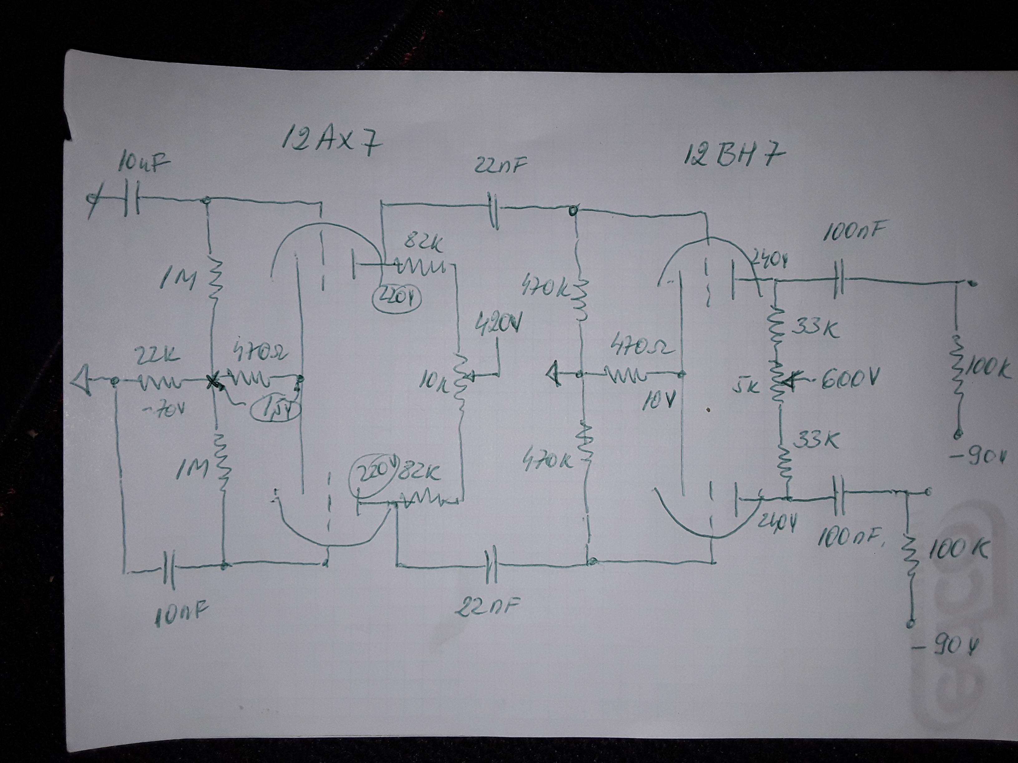

Interesting stuff, I'm mucking about with quad of 807's UL PP AB1 at present, which as suggested previously takes some driving, I've been pondering direct coupling, so some questions that might help the OP and clear up a few queries for myself.
I've been using Russian 6H8C's and have searched for an octal 12BH7A equivalent but never found a suitable candidate, is there one?.
Williamson type amps used a dedicated 6SN7 common cathode gain stage driver instead of a KF. Which approach is better? I've read various threads disparaging cathode followers but never really found a reason why.
If RC coupling is used say for a paralleled OP stage is it better to use two coupling caps as per normal or one coupling cap per valve?
Lastly for difficult driver stages such as this which is better on the whole, valve KF or Mosfet Source follower?
All of these extra stages obviously increase the chances of instability another aspect that needs bearing in mind.
