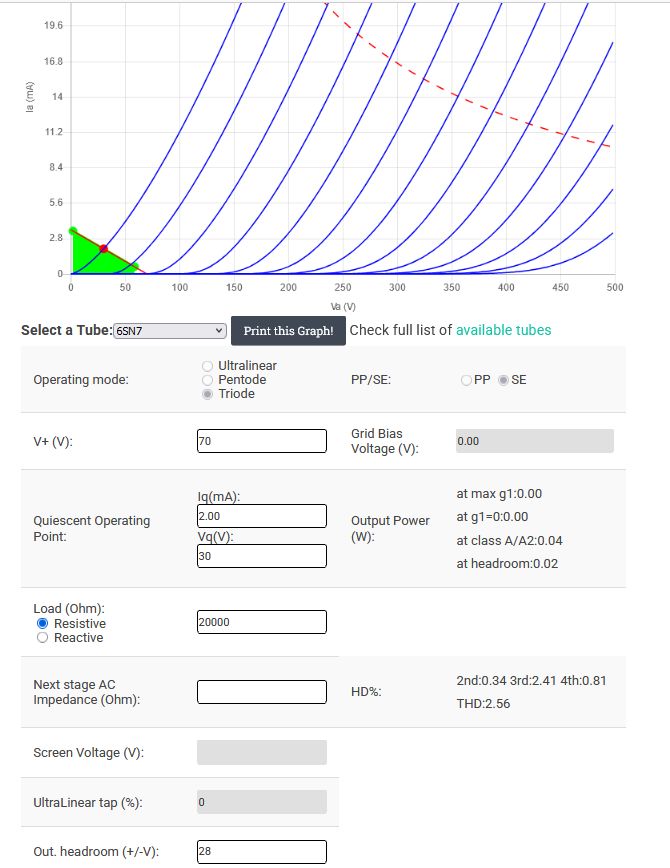

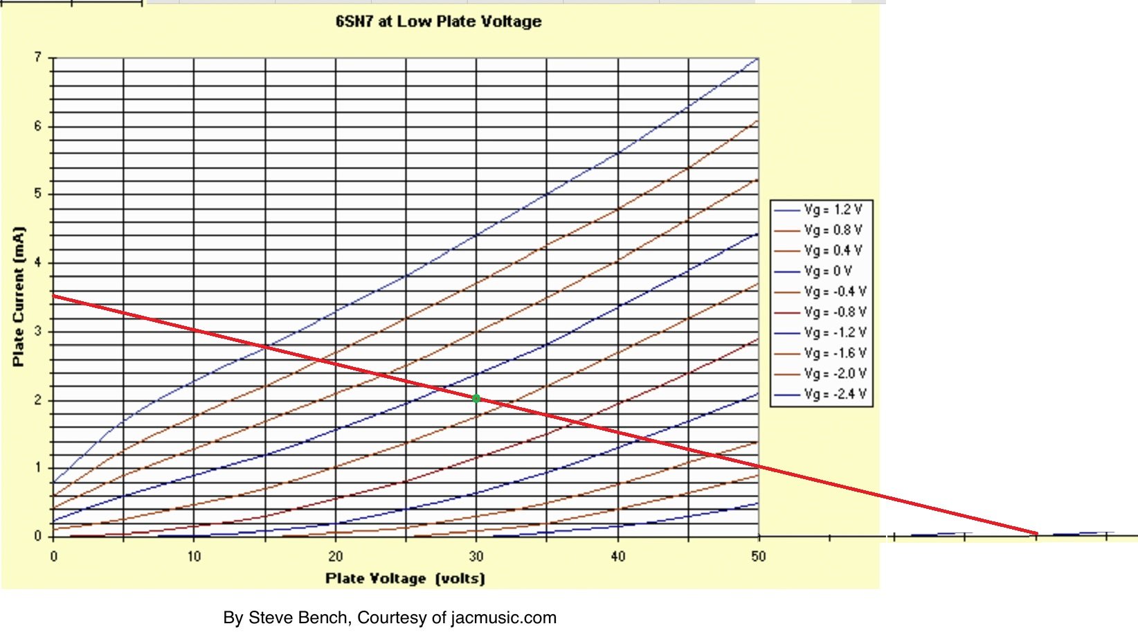

If you use 6SN7 at about 2mA, the Rp about 10-12kOhm, the recommended plate load is 20-24k.
On this load the voltage drop (Rload*Ia) about 40-48V.
If you use 30V, 2mA operating point (with 20k load), the bias about -0.2V, the B+ about (30V+40V) 70V.
The grid driving MUST BE capable A2 mode, so must to push to grid even few mA current.
The estimated output swing about 32Vpp .... with not so little distortion.
BTW what's the goal of using 6SN7 in A2?

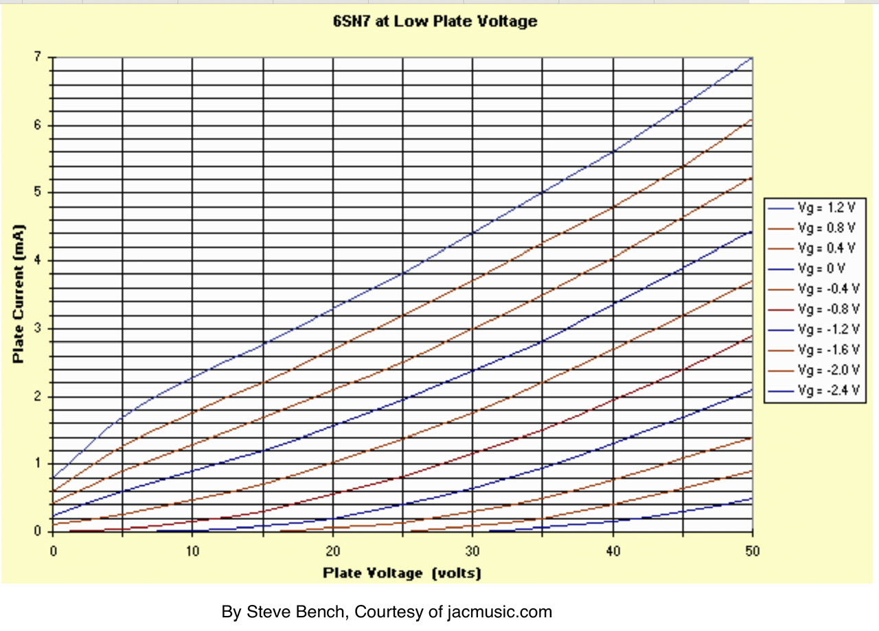

There is also a 12SX7 , a 6SN7 variant with 12V heaters only and with specs and curves for low voltage operation.
Although Tung-Sol claims "specially designed for low voltage" it also lists the same high voltage data as for any 6SN7.
