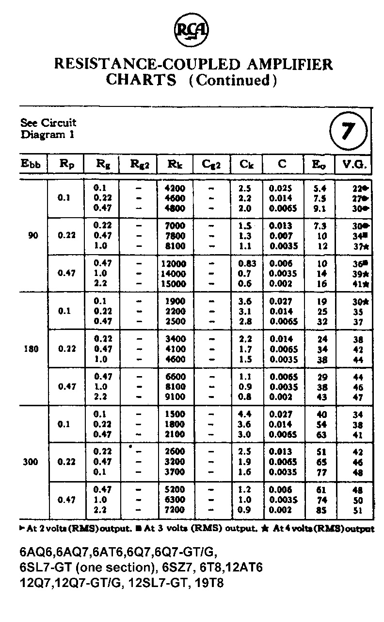

I would take out the 100uf 6SL7 cathode bypass capacitor. The input clipping voltage should go higher with that. Put in some NFB if you want to increase that some more. The Clipping is caused by the 6V6 going into A2 mode likely.
Is it not like audiowize already wrote in post #2?
The gain of the stage is about 34. The maximum output voltage (before crossing some distortion limit they use in the RCA Receiving Tube Manuals; see post #6) is 40.
34 x 1.2 = 40.8
Addition/correction: It's probably all true (go over 15 V output, than grid current of the 6V6GT; apply GNFB; etc.).

Yeah, so hard to tell what exactly the problem is here. Is the 6V6 even plugged into the socket? Is the NFB connected?
One thing is puzzling me though. If the 6V6GT is in its socket, would the grid current not cause clipping far before you reach 1.2 V at the input? In the schematic, the GNFB is not connected.
