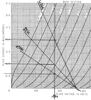

I've completed a fixed bias 6V6 Ultralinear plus Cathode Feedback Push Pull Amp for a niece. It runs a current source biased 6SL7 diffamp front end with direct coupled MOSFET source followers to drive the 6V6 grids.
HT + to the diffamp is 270V with the current source tail returned to -20V.
I started with 47K Anode loads on the 6SL7 with 2mA per side.
- It sounded nice, warm, round BUT a bit covered (too much 2H distortion?)
I changed to 82 K anode loads with 1 mA per side
- This sounded less covered and more detailed with some additional top end.
This encouraged me to go to 150K anode loads with 600uA per side.
- This sounded even more detailed and brighter with maybe a little edge stating to creep in (too much 3H distortion?).
Is this just a function of the anode loads getting larger with respect to rp of the tube and therefore less overall distortion?
Is the edge in the 600uA per side due to running the 6SL7 where rp curve vs Ia is larger and hence I will have higher order distortion products?
Or do I not have a clue?
Anyone - can you explain what is happing here?
Anyone - what does TubeCad or other modelling say?
Thanks,
Ian
The higher current and the higher the anode load resistance the better the linearity. Best way to achieve this is to use a high supply voltage.
I like to run 6SL7 with 1.3mA and 220k from a 400V supply which is the operating point I have in my differential input stage in my EL34 amp.
In my opinon 😉
Edit: I forgot the answer. You wish to place the load line in the IaVa curves as far away as possible from the curvier part. You can do this by increasing the current and/or lessen the slope of the load line (higher anode load resistance).
This is interesting.
All three op points give about the same plate voltage of 170V. All three loadlines are highly linear (at least for the swing range required to drive the 6V6), as one can see below.
Gain rises with rising plate resistor values, Zout falls. Zout should not have much influence due to the high Zin of the follower.
What´s left? The gain changes. Did you listen at the same SPL? Did you change NFB (if any)?
Tom

Ian, what did you have in the cathodes of the 6SL7? If you had a resistor (unbypassed) between each cathode and the tail (a CCS?) then that would effectively raise each triode's Rp by (mu+1) * valuoe of the resistor.
In addition, it's worth remembering that the 6SL7's Rp increases markedly as the plate current decreases. At 2mA it's the published 45k but at 600uA, it rises to around 60k.
I found my Sovtek 6SL7s perform very nicely with:
* 1.5k in each cathode and 4.7k across the cathodes;
* 120k plate load, shunted by 330k grid resistor of the following stage
* 220v plate-cathode voltage
* 700uA plate current (controlled by 6AU6 pentode CCS in the tail).
Normally, as RL reduces, H2 rises, but the CCS will enforce balance and pretty well null that out. I would say, though, that 47k is a very low value of RL for 6SL7, and I would normally look for at least 100k, and preferably 150k. The problem then is that for any sensible current you need 400V of HT and I expect you only have 300V. You're in an unstable region of operation - you want to increase RL, but that means reducing Ia, and that increases ra, which is exactly the effect you don't need. I would expect that small changes will make a disproportionate difference to the sound and that it will change with the valve.
Sorry, Ian - maybe my post was a bit of a red herring! I forgot to mention that my 6SL7 LTP is feeding a 6SN7 diff driver to EL34 triode-connected PP output stages using Thorsten Loesch's cross-coupled negative feedback (with 2.2Meg resistors from EL34 plates cross-coupled to 6SL7 plates). The raised 6SL7 Rp (caused by having resistors in the cathodes and low plate current ~ 0.7mA) serves the purpose of feeding the NFB loop. The 120k plate load resistors ensure that the 6SL7 can get the required plate voltage and current.

Ray - I have just 56R in each cathode for a little degeneration and hopefully better balance.
Current source is cascode BC547B with a reverse connected, floating base BC547B "low noise 7.6 Volt zener" as the reference.
I'm limited to that 270V rail - probably means that the 6SL7 was not really a good choice.
In addition the cathode feedback to the 6V6 increases drive voltage requirements from about 40V pk-pk to 56V pk-pk at full power (around 7 watts).
The whole thing is a bit of a compromise as I started off with a non-technical design requirement - I wanted something that looked "arty" to suit Kristy's (the niece) personal tastes. Hence some NOS 6V6G and the Octal 6SL7. The MOSFET source followers were added to cope with the 100K Rg1 for 6V6G in fixed bias and this then allowed me to increase the anode loads on the 6SL7.
