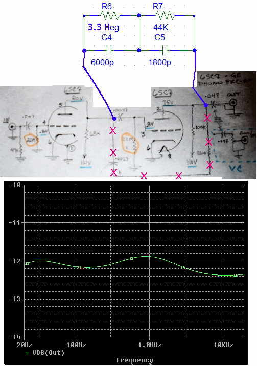

I've confused you.
The preamp you have now.
There is a 120K+0.0027u network from pin 2 to pin 5.
Disconnect one end of that.
Build the 4-part network shown. Put it from pin 2 to pin 5.
In simulation this gives accurate RIAA.

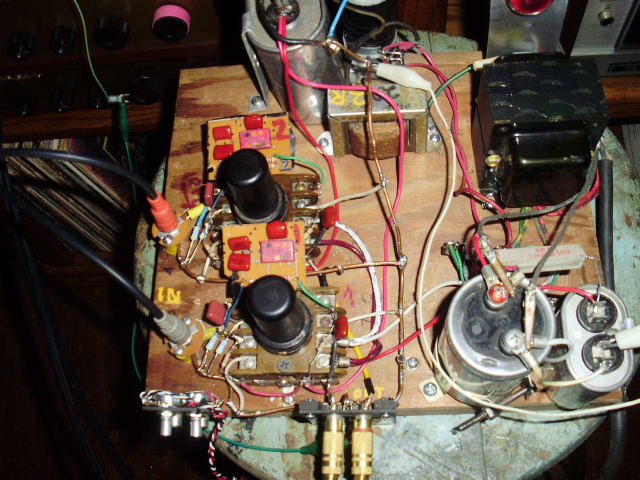

Getting closer,,, this network sounds right... Bass is back, not booming but full... highs are just right, not exaggerated as before...
Volume is not loud as originally, but its probably due to the added network and/or big coupling caps (10x original) that are still installed... I'll keep tweaking, but we seem to be on the right page now....

... Bass is back, not booming but full... highs are just right, not exaggerated as before... Volume is not loud....
Good. And there's only so much gain you can get from one 6SC7.

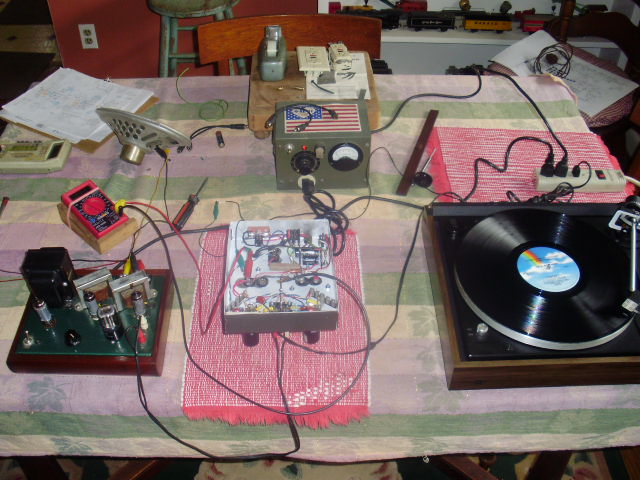

Got the limited gain somewhat sorted... I have a Maggy 185, which I rebuilt, but retained the 7025 input stage, which was for the passive tone stack in the phono only console, and added VC pots to it... With this pre amp plugged in thru this extra stage, we get all the gain/volume you could want, and its still quiet... I didn't raise B+ in the pre yet...

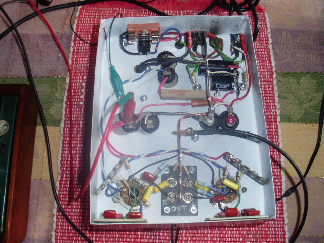

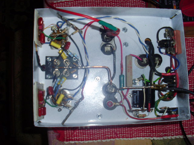

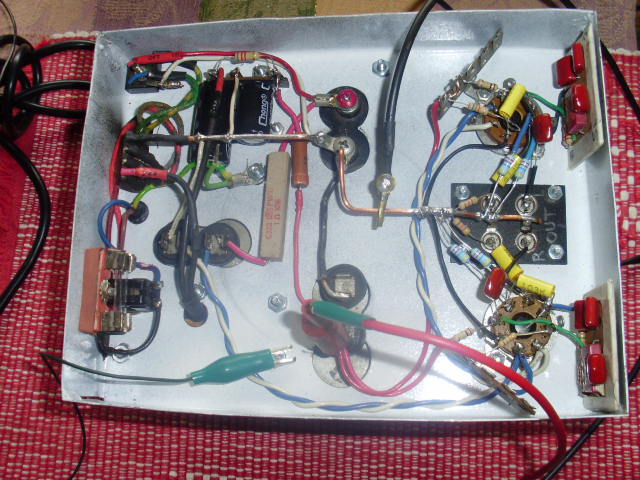

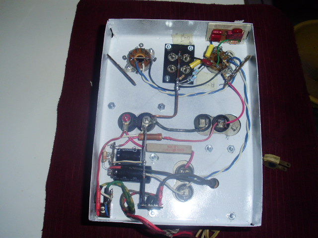

Wiring is done, its very quiet, and sounds good, with small amp and crap speakers!!! Fired up on first try,,, needs some permanent ground wires, and terminal for the TT... The cigar box case needs to be finished,,,
Thanks again to PRR for the RIAA sim and everyone else that offered help...

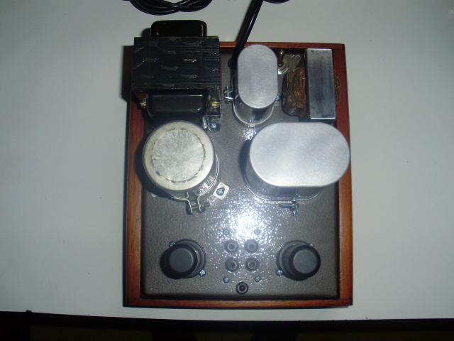

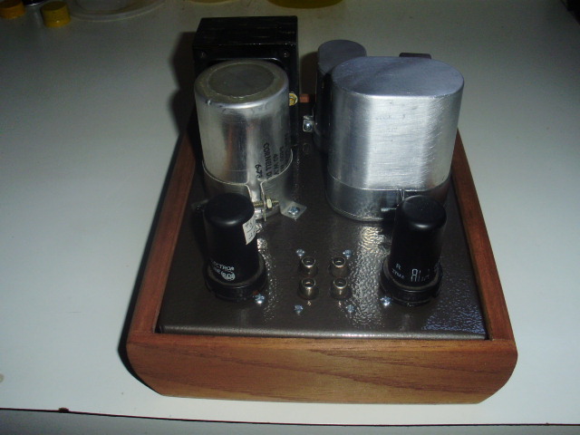

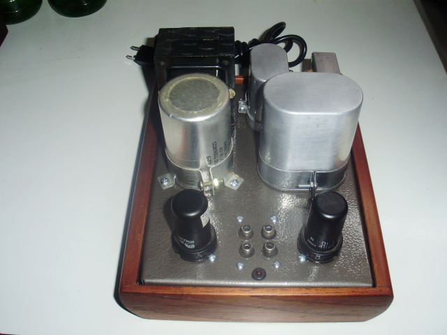

A couple pics of the finished (for now!) preamp,,, I reread the thread, and decided to try raising B+ as suggested... Seems 23-25VDC higher got a bit more volume and depth, and its still dead quiet,, so I'll leave it there until I try it with different amps, TTs and speakers...
Thanks again for the support with this project...
