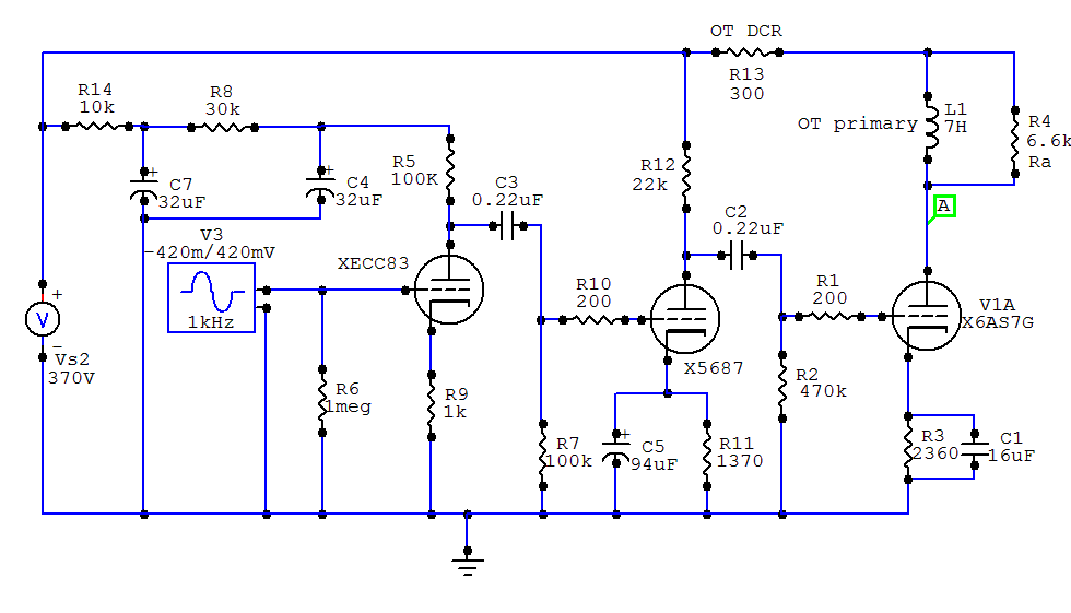

6080/6AS7 amp
I include with this post the schematics of the first version (generally speaking, I mostly did experimentation with input tubes and driver tubes, but this one will most probably be the most interesting, and it might as well not need a preamp, just a selector and a pot).
The schematics looks a little strange, since it was drawn for simulation purposes. Of course, if taking care, an amp can be constructed using this schematics (one resistor is actually the DCR of the primary, etc.).
When it comes to calculus, 235V across the tube (not B+ when you have automatic biasing with a cathode resistor) does not give only 1.3W, but approximately 2.5W (if needed, I can supply the simulation results).
Ra is a little high... but at this current and voltage, if you have the complete datasheet of the tube, you will see that it is far from the 200 ohm internal resistance, more like almost 1k. In that case, you can adopt 2.5x the internal resistance as Ra, but by increasing, you loose a lot less in power as much you gain in (decreasing) distortion... not to mention improved damping factor, which is always a good thing with SE amps (that is why most SE amps are accused of not having good bass -- they usually work into 2.5x the internal resistance of the tube).
Aleksandar
Aleksandar
