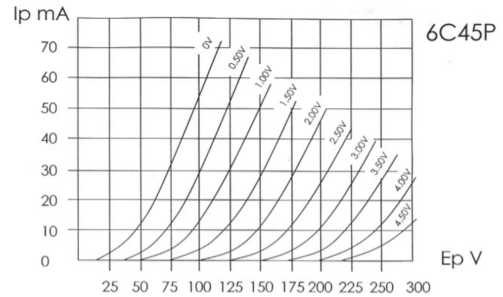

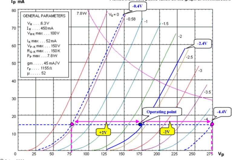

You'd have to run the tube right at 150V with 10mA of plate current (if you run more you could run into some trouble). With all the B+ available for 300B operation, you could probably get away with a plate load resistor. I would make the cathode bias voltage adjustable so you can dial the plate voltage right in (and maybe stretch it to 160V).

Great driver, 150v @ 12 to 15 ma will give best results.
They love to be choke loaded, and respond well with CCS too.
Why so few mA ?
6S45P could work with 200v and 35 mA?
Not to much hours but it can.
Rod, you're right. Curves are "scattered" at higher voltages for 6S45.
But it's not a problem, the problem is the real oscillation and the very, very hard sound from the 6S45P. Even stop-resistors on each electrode won’t help much.
I personally tried it, and for me (a real fan of the tube sound), anything over 5 mA is too much for 6S45P, IMHO. AC or DC heating, all the same. I very much agree with M.Koster about this tube
Who does not believe, let him try.

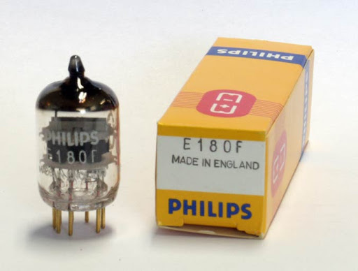

Hi euro21.
I have some Phillips and Siemens E180F.
And i have using KT in triode mode.
Are they enough to drive ( triode E180F ) the KT88 ?

For KT88 in triode? This worked fine for me. I have some nice gold pin Tesla E180F's that are very good... maybe even nicer than the Philips or siemens ones...
However: They are definitely not for driving 300b.
Ian

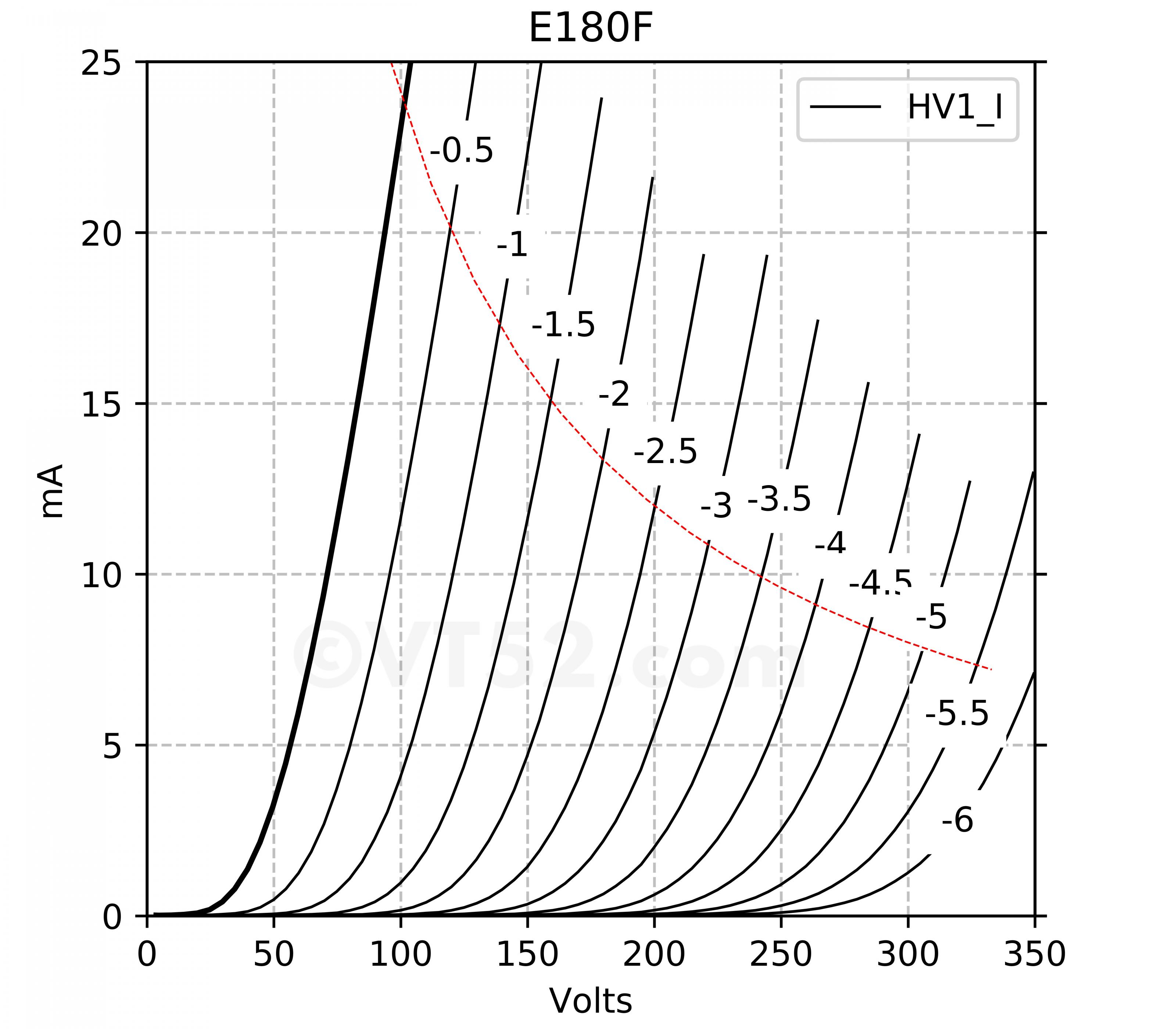

Be very careful with European variant of E180F.
It is a declared 4W tube in 30mm x 22mm (w/o pins) glass bulb. That is impossible. Trust me, E180F is the most damaging tube in old preamps from broadcast relay stations.
American variants are much more preferred where Pa+Pg2 = 3.3 W in a 36 mm glass bulb (w/o pimple), as shown in RayTheon or Sylvania data sheets for 6688.
