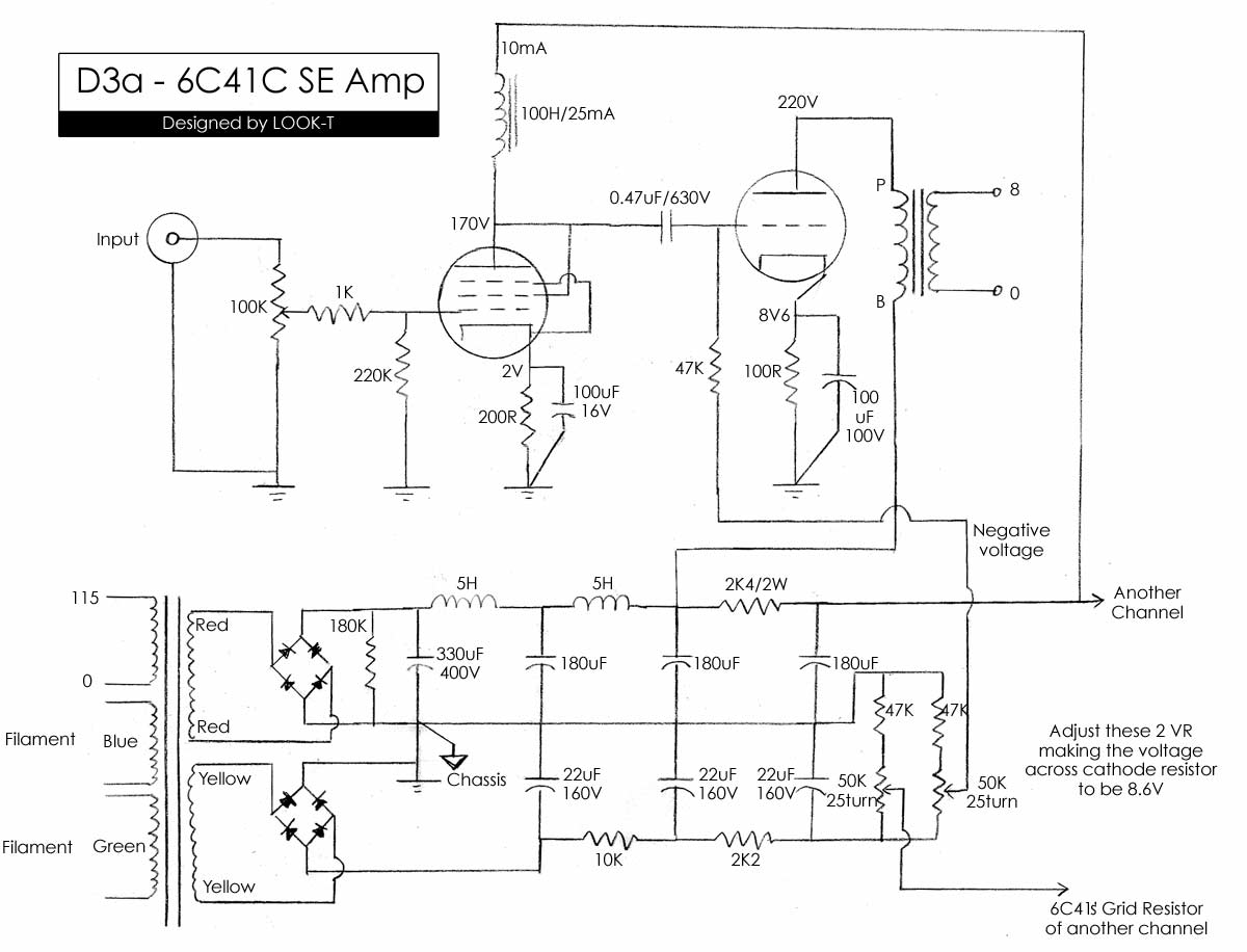

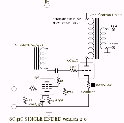

IHMO ,In any case for the best sonics make the amplifier simple and consist of only two active stages, the first stage to be a voltage amplifier and also a driver stage for the output power stage with a 6C41C tube, both stages to operate with automatic bias and to be RC coupled.
I also have a pair of One Electron UBT-1 transformers with a 1.7k primary impedance.
Some samples 6C41C/6S41S SE with UBT-1:
Reactions: banat
I would likely be using a depletion mode mosfet for the front end rather than the D3a - no choke loading, either. Feedback would include the output transformer, as I got away with that on my last project using the UBT-1

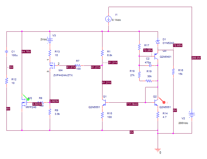

Here's the discrete shunt regulator I'll be using to bias the 6C41C cathodes. R17 may likely need to include a trimmer, as I have heard that in Russki tubes there is a fair amount of variability from unit to unit. This is likely to be the case for the 6C41C, as it is a tube intended for VR use with low internal resistance.
On the shunt regulator, FET M3 will likely need a generous heat spreader - I have some thick aluminum angle stock in mind. I'll likely be putting the depletion mode input stage and the shunt regulators (one for each output tube) on one board, with the interstage coupling cap and grid to ground resistor also included on the board. Output will likely need a Zobel network to make sure the loop gain goes below 0 dB and stays there.. Feedback will be to an appropriate point on the depletion mode MOSFET cathode bias network. I'm thinking of also loading the rectifier bridge and filter cap for the rectified output of the isolation transformer on the board with the input MOSFET and the shunt regulator, so it can be next to the depletion mode MOSFET input stage. Ill probably use UF5406 to rectify the 240V output of the isolation transformer. Also, in the mix, the bypass cap for the 200V rail for the 6C41C and the Output transformer.
