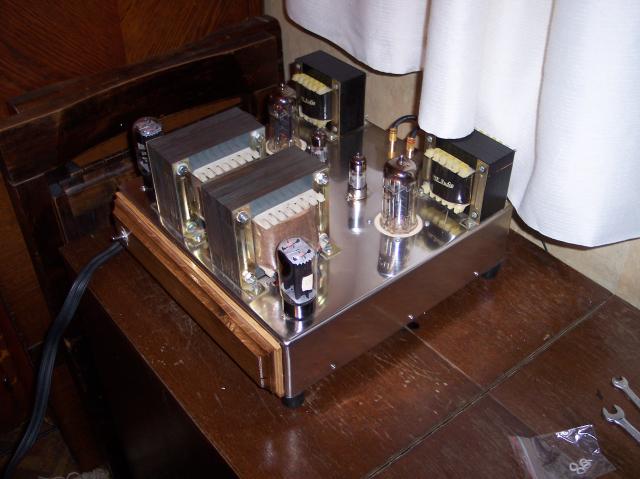

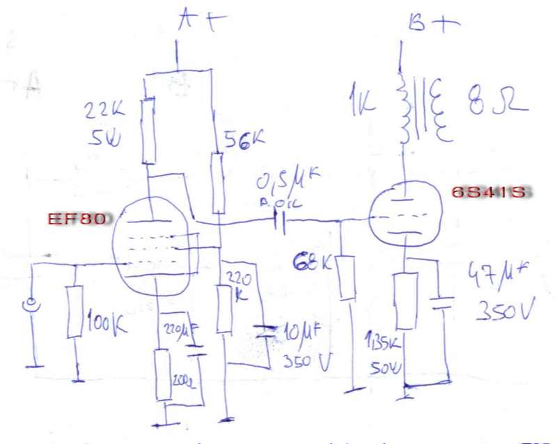

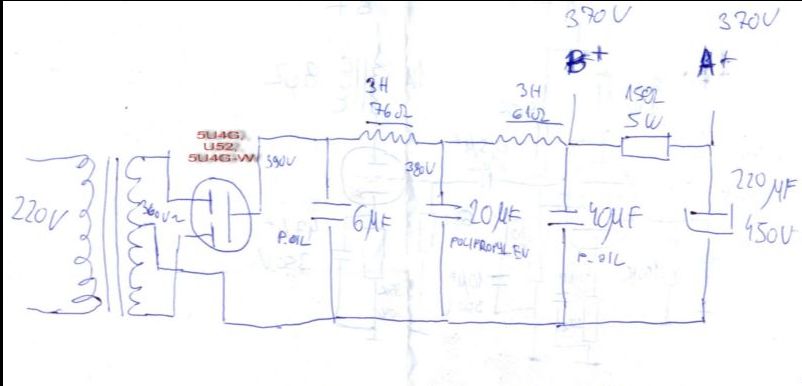

6S41S (6C41C) Amplifier
This are pictures and schematics of amplifier which I build few years ago.
This is great Amp, not because I build it, it really is. Here is picture:
