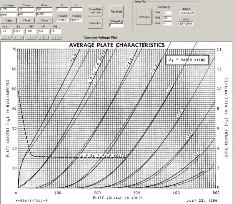

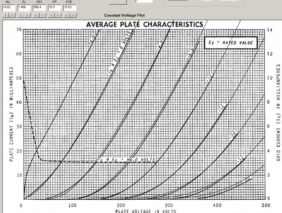

since there was no reply to my inquiry I had to come up with my own solution. Norman Koren was so kind as to run parameters I had extracted from the datasheet through his Tuparam software. The resultant model needed some tweaking, for which I used James E. Lanier's program PSPICE_Calc . The match is not perfect, but approximates the normal operating range (Ug=[-8v..-12V]) reasonably well:
The thick lines are the ones from the datasheet, the thin ones show what the model parameters do.

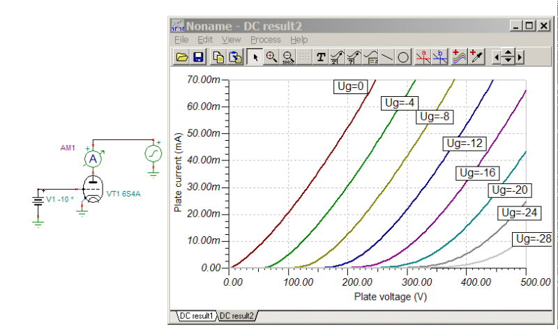

I plugged these data into a TINA-TI model and created a TINA macro for it.
And here is the test run under TINA-TI:
Again, this will require more work, but it is a start. Thanks again to Norman and James without whose software I would not have tackled this project.

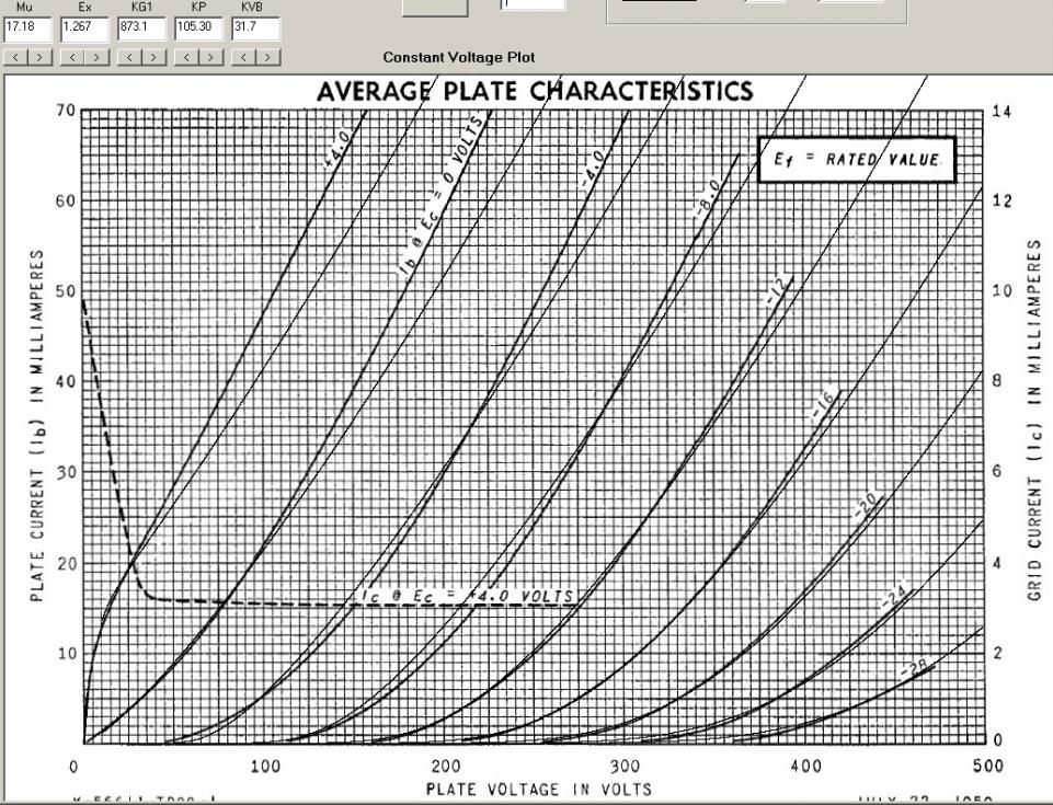

Amended model (better match for -12>Ug>-28V):
