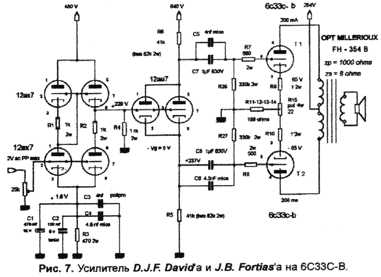

I have all the major parts necessary for building a push-pull amplifier using the 6S33S tubes. I have multiple power transformers, chokes, and even a pair of Toroidy TTG-6C33CPP output transformers. I want to make the best possible circuit that uses the 6S33S tubes and uses these output transformers. What options are out there. Before anyone asks I am not interested in the OTL amplifiers For this project. I will build one in the future but I want to try a more conventional amp first.

Some of the schematics I have (but I didn't build something with the 6C33C myself).
