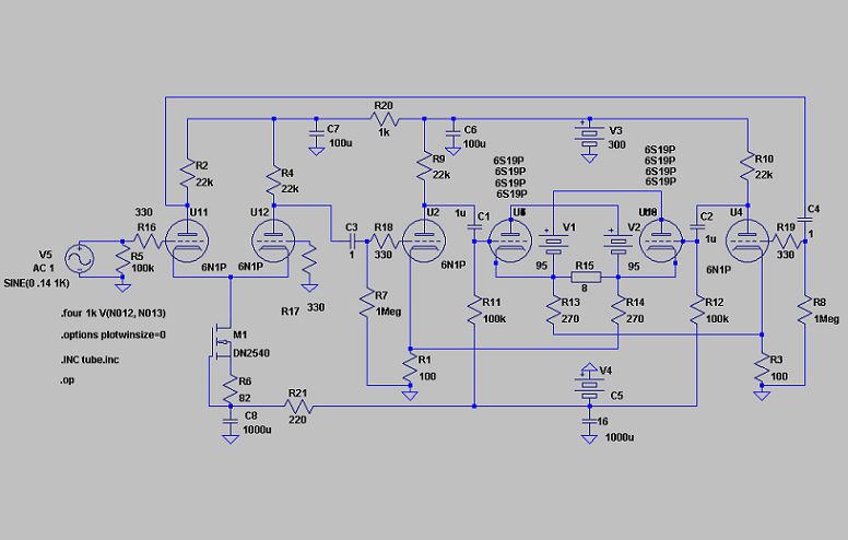

Hi reVintage!

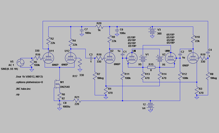

That is pretty much what I have in mind, but there is one thing that doesn´t match Tubecads schematic:
R13/14 makes a voltage divider together with R1/3 which seems to cut the feedback signal down to ~25% of what it should be.
Remove R13/14 and increase R1/3 to 370R and see what happens...?
Thank you for "spajsing" this circuit for me!
This is how I would do it!
It was NOT ment to match Broskies schematic as it seems to be f-cked up! Must be a drawing error as I said in my previous post. Or also I could be the jerk, not to understand his strike of genius
! Anyway I will give it another try tonight as I might have missed something. It could be as simple as that the gnd reference resistors are missing.
My circuit will not work changing R1/R3 as these sets the current through the 6N1Ps to 8mA. And you must have R13/14 as these are for GND reference.
I recommend using a low-mu tube like 6H30 to lower sensitivety.

Sorry, forget the part about increasing R1/3 to 370R. Tankevurpa😱
I still don´t see the point in R13/14 though, the output stage would still have ground reference through R1 and R3.
Of course I´m talking about shunting R13/14, not removing them!
Regarding the high sensitivity I´m going to use 6N6P (µ~20) in the input and driver stages.
The only weird thing I can see in Broskies circuit is the bias arrangement, I don´t understand the need for a -300V rail when the output tubes only needs something like -25V and cathode bias would be perfectly sufficient for the driver tubes.
Sorry Fuling,
Thought it was 6N1P, will do another sim tonight with the right tube
. As 6H30 and 6N6 are "cousins" they might work well.
About gnd reference I ment that it is missing in Broskies circuit.

I thought about using 6N1P at first but I prefer amps with low input sensitivity (and low feedback if possible).
Now I understand what you mean is wrong with the broskie circuit! He explains the need for ground reference in an earlier article about circlotrons so I guess he just left them out in this one to since the focus is on the feedback circuitry.
What I mean is that those reference resistors can do double duty as cathode (bias) resistors for the driver tubes.
The floating power supplies will then be raised a couple of volts above ground but as they are floating it shouldn´t matter.
Have spent the last hour trying to sim Broskies circuit with no success.
Anyway, my circuit(below) seems to work. The sim indicates a Zout under 3ohm and a sensitivity of ca 0,4V rms. Thought output before clipping should be higher as this is indicated in TCJ PP calculator. I get 3-4W into 8ohm. With less feedback, higher R13/14, Zout gets higher. 8mA through all 6N6s, 110mA through each 6C19.
