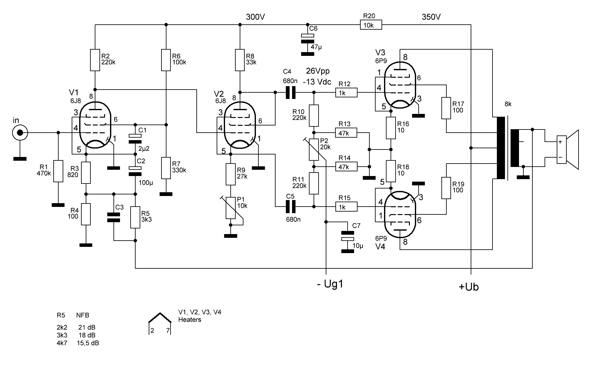

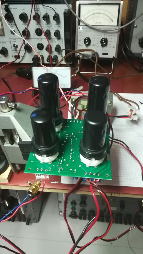

Has anyone here experimented with them?
Any advice/designs/recommendations, that you could share?
"Full Metal" 15 W PP-amplifier:
artosalo,
Very nice looking amplifier!
I miss those metal tubes that I had in a surplus military airplane shortwave radio that I used to have.
I am guessing that the purpose of the rheostat in the concertina is not to balance the concertina (with equal cathode and plate resistors, the balance is automatic, all the way until the signal level draws concertina tube grid current).
Instead, I am guessing the purpose of the rheostat in the concertina is to null out any
un-balance of the two output tubes.
Right?
