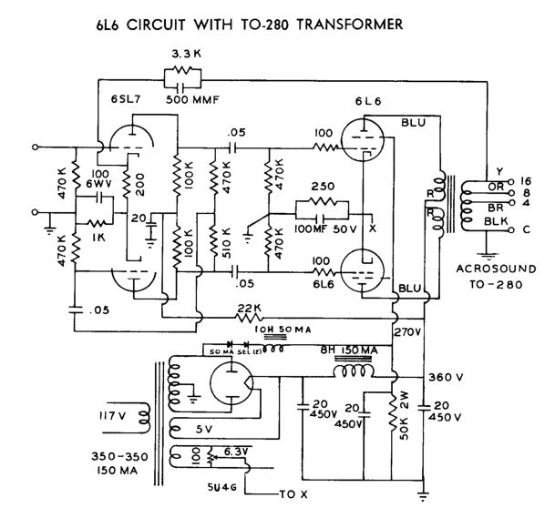

Some weeks ago I bought a variant of this Dynaco (6n2p+2x6p1p) in DIY kit just to be
amazed that NONE of the input triodes has its cathode DC circuit closed to the ground.
I browsed the net for the schematic diagram and from DOZENS of them ALL BUT ONE WAS CORRECT. As the 100R resistor between cathodes is for negative reaction and not
Rk, find the appropriate Rk for your input valve, halve it and solder it in parallel with (100uF) Ck.
Good luck
Adrian
PS: or replace 100R with two apropriate Rk to the ground and
recalculate the negative reaction loop (1K in paralell with 1nF)

aoncica,
In the dyna schematics earlier in this thread (except Lingwendil's 2nd schematic with the constant current sink, a phase splitter that I like), the input cathode's self bias resistor is actually the 1k feedback resistor that comes from the output transformer secondary, of which secondary, the common end is grounded.
The 100 Ohm cathode resistor is AC (signal) bypassed at the second cathode to ground.
So the feedback resistors are 1k and 100 Ohm, at the first cathode (no 'floating' cathodes in that circuit).
Is your amplifier the same as that?
Please post a correct schematic of your actual amplifier circuit.
Without a schematic of what you started with, your text in Post # 21 is a little hard to understand.

Your explanation is illuminating but the solution (Rfb=Rk) looks to me a little awkward. Isn't also a negativation mismatch between triodes? I'll give it a try
Here it is an excerpt from an old Accrosound transformers data with applications:
