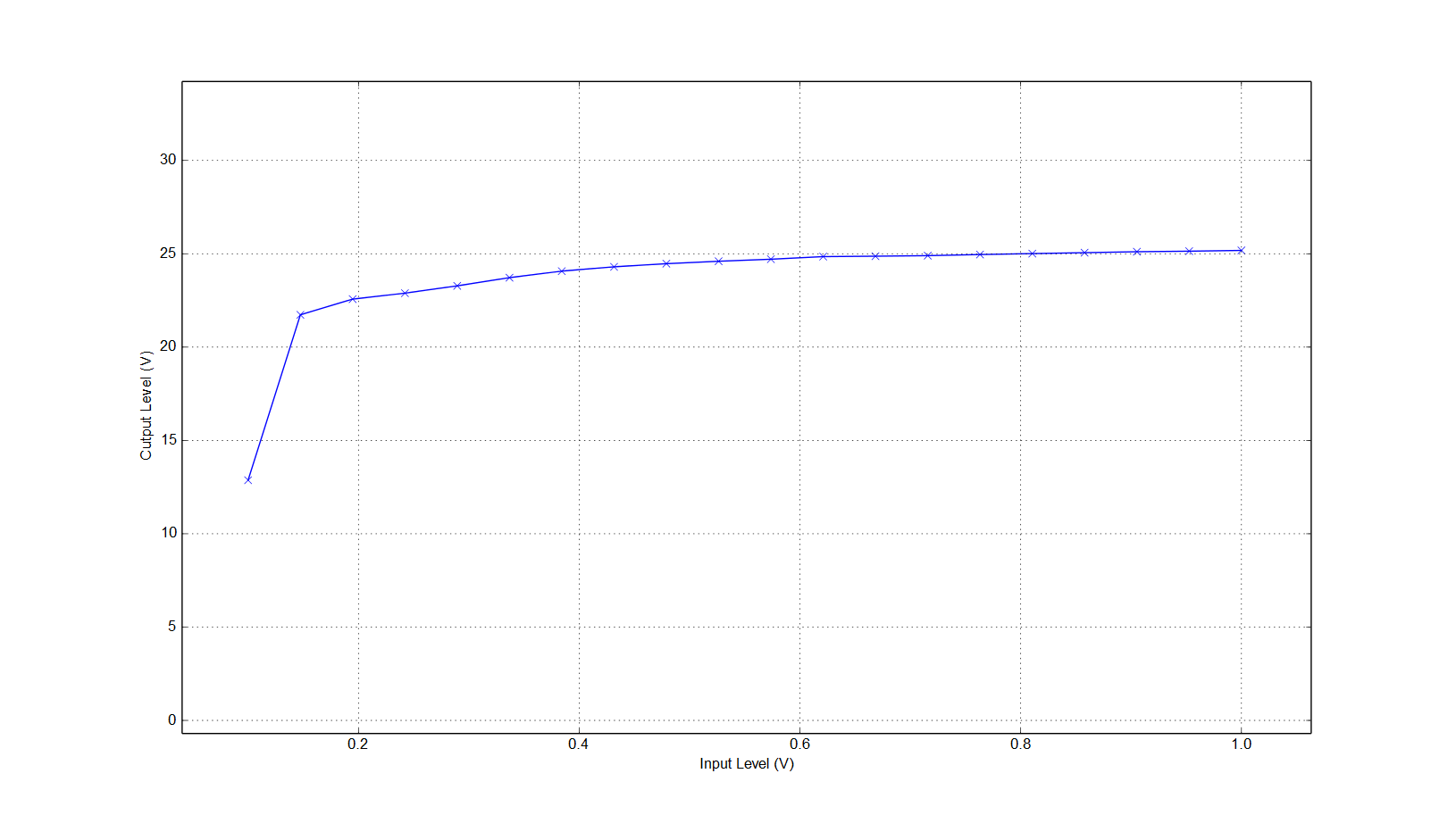

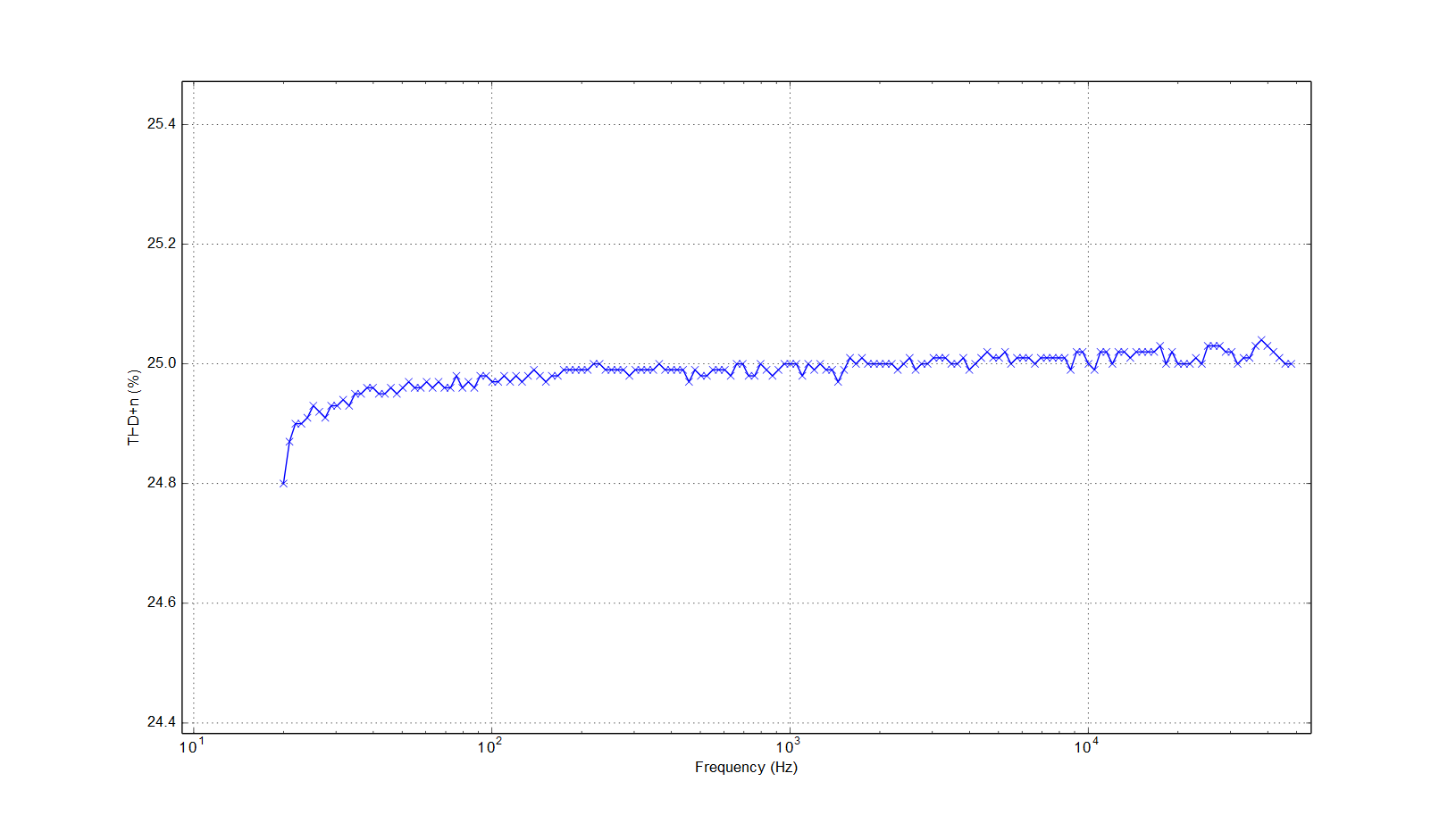

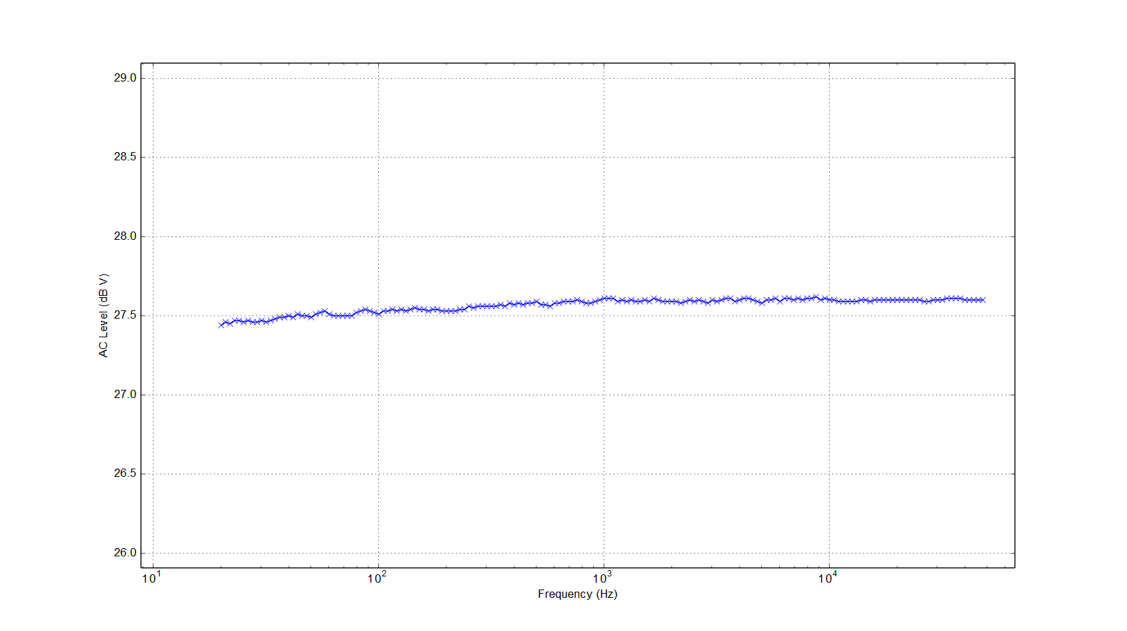

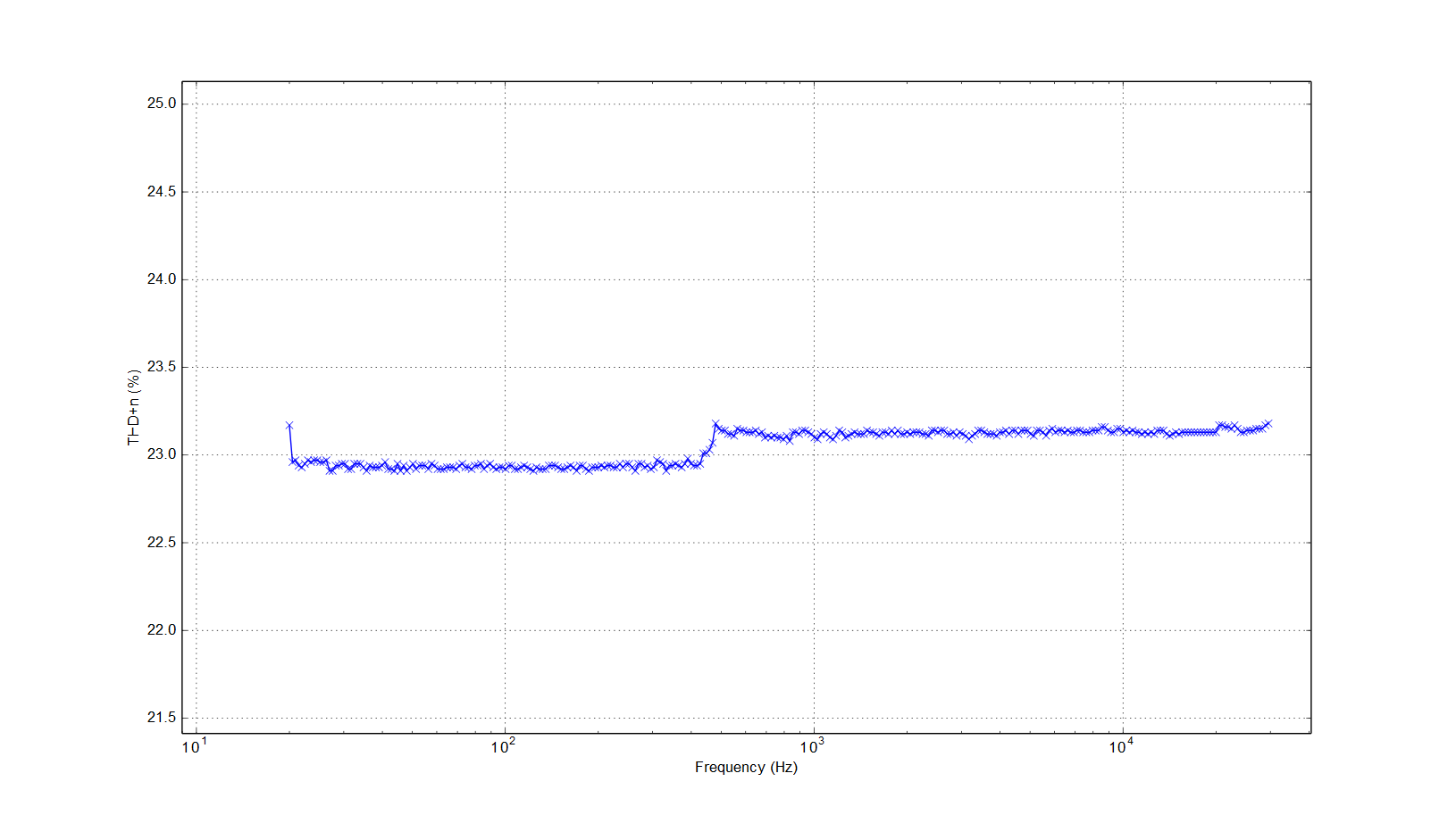

Attached are measurements made with a HP8903A audio analyzer.
Frequency response plot, output level at 1 kHz and a THD+n which raises a few questions to be investigated further with a scope to see what kind of noise it it.

Indeed, rather strange that increase in the noise above 500Hz...

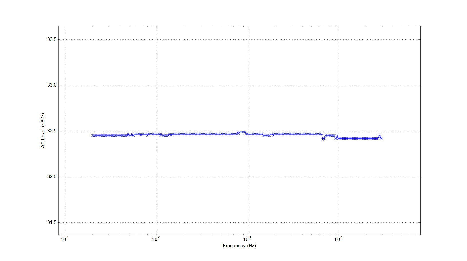

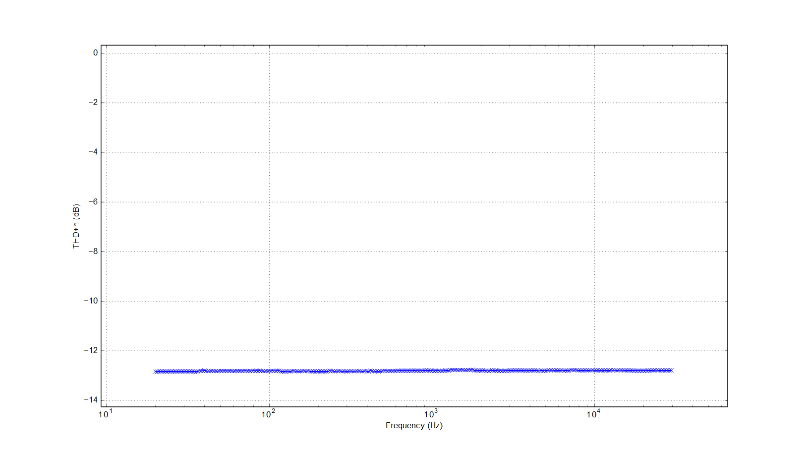

I will measure the physical size of it later tonight. That measurement might have a fluke, here is the same measurement, but separate, just as dB instead of %.
Measurements are 20 Hz to 30 kHz, 0.5V, 100 steps per decade.

All the above measurements are invalid, dummy load was not properly connected so it is basically running "open loop" into the 100K impedance of the analyzer.

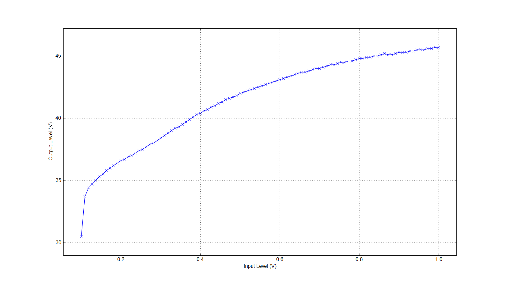

New measurements with a fresh OPT installed, the one that arced gives some spurious 0.5 to 1 Ohm DC resistance on the secondary side, it does not look like its good for anything but brief weighting.
Dummy load was a 8.6 Ohm 200 Watt resistor and thus the output power from the output level test gives some 70 Watt out at 0.5 V in. The other tests are done at 0.5 V input too.
I had the amplifier hooked up to my JBL 4333s for the first time and it is now obvious that there is a reason for the high thd+n measurements, there is a great deal of noise, still not sure which kind, but sounds like white and harmonic.

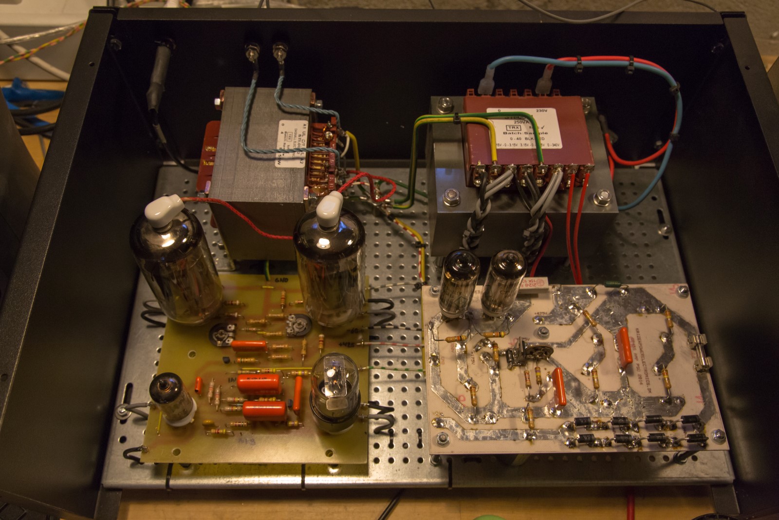

It measures, as seen on this most recent picture, 60 mm wide, 100 mm deep and 80 mm in height.

So you've got an EI102/60 core, which is around 20cm^2. Some rather brute calculations tell that it's good for 100W @20Hz. I've got only EI102/53 core, 17cm^2, like 100W@26Hz.
That might be the reason why your mosfets kept blowing up.
