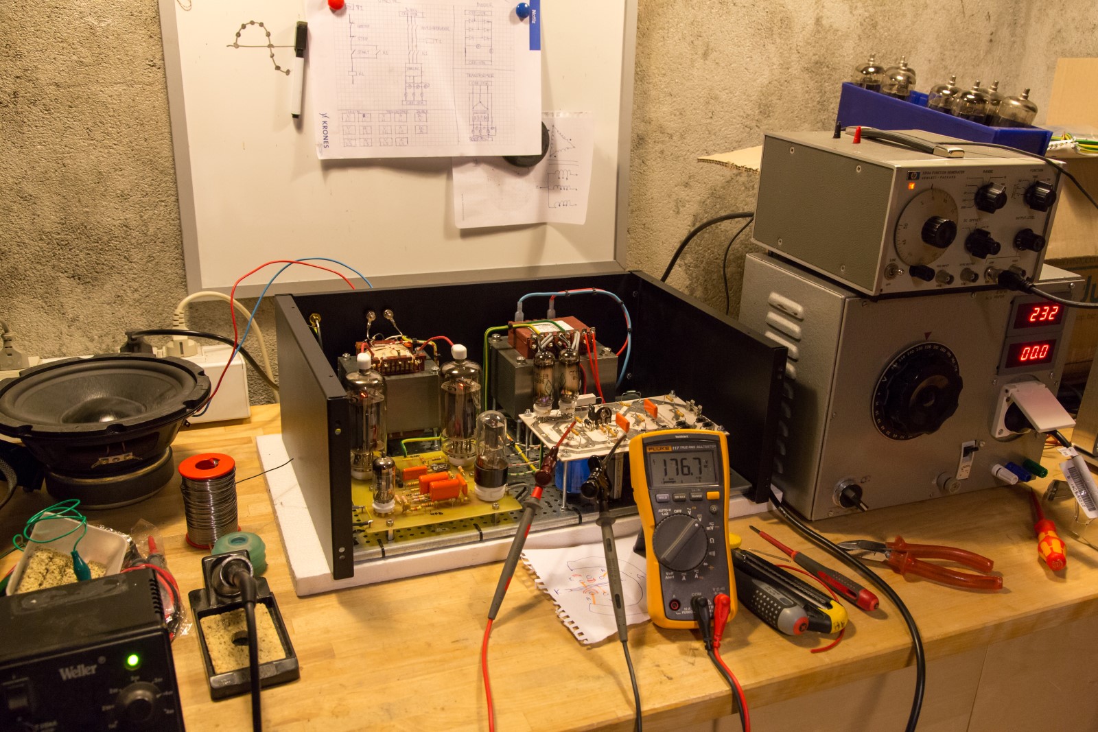

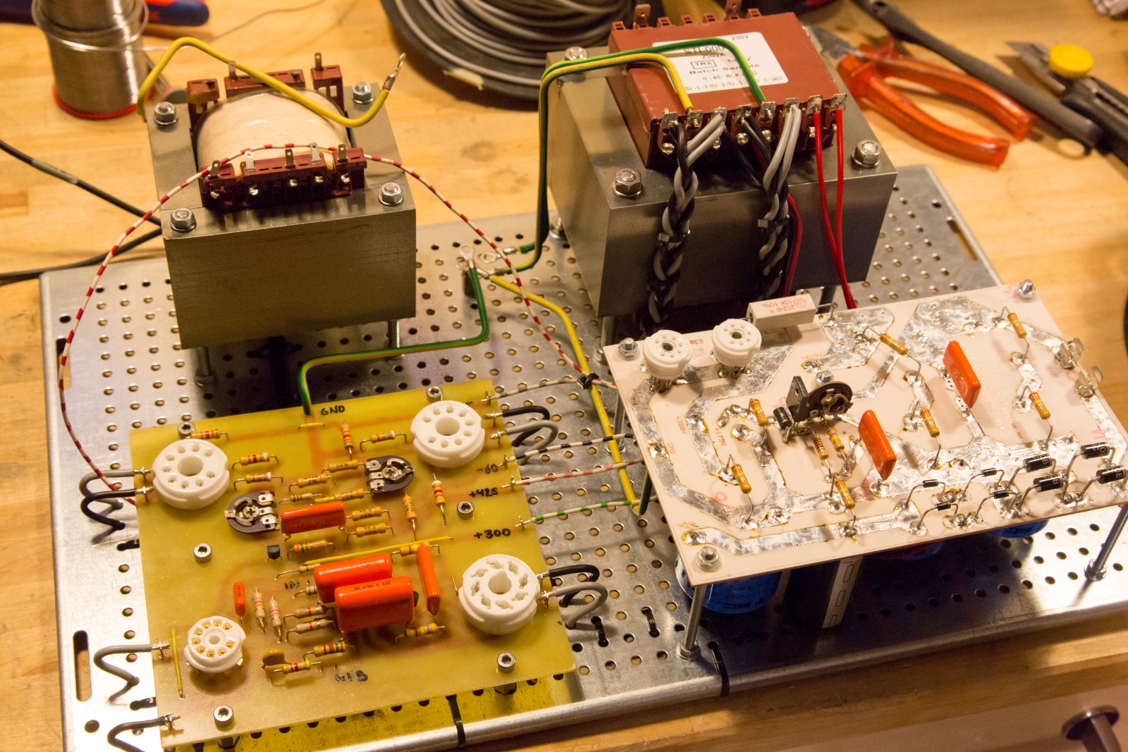

The prototype is built from scrap materials and BirdNestTechnology 2.0 🙂
The prototype finally working, amplifying at 475VDC with 1000mV over the cathode resistor, somewhere around 45-50 Watt output power.
I spend a long time making many tweeks against parasitic oscillations that turned out to be bad output tubes. But I went through 7 output tubes that did not work properly before I got it running. Went straight from the bench to start working on the uTracer3 to avoid such waste of time in the future 🙂

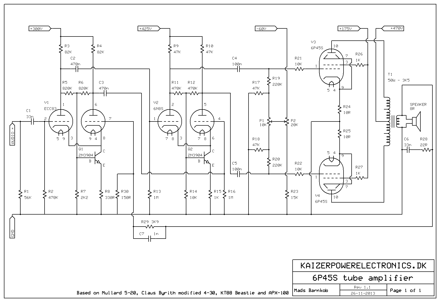

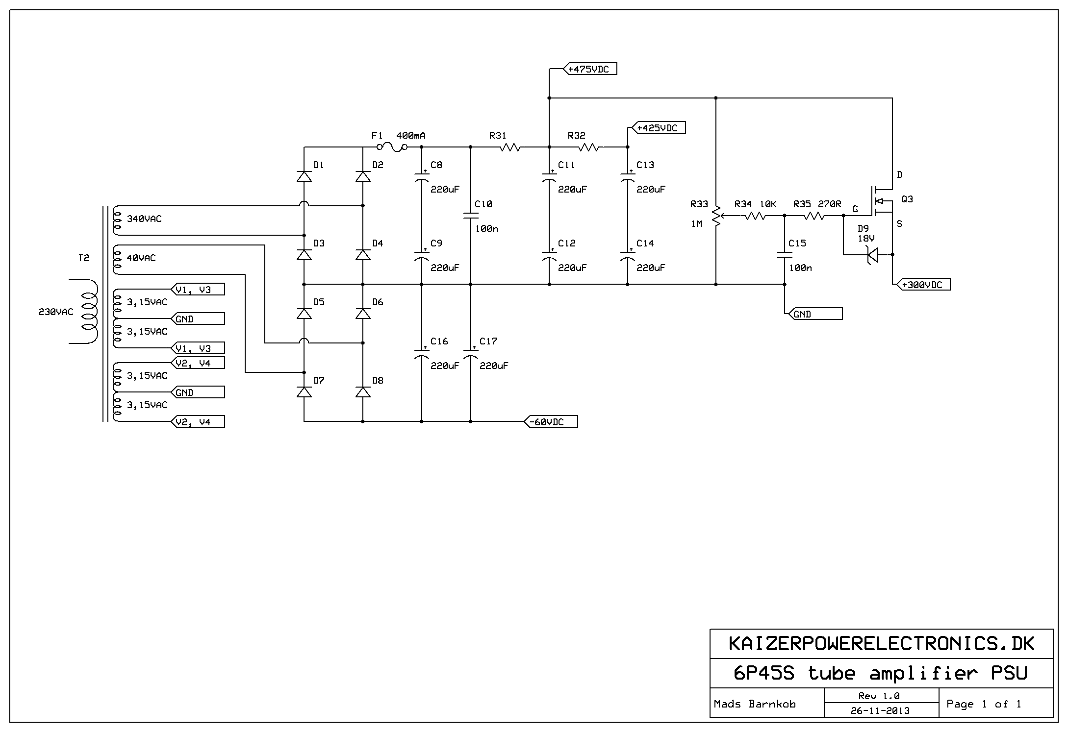

Looks very nice 🙂

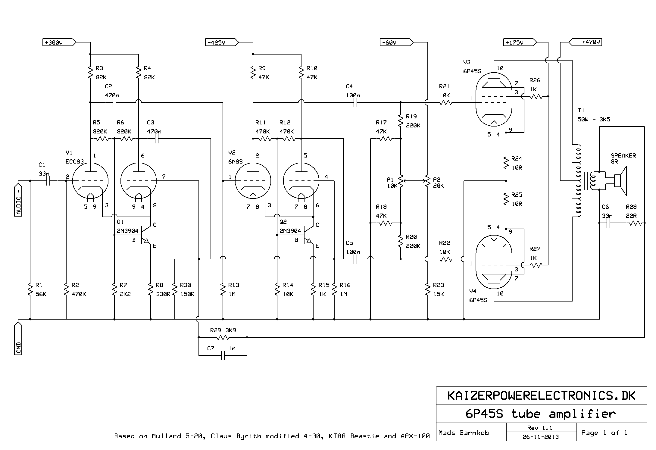

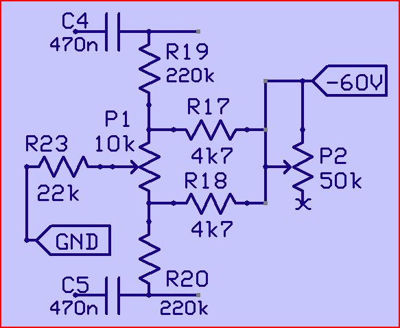

There are a few points I would like the draw your attention on 😉

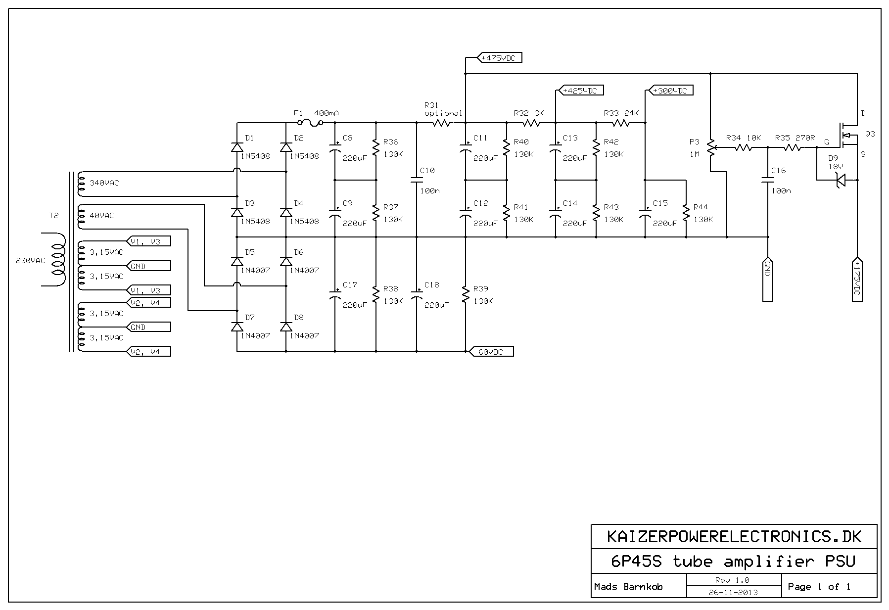

Better put some resistors in parallel with the electrolytics-pairs in the power supply.Otherwise the voltage will divide according to there leak resistances,probably not equal.
Why C2,C3=470n on 1M and C4,C5=100n on 220k ,I would invert that.
It seems to me that Q1 is starving there(not much of a current source),perhaps R7,R8 smaler ?

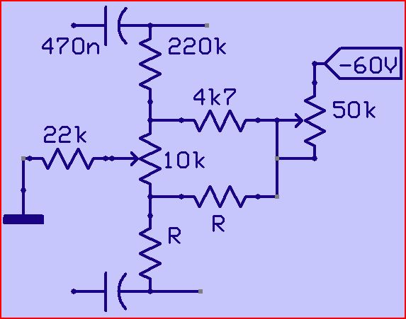

And last the bias circuit.If one of the pot.meters fail (no center contact) the bias goes to 0volt.The tubes doesn't like that 😱 .
Here a suggestion on how to avoid it,like this a fault gives max.bias.

I have built three (3) different amplifiers with 6P45S/PL519/JJEL509.
Two with normal PP-topology and one Circlotron.
I reached essentially higher power levels. With 1k8 OPT, the power level is some 170 W and with 4 k OPT about 100 W.
According to my tests the optimum quiescent current (lowest THD) is about 45...55 mA. Your cathode current seems to be 100 mA/tube.
This exceeds the specified max. PD a lot. Or have I misunderstood something ?
How did you came into the conclusion to use such high current ?
What sort of THD values you have ?
Still it it very difficult to understand how it is even possible to construct an amplifier giving only 50 W with the conditions you have told.
Below the schematic of my PP-amps.
The first is 170 W and the second 100 W version.
what's the use of diriving the CCSs' base voltages (and thus the common cathode currents) from the anodes in both differential pairs? Kind of bias servo?
Best regards!

Ketje and Kay Pirinha:
I used the schematic that Kruesi posted in the bottom of this thread: http://www.diyaudio.com/forums/tubes-valves/71300-photo-gallery-523.html he explains the reasons for the design here http://www.diyaudio.com/forums/tubes-valves/71300-photo-gallery-525.html#post3537462
I do have balancing resistors on the power supply, just forgot to put them in the schematic, thanks for noticing!
I will for sure implement the bias network like you suggested, but in any case, I would catch such a failure with the microcontroller emergency shutdown that I will add.

You did not misunderstand anything, I did. As I used Ohms law to calculate the plate current I brain farted and did the same for output power without taking plate load into account. I do not fully understand the math behind tube amplifier design and try to learn as I build. So having it adjusted for 100mA is a mistake and it was never driven that hard as I tested with a very low amplitude input signal, no red plates 🙂
Could you please point me in the right direction of which book to start with? Books: Technical books online

There is an error in the drawing 😱 ,the 50k potm can't do anything like that.An update,And last the bias circuit.If one of the pot.meters fail (no center contact) the bias goes to 0volt.The tubes doesn't like that 😱 .

Ketje: I tried simulating the two different bias adjustment circuits, the original one I use makes for a nice logarithmic curve voltage that evenly distributes between the two legs, whereas your 2nd suggested jumps suddenly. I will use my original circuit and possible potentiometer failure will be catched by the microcontroller watching cathode resistor voltage drop.
This is much more in the league of a 100 Watt amplifier, thanks to Artosalo for helping me.
I also updated the schematics as attached in this post (how do i delete the old outdated?)

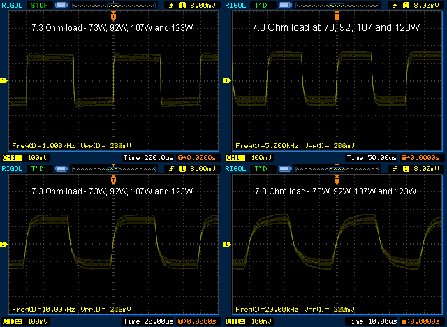

New link to my homepage with full article: 100W 6P45S monoblock tube amplifier | Kaizer Power Electronics

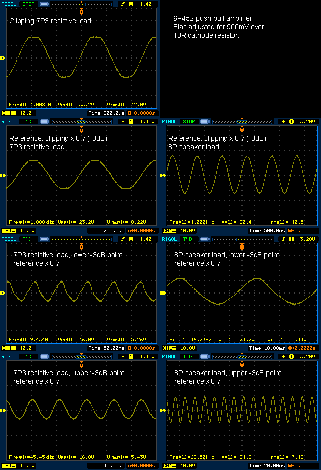

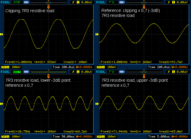

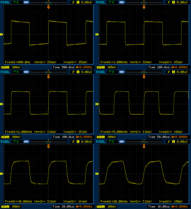

Second performance measurements after NFB capacitor is changed from 1nF (41kHz cutoff) to 0.47nF(87kHz cutoff), the bandwidth of the amplifier was increased and clipping occurs at higher power than earlier measurements.
Thanks to Arto Salo for helping me with these improvements.
Clipping occurred at 39.2V over 7R3 resistor.

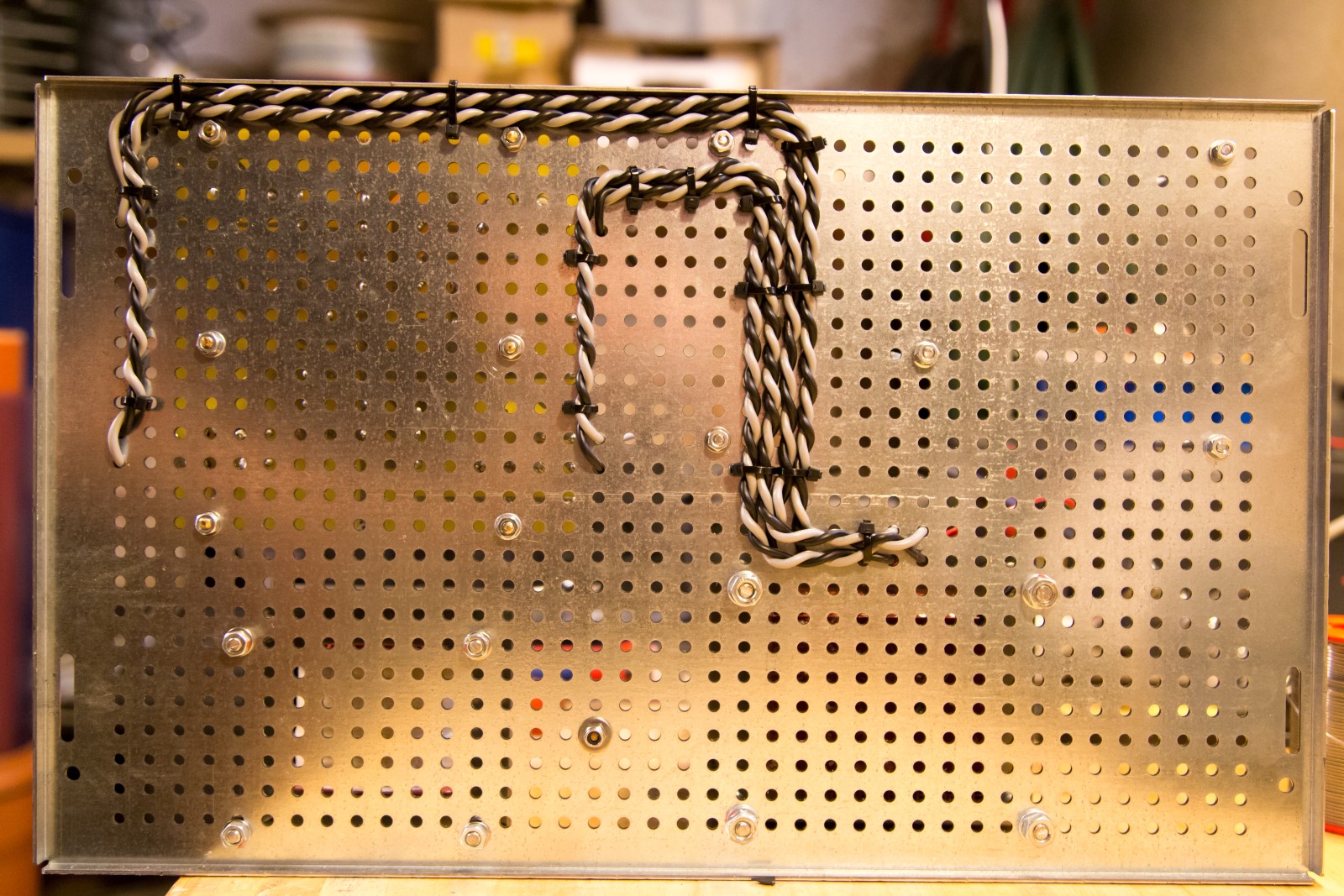

A few of the troubles met along the way:
- Too little load on the VR tubes, fixed with load resistors to ensure a suitable minimum load.
- Screen supply 500V MOSFET died from voltage spike at turn on, switched to a 800V MOSFET.
- Hum issues have been lessened with additional screen on the input coax cable and mounting input coupling capacitor with leg connected to outer film of the capacitor to the lowest impedance towards ground.

In the meanwhile, did you change R14 and R15 ? Because with those values (10k and 1k) there is no voltage left for the Q2 to function.(emetter 8V and collector 7V5)
If you make R14=5k1 and R15=470R the collector stays at 7V5 but the emitter goes to 3V75.Leaving also 3V75 for Q2.

Are you sure? I am using these values in a very similar amp, but using 6N1P as driver tube. It is functioning well for me. Oh, and the transistor is MPSA42.

I measured the voltages on the amp last night and Mona is right, emitter and collector is at roughly 7,5-8V each.
I changed to 4K4 and 440R but did not have time to test it last night, will adjust the balance if needed and measure again as soon as possible.

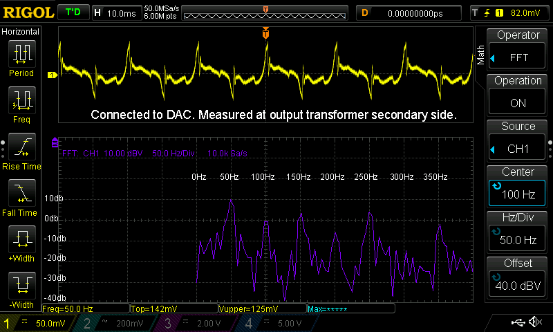

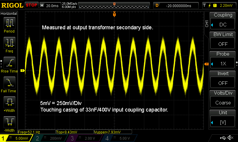

Update from two days ago:

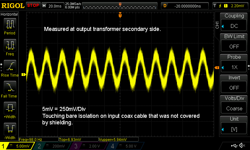

Further investigation of hum issues was conducted by waving a isolated 1000VDC rated screw driver around in proximity of different components while watching the secondary side of the output transformer on my oscilloscope.

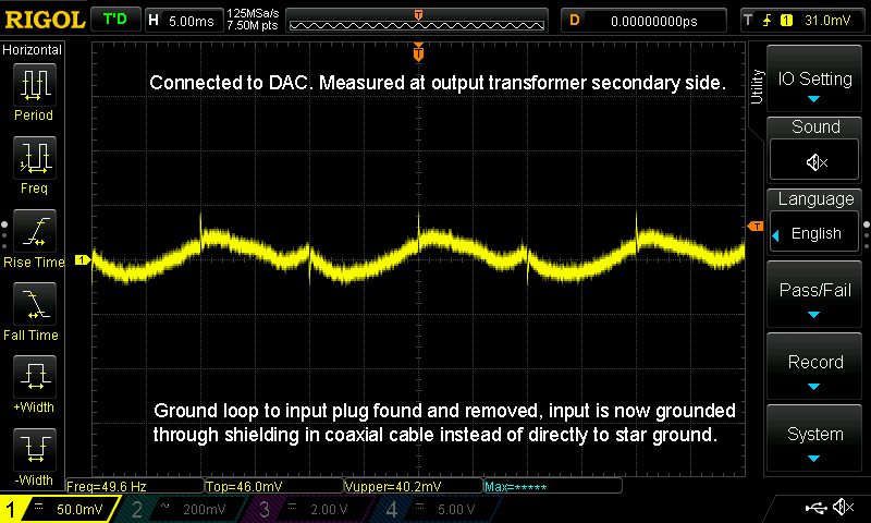

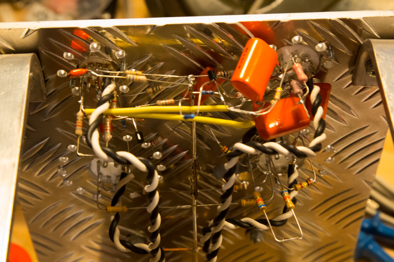

I identified two vulnerable places where a great deal of noise could be induced through capacitive coupling and there is also sensitive to noise through induction from magnetic fields.
The first issue was a small part of the signal line in coaxial cable that was not shielded. Explanations are written on each screenshot from the oscilloscope. The first pictures show the output without any interference with the circuit. The second shows the effect of touching the isolation on the part of the signal line in cable that was not shielded.

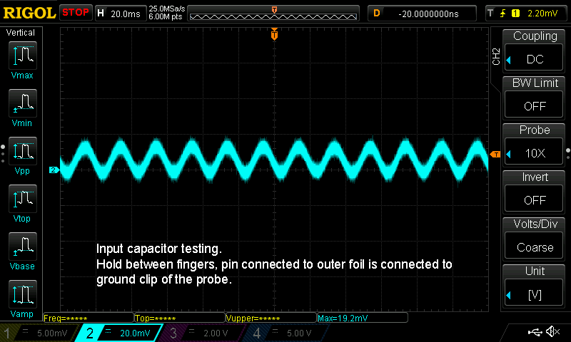

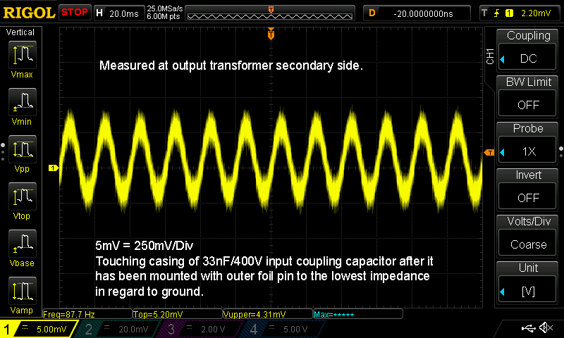

The second issue was the coupling capacitor in the input circuit before the pre-amplifier. The yellow wave form with the highest amplitude show the induced noise by touching it as it was installed.
The two blue wave form screenshots show the test to locate the pin connected to the outer foil layer in the capacitor, the capacitor is simply connected to the signal and ground of the oscilloscope probe and squeezed around with your fingers. Switch the connections around to perform it at reverse polarity.
The wave form with the lowest amplitude tells us that the pin currently connected to the ground clip is the pin connected internally to the outer foil layer in the capacitor. This outer layer will also function as a shield in high impedance circuits and that pin should be connected to ground or the path with lowest impedance towards ground.
Now the question is, did it help? Measurable yes, on any audible hum performance heard with a human ear... not really 🙂

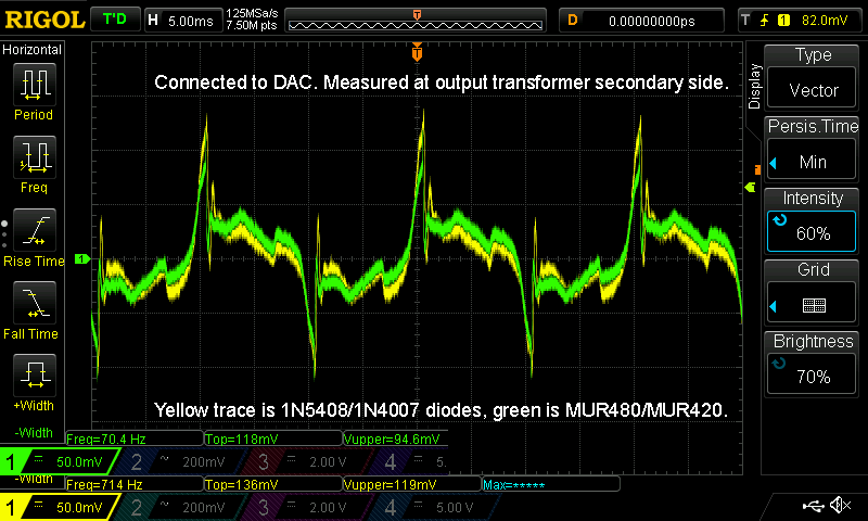

All wave forms are from the secondary side of the output transformer.
The first oscilloscope screenshot shows a Fast Fourier Transform (FFT) analysis of the noise generated by the normal diodes for the 340VAC high voltage supply 1N5408 and 40VAC bias supply 1N4007.
The second oscilloscope screenshot shows the difference between normal diodes like 1N5408/1N4007 that have reverse recovery times around 2uS and fast diodes like MUR480/MUR420 that have reverse recovery times around 50nS is shown in the oscilloscope screenshot with yellow and green wave forms. The spike amplitude is around 15% less but the overall 50Hz hum at the positive half cycle is a little more prominent. Changing the diodes gave a difference in the sound from the switching spikes.
The third oscilloscope screenshot shows the much reduced noise levels after a ground loop formed from star ground point to signal input plug was removed and along with the much shorter switching spikes from the new fast diodes.
Audible it appeared like 90% of the hum disappeared. The greatest performance gain was however from removing a ground loop, the faster diodes did not have such a dramatic effect, it was hear able, but not on the magnitude of removing the ground loop.
Mona: I have now tested the amplifier with the changed Q2 resistors and I had to adjust bias balance further to one side, so if the splitter is now more balanced than before it is infact the output tubes that are not matched that great anyway.
