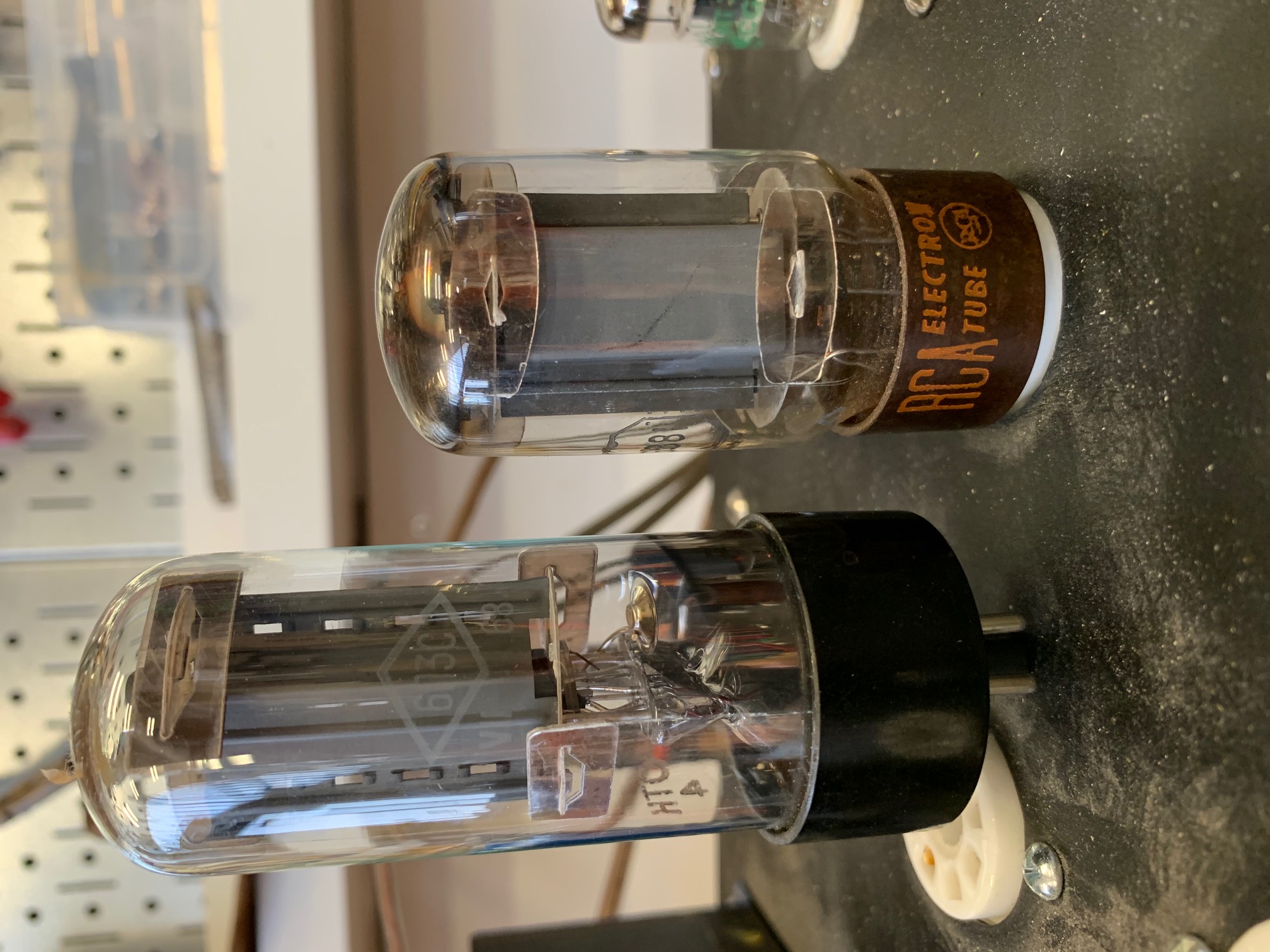

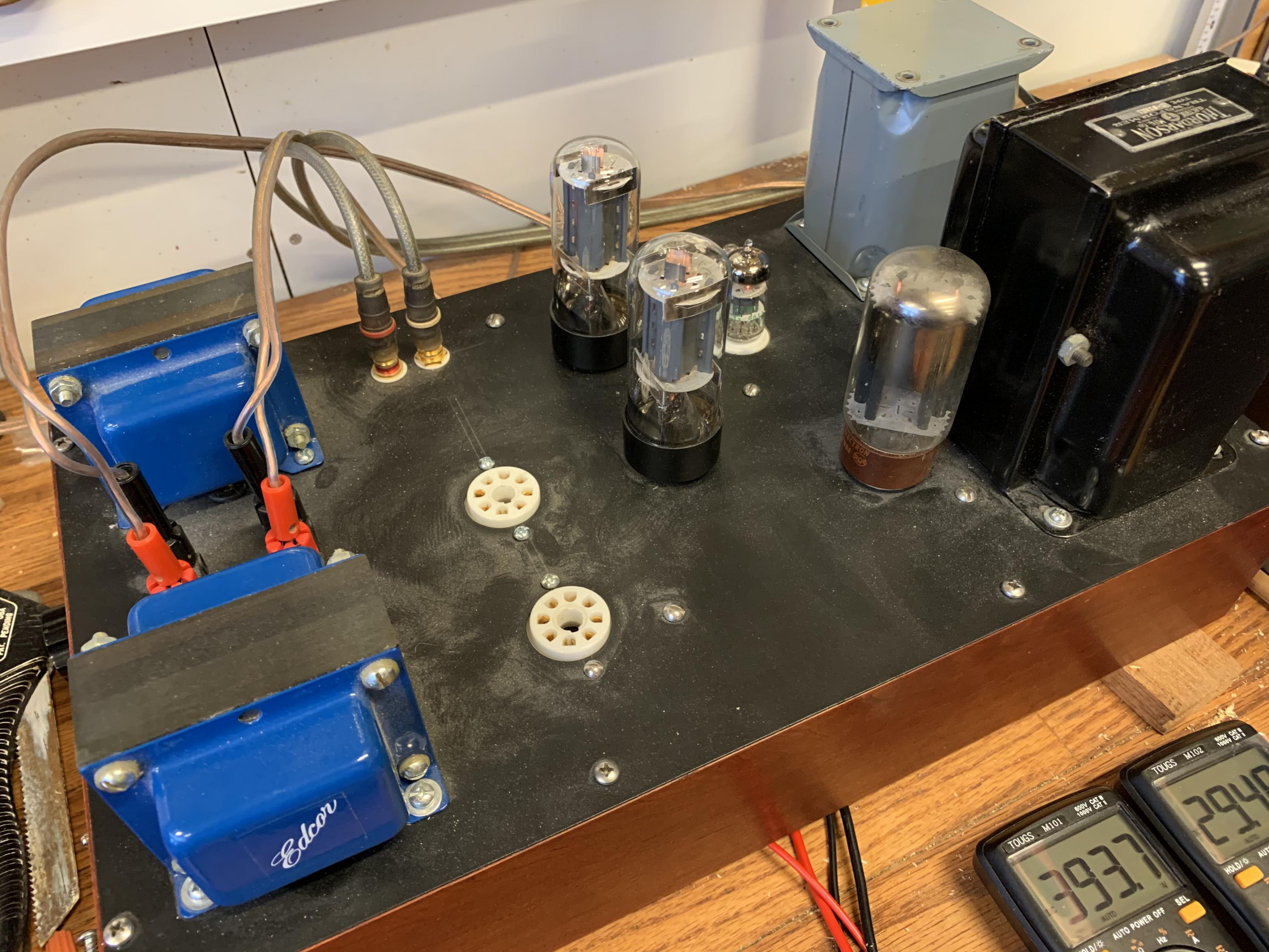

Continuing my weeks-long shop cleanup, I happened across a pair of 6P3S.
Must have been purchased MORE than decade ago.
The manufacture date is July 1968.

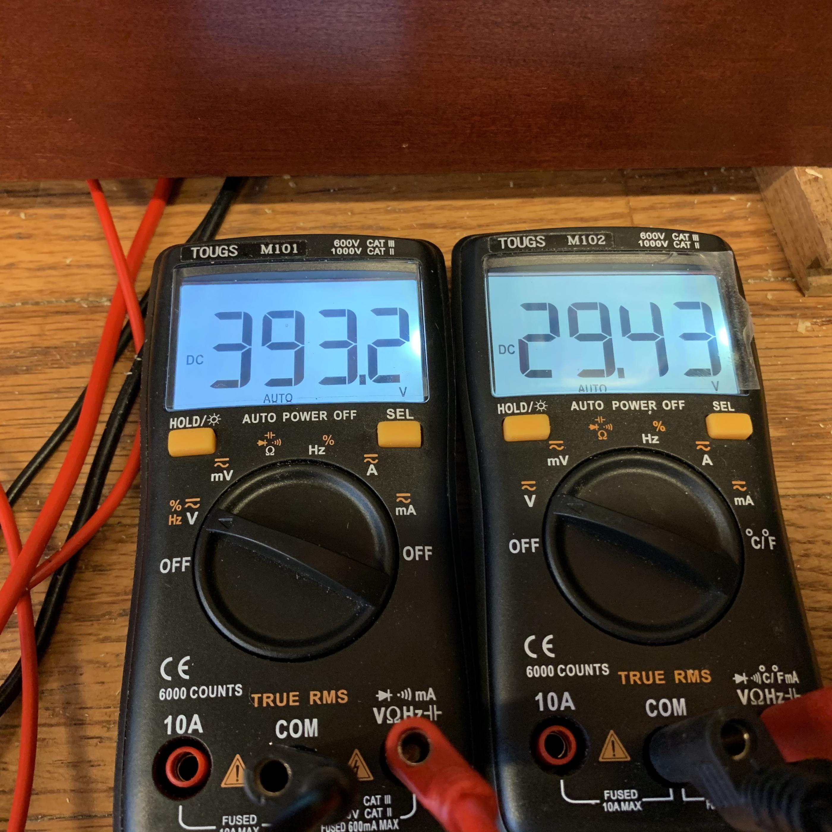

Changed-out the cathode resistors in the shop SSE (additional sockets are for 6AV5 sweep tubes) and fired it up.
~393 B+
29.5 Vk over 344 ohms = 85mA
Assume about 385 Vp * 85mA = 32.7W dissipation
Wow, pretty darned good. Amongst my favs in the 6L6 extended family. Tempted to try them in a guitar amp, which is probably what I bought them for...
Question (this being the TubeLab Forum and all): has anybody discovered the dissipation limits for these puppies?
They’re acting like they would like some more juice. Practically begging to be turned-up to 11.
I see reports of 40 W on the International WW Interweb machine, but rumours only, no details...

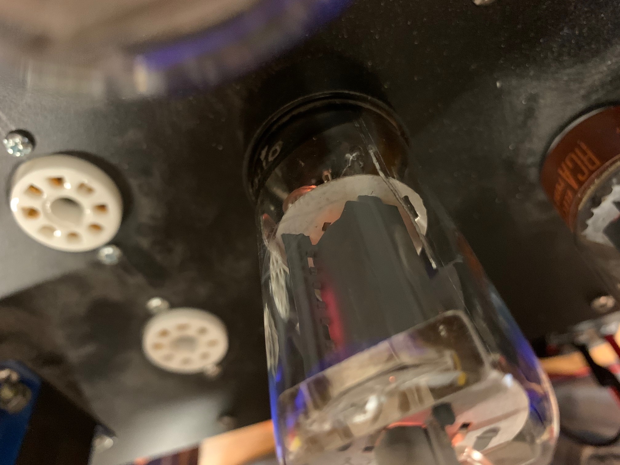

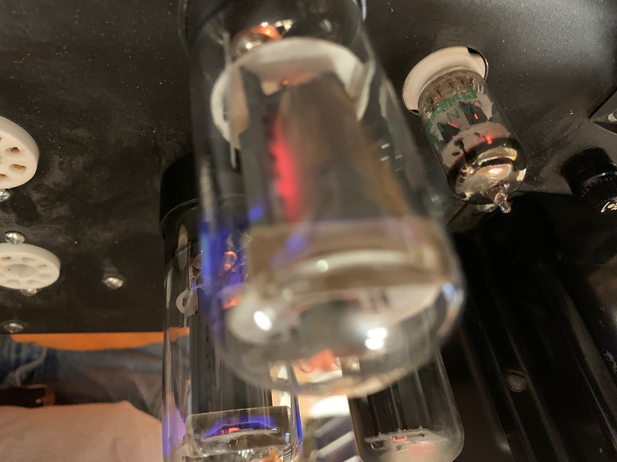

In the spirit of TubeLab: Whatever the dissipation limit is, I went PAST IT...
After a couple of hours of that Rock and Roll Music, I happened to look BEHIND the back 6P3C and saw THIS; mind you, only one tube was showing signs of distress, but Red Plates do NOT a 6L6GC make, let alone a 6550.
But geez, they sure sounded pretty good. Will rebias below 30W tomorrow and see if the second tube will make it...

Re-Calculationn, Re-Baising, and Comparison w/ 5881 Red Base
EDIT!
Arithmetic should be 393-29.5= 363.5 Vp
363.5vdc * 85mA = 30.9 W
Still too high.
I re-biased with 466ohm Rk, which brought dissipation down to 25.5W and 27W. No embarrassing redness yet.

I have a nice (but well used) pair of RCA 5881 Red Base. I popped those in there at same bias points to compare. The RCA were pretty well matched at 24.4 and 24.6W dissipation. For Ultra-linear operation, I figure you can split the difference between pentode max dissipation (23W) and triode max dissipation (26W) = roughly 24.5W, so we're about perfect.
The 6P3S DO compare pretty favorably to this old set of 5881s, although the RCAs are of course smoother, more "lush", more "detailed" (all those audiophile phrases)than the Reflektors.
Which brings up a perennial issue: should you buy well used USA tubes or new Russian/Chinese copies for about the same price? For hi-fi, I think I would lean towards building a cheap stock of USED USA tubes; they're just better, and folks are so focused on NOS tubes that they've lost track of how much life is left in a lot of those old USA tubes... so they're usually pretty cheap.

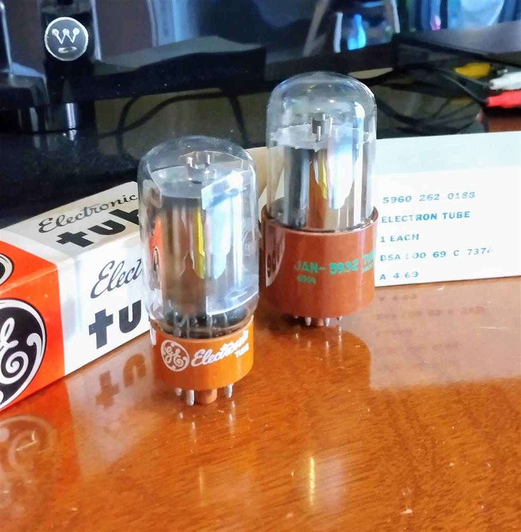

The 5932 is another 5881 / 6L6WGB type with a big fat base. Sometimes expensive, sometimes dirt cheap.
They come in an least two styles - those that look like a 5881 with a fat micanol base, and those that look to have two tubes paralleled in the bottle, also with a big fat micanol base.
No matter what brand is on the 5932, they are likely a Sylvania made tube.
